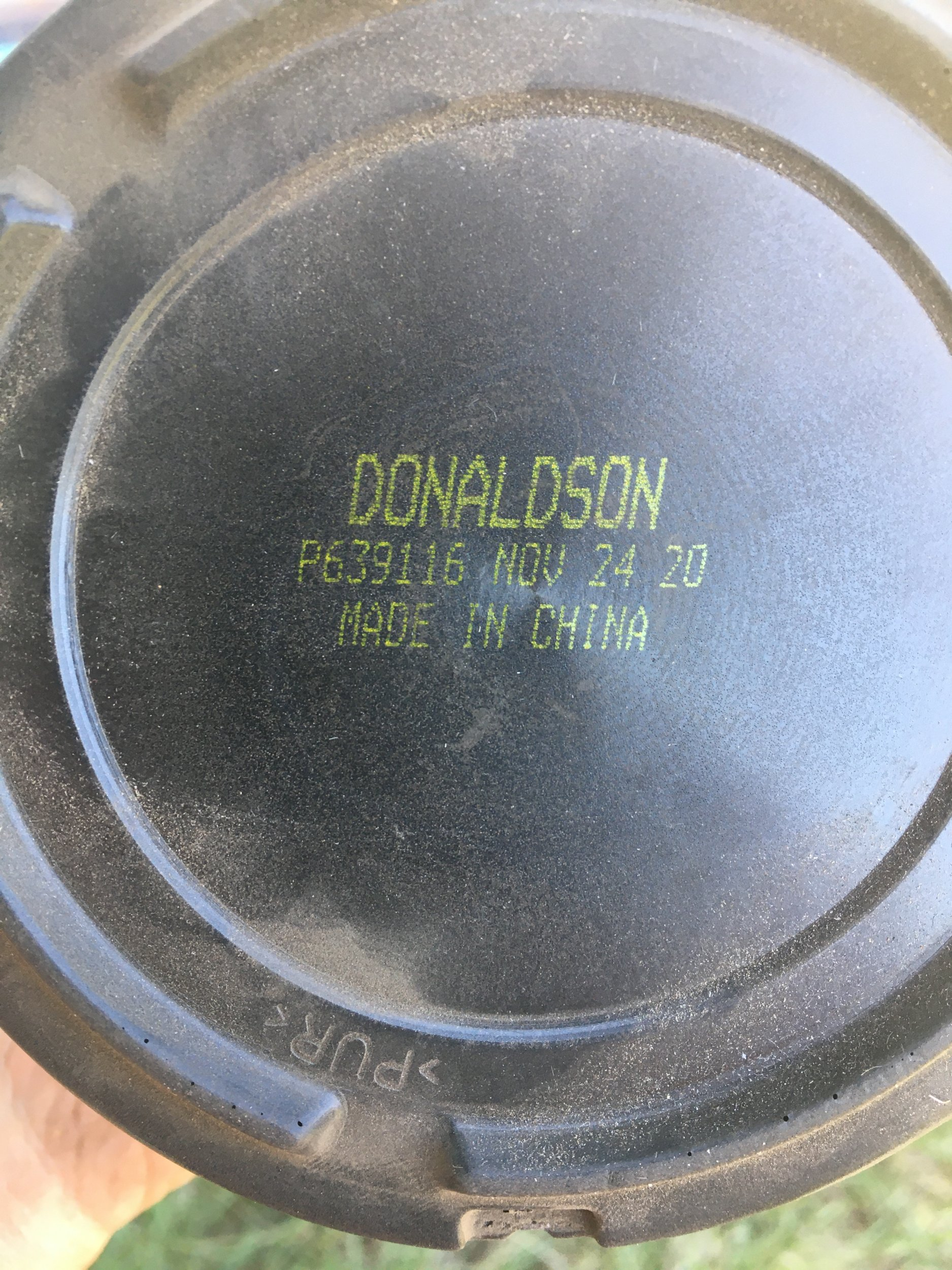

Been reading forum for about a year but first post.
I am going to replace the air filter on my 2021 CK3510 and thought this would be simple.
My current (original) filter has Donaldson P639116 on the closed end. The owners manual calls for Kioti part # E7230-11081 and my dealer said this has been replaced by TC26-1225A.
The issue is the TC26-1225A open end throat size is about a half inch larger than the existing filter so it does not fit tight on the male protrusion in the air box. The filter body itself is also larger in diameter but that isn't an issue.
Also when I search for the Donaldson number online it does not come up.
Anyone else have a 2021 or so CK3510 and experienced this or am I just lucky?
Thanks,
Kevin
Try a Wix 46489. My 2610 HST CAB has a 100.5 c.i. motor, I think yours is the same with the fuel control turned up.
