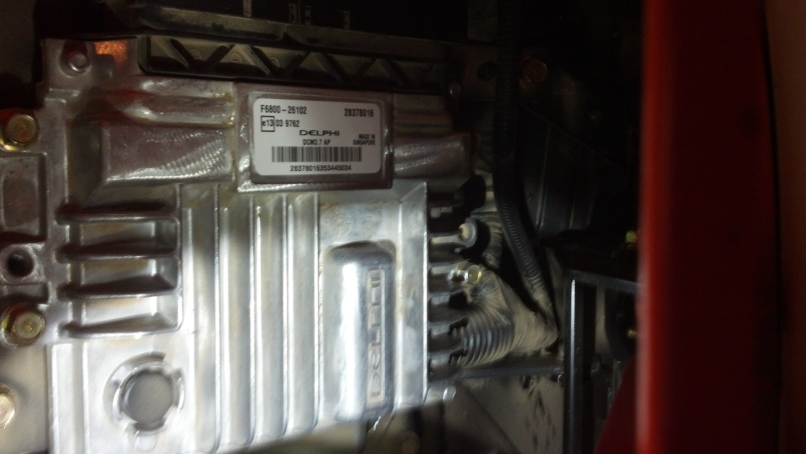

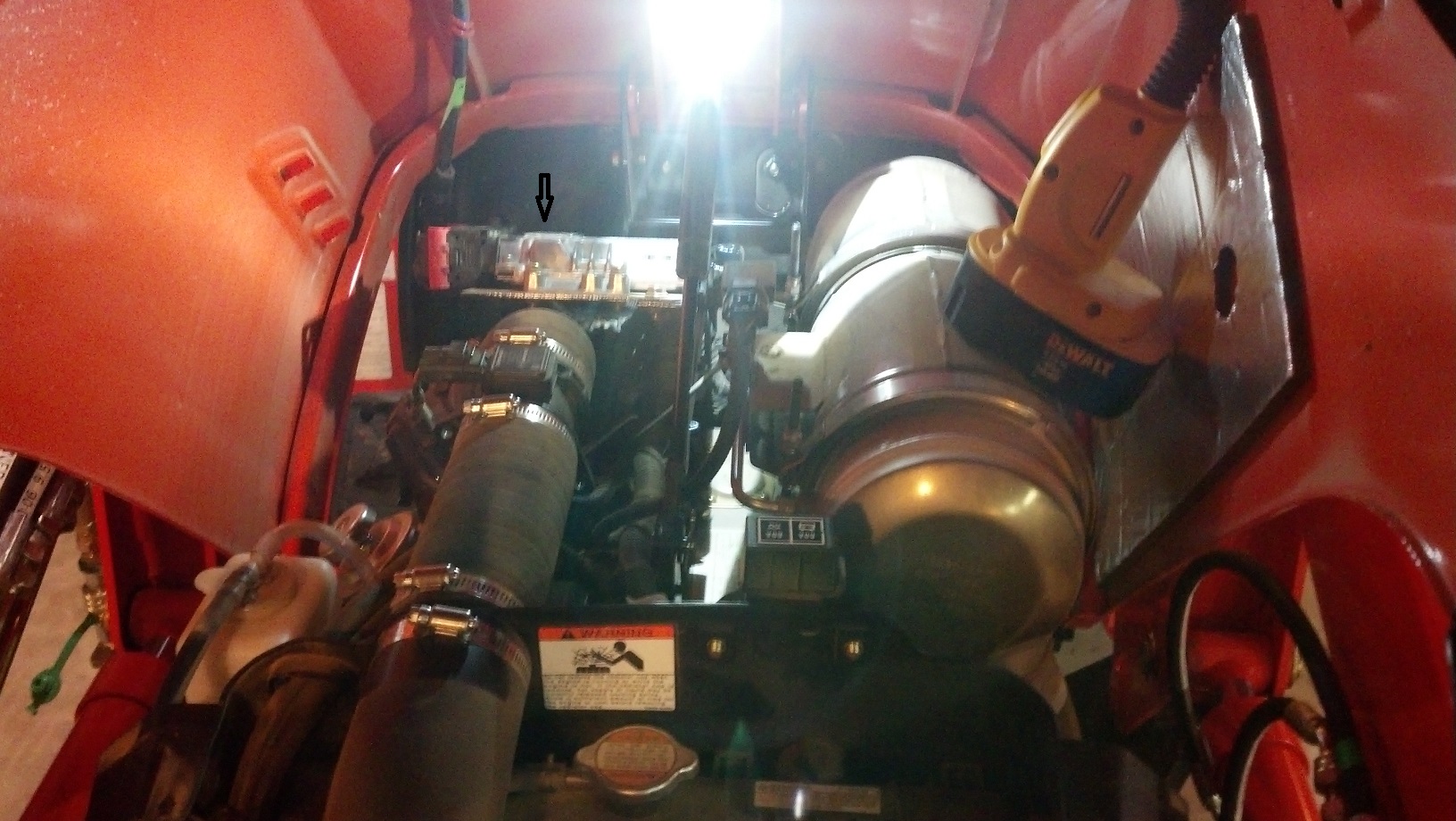

For the ck3510HST, Isn't it located on top of the engine, mounted on a bracket? Made by Delphi, pn# F8600-26102
From Paige Tractors
Delphi DCM Light Duty Diesel Engine Controller Series

The part I listed was for a ck35. I don't know what the ck40 part number is. If someone has the ck40 maybe they can provide a pic of their controller or just provide the numbers shown on the label. It could be the same base controller (FPGA) but programmed differently. It might be possible to reprogram a ck35 controller with the ck40 program but you would obviously need the ck40 specific program and the utility program that loads it.
