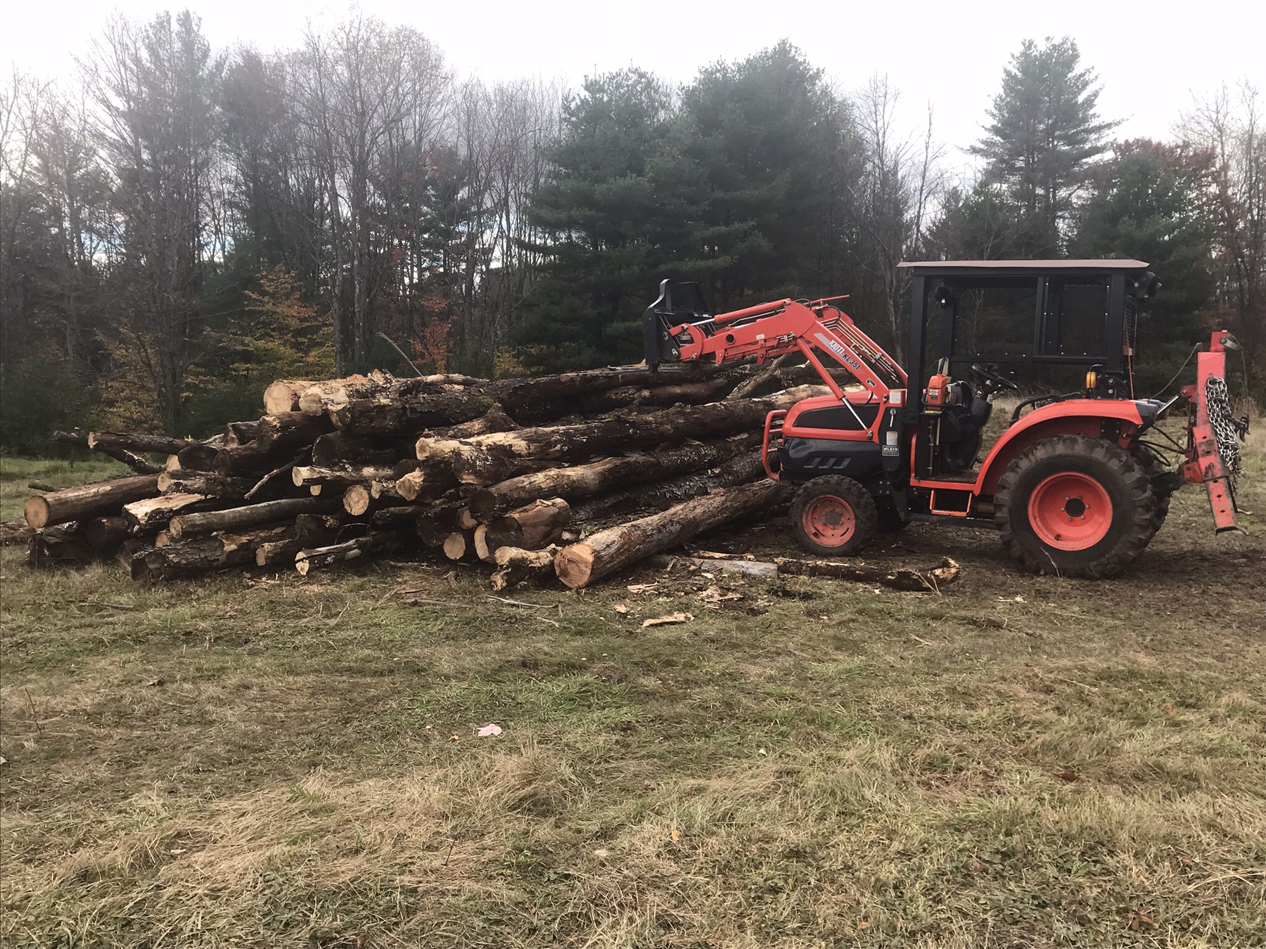

I have a DK35SE , I do not have either and have never felt I needed one. It gets down to -40f in the winter where I live. Kioti starts as good as my Chevy 2500hd gasser.
My garage is a steel pole barn with a thermometer it will read -35f inside and -40f out. The proper engine oil and fuel treatment. I have 2 - 150 gallon tanks in the garage which are filled in the summer. I run power service and diesel 911 year round. Never had a problem starts first time, every time. IMG_2118.JPG
