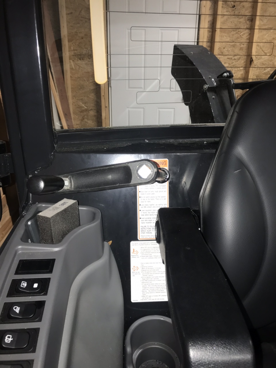

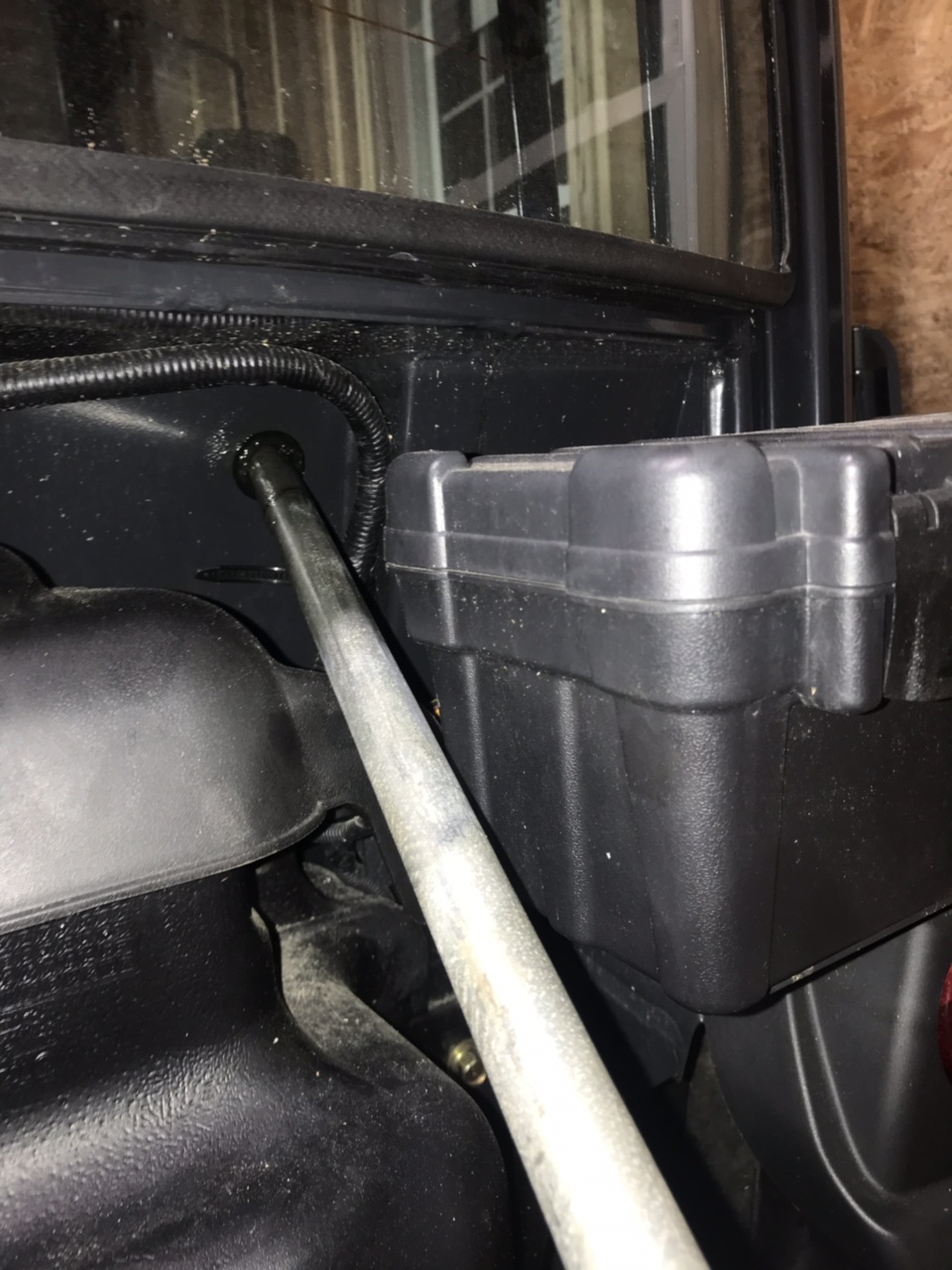

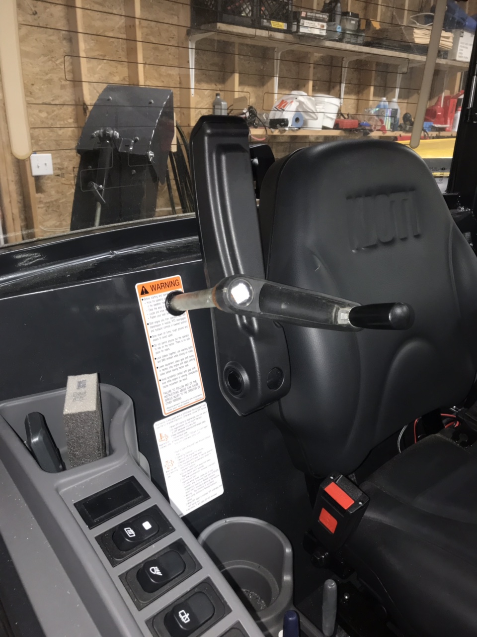

Also to the OP, i have the same snowblower! Great unit. I drilled a 1” hole into the cab and threw a grommet in, sent the manual crank through. I can send a pic or two if you want.

Haha yeah. I figured there was an easier and cheaper way to make it work. Plus i think their manual design is actually really great. Ill snap some pics at some point today and post em up.
   / CK3510CHSE Parking Brake Switch #14
Now putting it where it put it, the crank has full range when blower is up or down, but the only downside is that the armrest has to be up lol.
I used a 1” holesaw and a 1” grommet from this kit 180 Piece Rubber Grommet Kit Assortment - Heavy-Duty Pieces In Different Sizes - For Car Repair, RV Wiring Jobs, Restorations, Boats, Wires, Cables, And Firewall - By Katzco https://www.amazon.com/dp/B01BGZ9WVU/ref=cm_sw_r_cp_api_i_ckdgCbRCV9F5P
You will need to drill out the hole in the grommet to get the shaft through. I used a half inch drill bit and just worked it around. Then lube it up with fluid film and youre off to the races!
Hope it works out for ya!

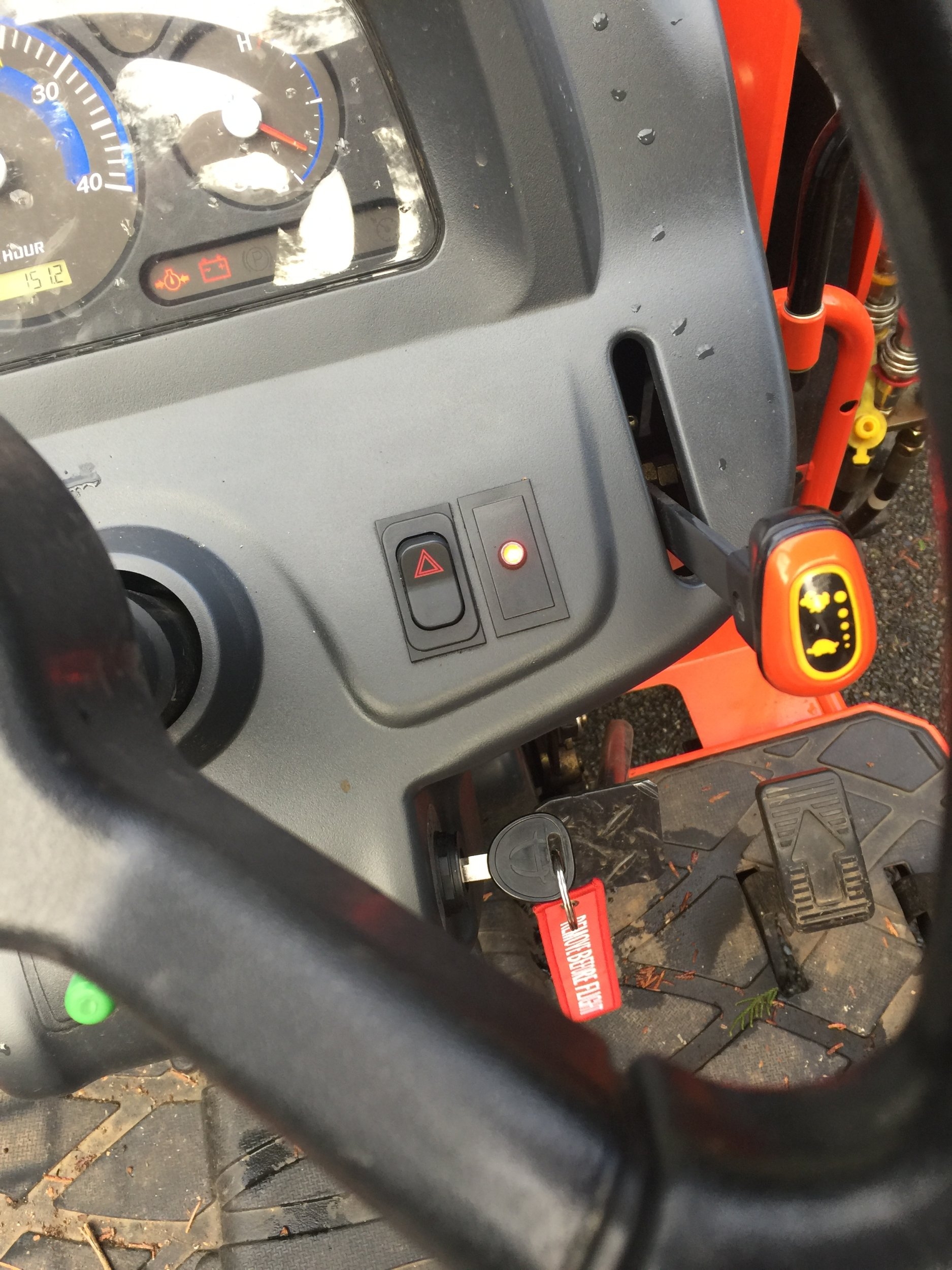

I'd like to revisit this subject. The brake light switch failed on my 2017 so while I'm replacing it I'd like to see if adding a switch to utilize the parking brake light on the gauge cluster is feasible. Has anyone done this? How hard is it? What parts are needed? Thank you.
   / CK3510CHSE Parking Brake Switch #18
I’ve never seen anyone post on making the connection you reference to the instrument panel brake light symbol. Someone did post where they had installed a limit switch for the parking brake lever, which seems like the correct way to go.
I was going to go down the limit switch path, but then thought about how I use this tractor. My property is flat too, making brake use minimal. I’ve never owned a HST before, but this thing stops extremely fast once the accelerator is released, so I really only use the brake pedal to set the parking brake. I don’t drive on the road either, so I skipped the limit switch and just wired the LED to my brake switch. Why I didn’t figure how to tap the wire harness to the tail lights escapes me now.
The photo reduces the brightness of the red LED. If I did it again, I would consider buying one of the panel mount flashing light LED’s I see they make. As brain dead as I am anymore, I need all the help I can get!
For what it’s worth, Toukow
   / CK3510CHSE Parking Brake Switch #19
Thank you. I had to replace the brake switch and thought while I had everything apart I could connect or install a switch to get the parking brake light on the dash to work. I think it's unfortunate that it wasn't included from the factory. I guess I'll have to do without.
