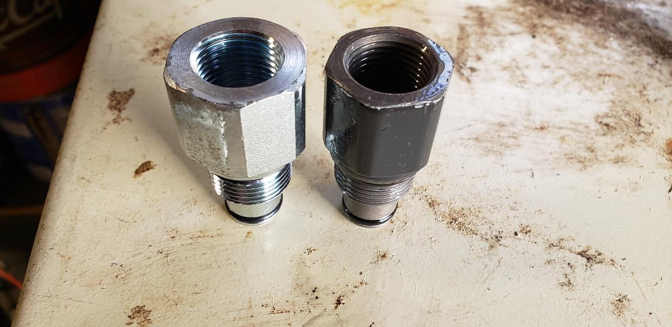

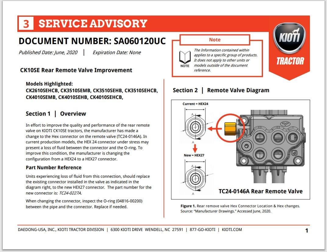

2017-2019 SE models have a dealer notice for this. Mine had it. Replacing oring probably won’t keep it from happening again if this is your issue. (New fitting left, original on right)
Interesting. Sure does look like I probably have the older one. I made it 550 hours before this, so for right now I'm just gonna get the o-rings, so I can finish up my mowing for this year. I can try to order the new part over the winter. Oddly though, I put that part # into MIE's part finder, and it yielded no results.

It looks like the older fitting doesn't have that flat o-ring mating surface machined. I would think you could remove the original fitting and sand a flat on it with a piece of sandpaper on the workbench. Like you would flatten a small engine cylinder head. At least it would take out any imperfections which could cause a leak.
My dealer said it had to do with the size of the fitting doing s better job of fully encapsulating the oring. I let him handle it under warranty so I can’t say for sure
