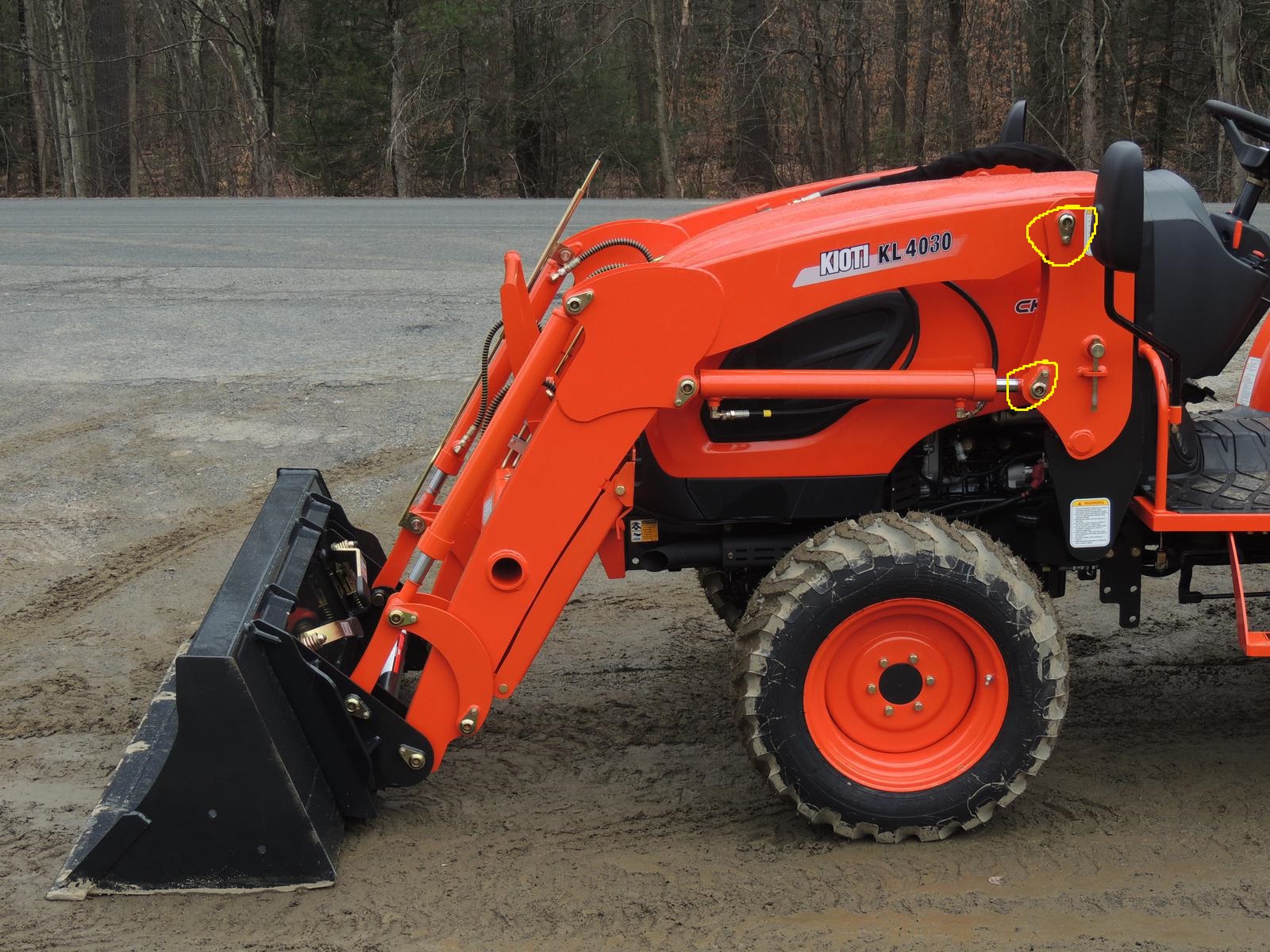

Not my picture, just grabbed it off google to show the problem bolts. They're the short bolts that hold the little teardrop shaped plates on. I noticed it because one of them came completely out, and the teardrop plate had spun 180 degrees, and grease was everywhere. I checked them all, and the 2 circled were loose on both sides, none of the others were. Seems strange that the same ones backed out on both sides....am I using the loader improperly in some way to cause it?

It is a common problem. take out bolts. Clean bolt and hole with some good solvent. You are looking to get the hole threads and bolts clean and dry. They will be very greasy. Put on red locktite on bolt. Put it back in with the appropriate torque. Re-grease the zerk/joint. You are done.

Thanks, I was planning on locktite, just wanted to check and make sure I wasn't doing something to cause them to keep backing out.

Nope, I have had several back out until I locktited them in. They were grease covered in the threads.
