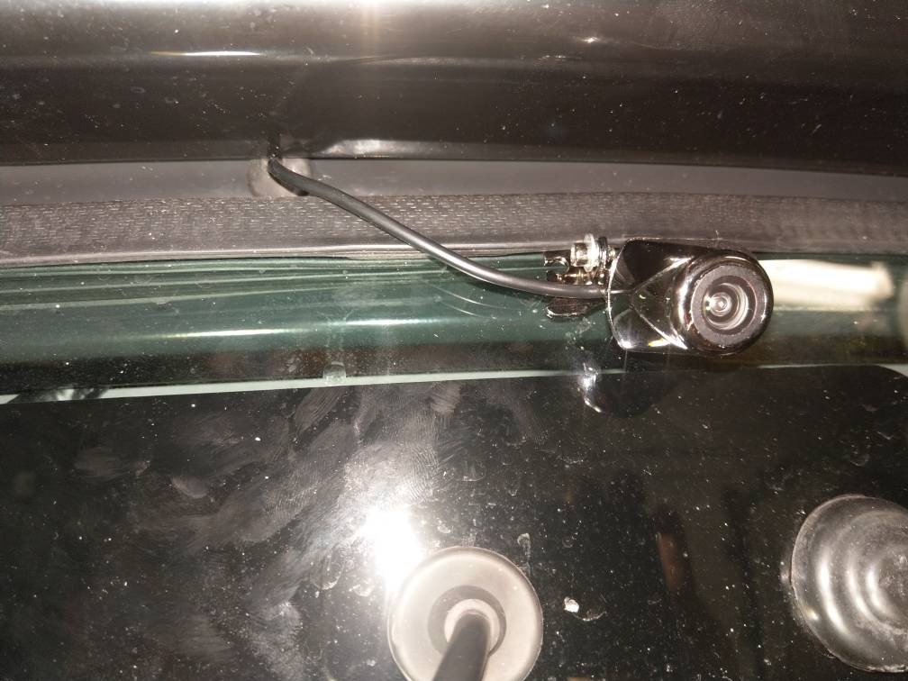

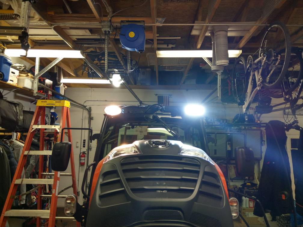

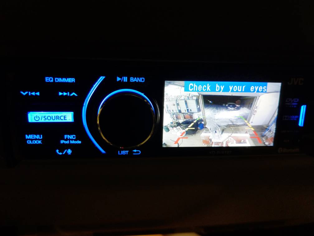

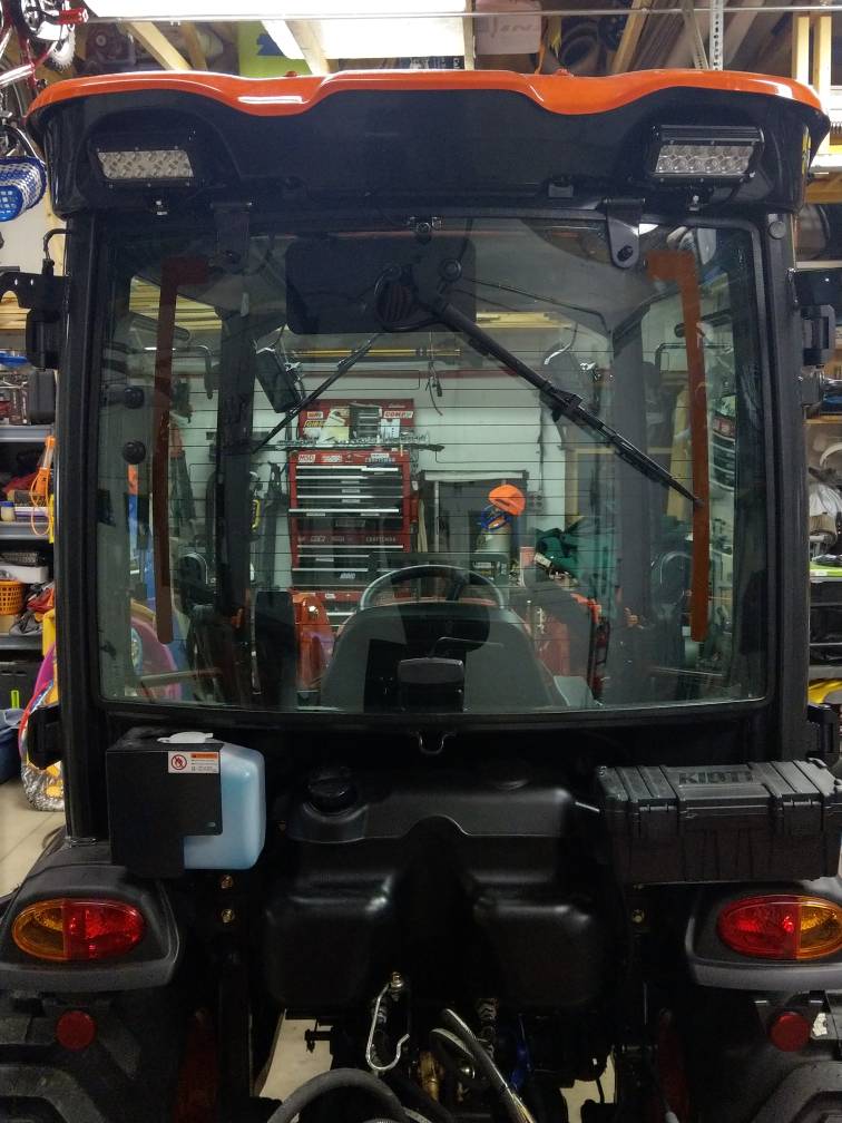

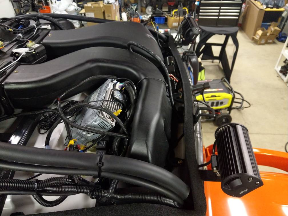

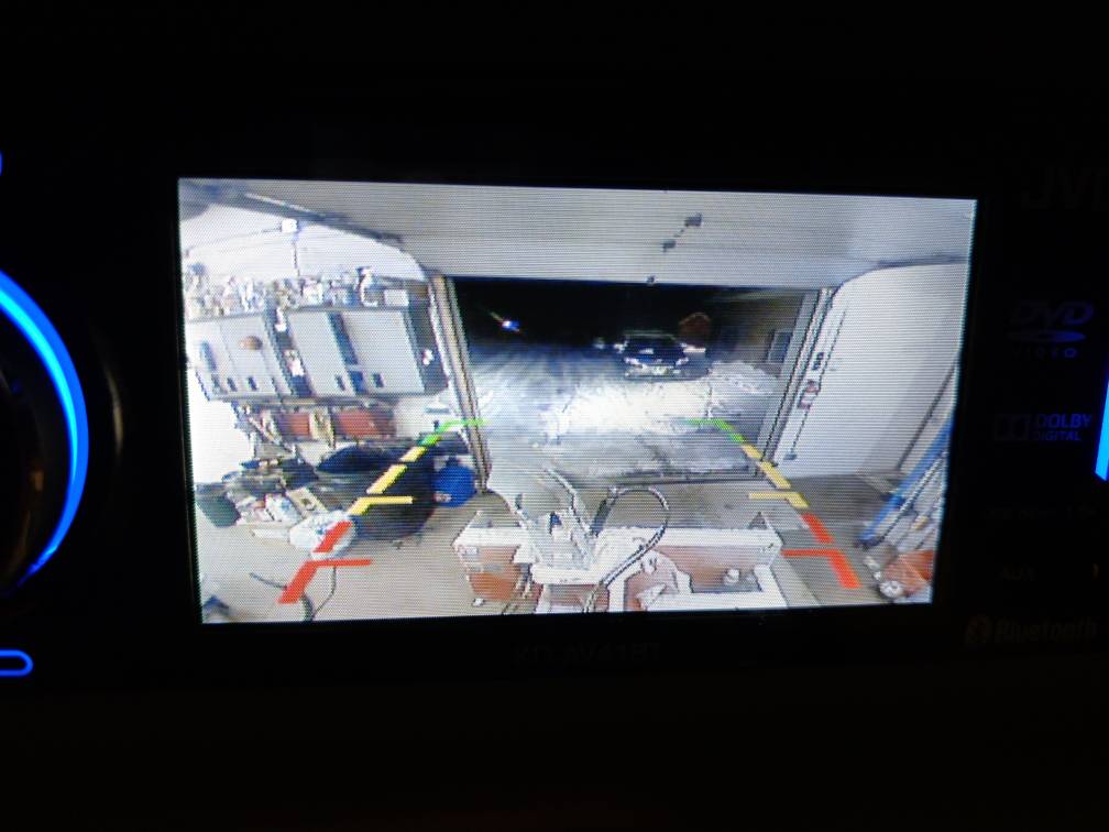

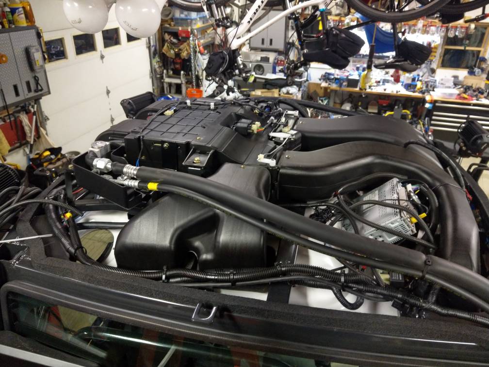

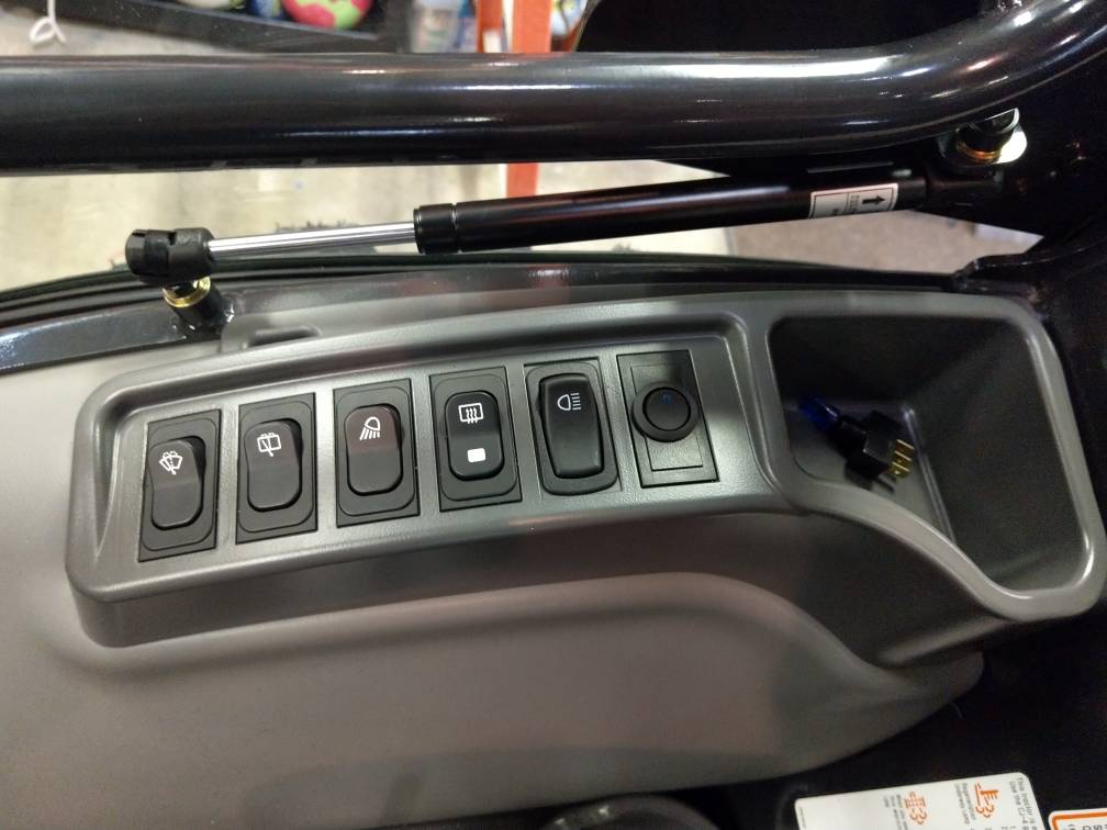

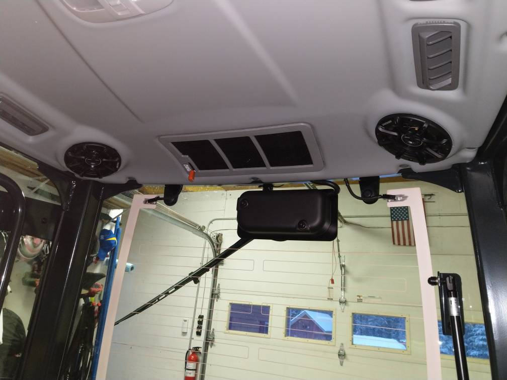

Finished wiring, seperated front and rear work lights by adding relay, new speakers, added rear view camera and a switch to turn it on and off IMAG1318.jpgIMAG1326.jpgIMAG1320.jpg .... IMAG1323.jpgIMAG1324.jpgIMAG1330.jpgIMAG1331.jpg

The tractor uses a Metra 70-7712 harness for the radio, is that correct?
EDIT: Lol clearly I need to look at *all* the pictures. :ashamed:

Thanks. Was the harness color correct for you? I.E. yellow for battery, red for ignition, black for ground, etc. For some reason I have no constant power at the connector but there are no blown fuses from what I can tell.
Edit: Well I can see from your photo that you just matched up the colors, so I gotta figure out why I'm not getting battery power on the yellow wire.
Lack of constant power may be caused by a corroded pin in the harness under the tractor near the cab step. Water gets in the connection and won’t drain because of the orientation of the connector, causing galvanic corrosion of the constant power pin.
