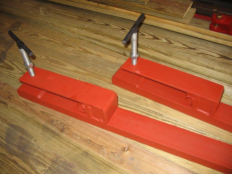

Here is one of the latest creations from the shop of MadReferee. This was made for another TBN'er.
These are clamp-on bucket forks. The actual fork is 36" long and extends under the bucket by another 13". The nice thing about this design is that it fits over a bucket toothbar frame so you do not have to remove the toothbar to use the forks.
The forks are made from 3" x 1.5" x 3/16" bar channel and the top plate from 3" x 3/8" flat bar.
This project is easy enough so that a beginner at welding can make it with no problems.
I will make available a materials cut list and design sheet in a week or so for those who may want to build it yourself.

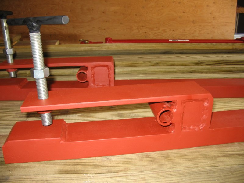

Here is picture #2.

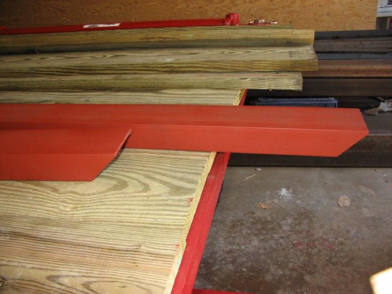

Here is picture #3.

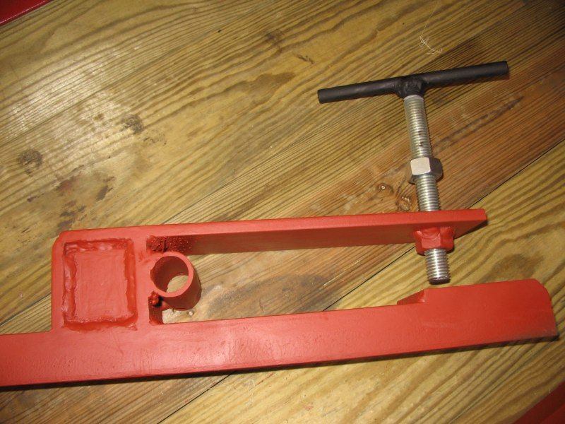

Here is picture #4.

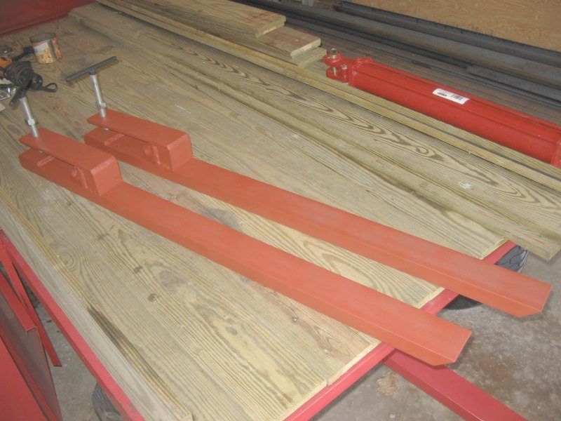

Here is the last picture, #5.

Nice work. What do you figure the load capacity to be?
   / Clamp-on bucket forks
</font><font color="blue" class="small">( Nice work. What do you figure the load capacity to be? )</font>
I would guess at least 1000 lbs and probably much more. Clearly more than a small CUT's bucket will hold/lift. That bar channel is real strong stuff (the inside corners are webbed) and I think the bucket will deform/bend before the forks will.
