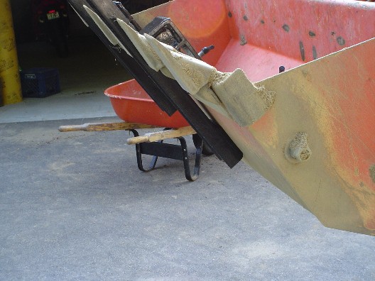

One of the big advantages to these is they are designed to work without removing the toothbar. Last one shows how they clamp from underneath.

Great set of forks!
Do you think the toothbar is needed for how it adds strength to the bucket's leading edge?
I wanted to make something like this for my woods bucket but am fearful the bucket will deform under a load.
Any thoughts on this anyone?
Also, I saw somewhere something like this but it also had an additional vertical component ('L') that allowed you to pass some of the load to a chain wrapped around the back of the bucket. Now I wonder if this design is simpler and has the bonus of being another justification for a toothbar.. /forums/images/graemlins/smile.gif
Looking for steel now... I will try this soon!!

</font><font color="blue" class="small">( Do you think the toothbar is needed for how it adds strength to the bucket's leading edge?)</font>
No. The toothbar is there to help you dig not to provide bucket support. If you are worried about the strength of your bucket then you had better start looking for a different bucket. A bucket without a toothbar will not dig in any kind of firm soil.
This subject has been discussed zillions of times already. Use the search function with "toothbar" and you can read for hours on end.
</font><font color="blue" class="small">( I wanted to make something like this for my woods bucket but am fearful the bucket will deform under a load.)</font>
If you don't overload your bucket forks your bucket will not deform. Most small CUTs have a bucket capacity of less than 1000 lbs. Your 3430 has a capacity of around 1400 lbs or less at the forks. Use common sense and you will have no problems.
</font><font color="blue" class="small">( Also, I saw somewhere something like this but it also had an additional vertical component ('L') that allowed you to pass some of the load to a chain wrapped around the back of the bucket.)</font>
A roll stop can easily be added to this design. My next build will have one.
</font><font color="blue" class="small">( Now I wonder if this design is simpler and has the bonus of being another justification for a toothbar.)</font>
I fail to see how adding clamp-on forks can be justification for purchasing a toothbar. They are two different animals that serve two different purposes. /forums/images/graemlins/confused.gif /forums/images/graemlins/confused.gif
