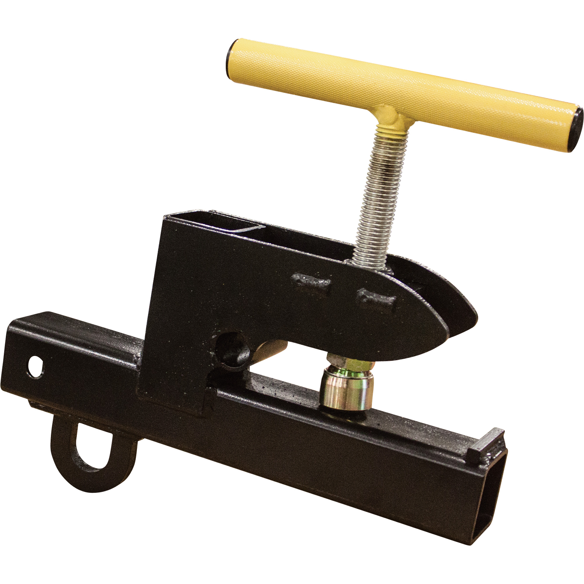

You certainly saved a few $$ by making your own. I've had pretty good luck with this one from Northern Tool:
Load-Quip 2in. Class 3 Hitch Receiver Clamp with Lift Ring, Model# 29211766 | Northern Tool + Equipment
I put a piece of 3/8" angle iron in the bucket before clamping. The length of the angle needs to match the width of the bucket. I drilled a partial hole in the angle to fit the tip of the clamp bolt. This reduces the side to side shift and also prevents distortion of the bucket cutting edge when lifting trailers with a heavy tongue weight.

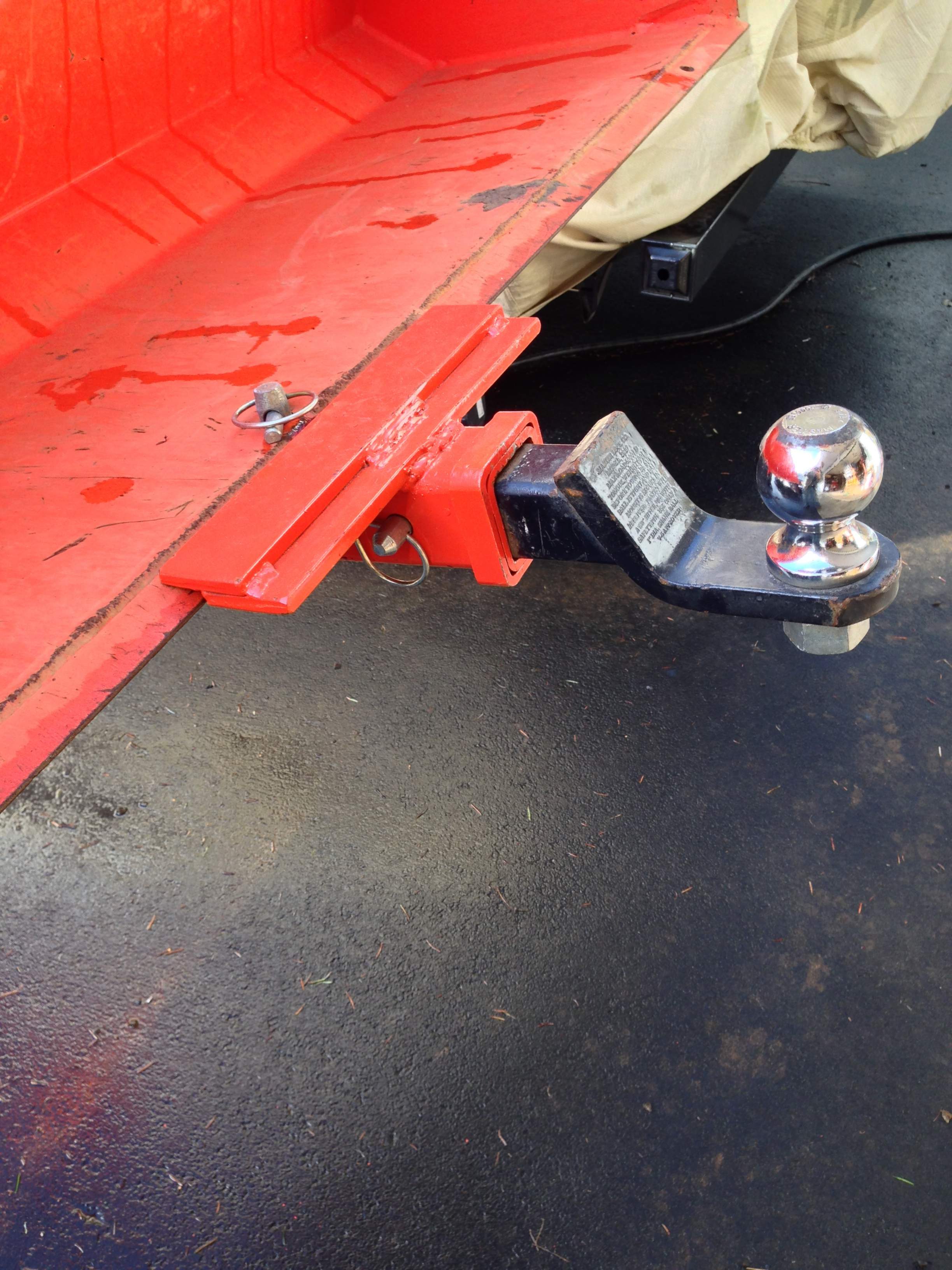

   / Clamp on Bucket Hitch Receiver 2" #15
I built this years ago for my tractor. It's served me well. Easy to attach, no tools needed, spreads the weight a little (preventing damage to the bucket). Hardest part of the entire job was drilling a 3/4" hole near the edge. Welding only required attaching two layers of offset pieces of steel weld to receiver tube.
