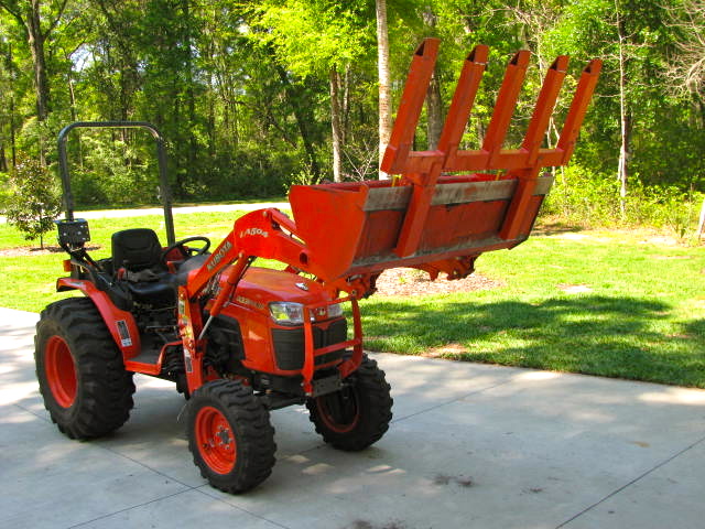

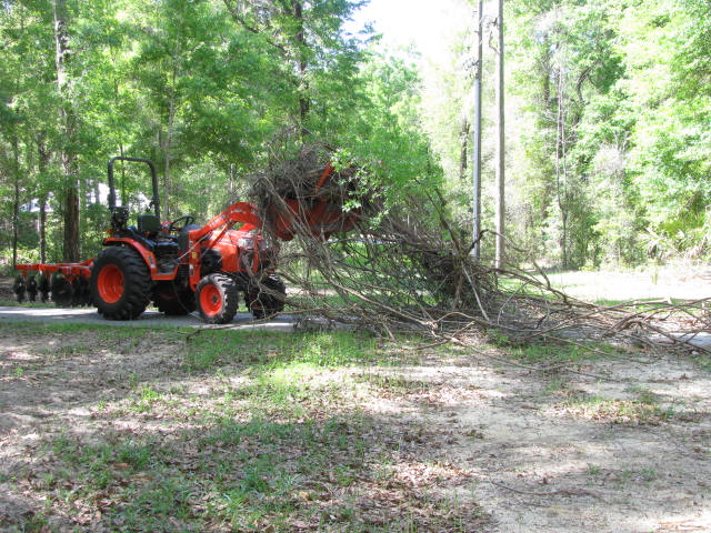

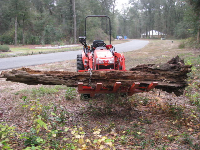

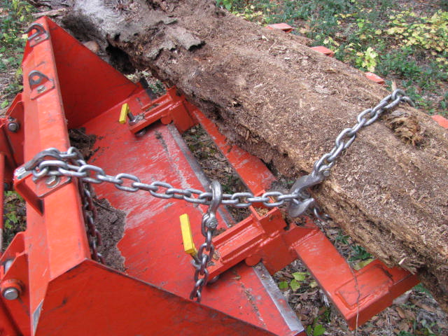

Forks: Pallet forks or Debris forks? Most people buy steel which is less expensive but heavy, (120 lbs.) reducing your lift capacity on every load. Personally, I have spent more for Payne's aluminum forks (55 lbs) to retain lift capacity. I have the Kubota standard LA504 on the Kubota B3300SU. Often enough I want every pound of lift capacity available.
Before lifting a heavy load with forks be sure to have ballast on the 3-Pt. I use an implement. Weight BEHIND the rear axle reduces strain on the front axle. With CUTS you always want to consider how to reduce strain on the tractor components. Loaded tires do NOT reduce front axle strain.
Also, you do not want your rear wheels to lift off the ground when you try to raise your bucket. This can happen on only a minor slope when your intended load is down hill from your bucket. Safety, think safety!

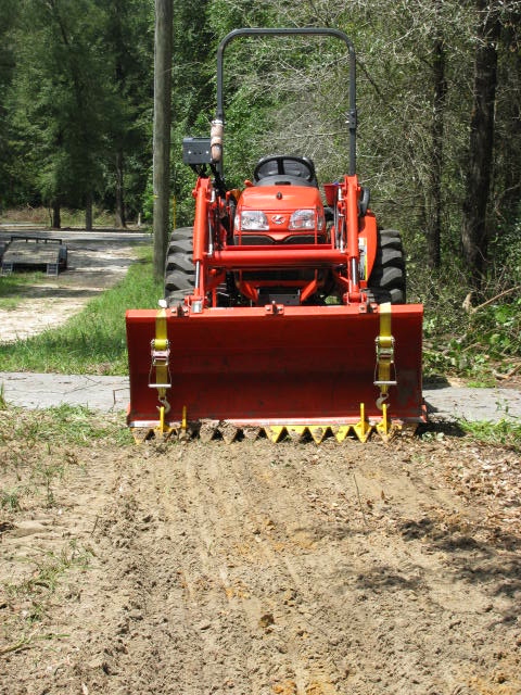

Tooth Bar: Are you going to dig tractor width with your FEL? If so, a tooth bar is the way to go. I have no experience with tooth bars.

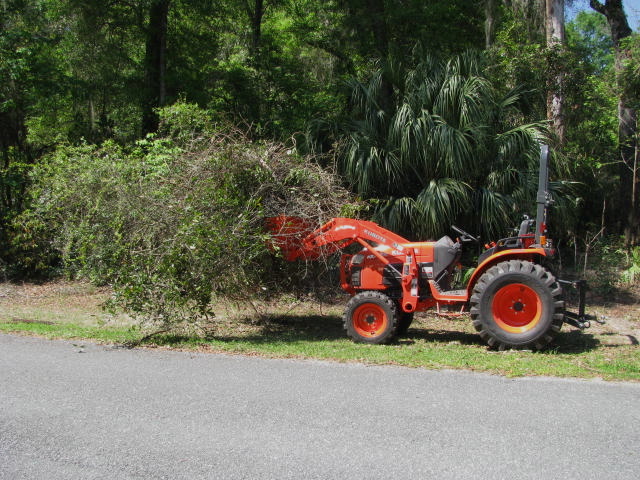

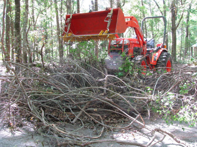

A Ratchet Rake is a more versatile bucket attachment, in my opinion. Your can scrape out dirt with it to a limited extent but not really dig. For tearing out vegetation, above and below ground, then piling it up for your forks RR is the greatest. It does well at minor grading chores too. RR is easy on/off. For this type of work steel is an advantage.
Buy quality in your attachments.

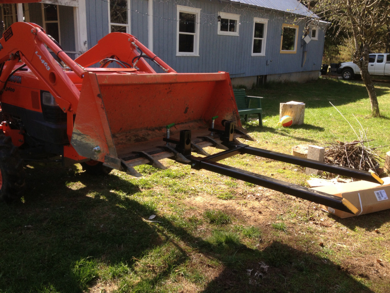

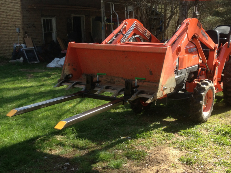

I am happy with my improvements. Both were purchased through Ebay, free shipping and more economical than I could source locally or elsewhere online. I have played around with them and they do the job and the forks fit over the toothbar. Time will tell but, I give my endorsement.

Cant say much about pallet forks, other than they wont lift much with the LA463 in a clamp on fashion. The load moves too far out. I have a set that I made. But I dont really use them as "pallet" forks cause of the very limited capacity. But If I have to move things like lumber, rail road ties, culvert, etc...they are great.
As to the forks...I dodnt want to spend the money on a toothbar. So for about a quarter of the cost, I just bought bolt on teeth for the bucket. They work well, and you can still back-drag with the heel of the bucket to smooth things since they dont remove easily. But it is just another option for you if you dont think you would ever remove the toothbar. 8 teeth were about $70 or so delivered.
