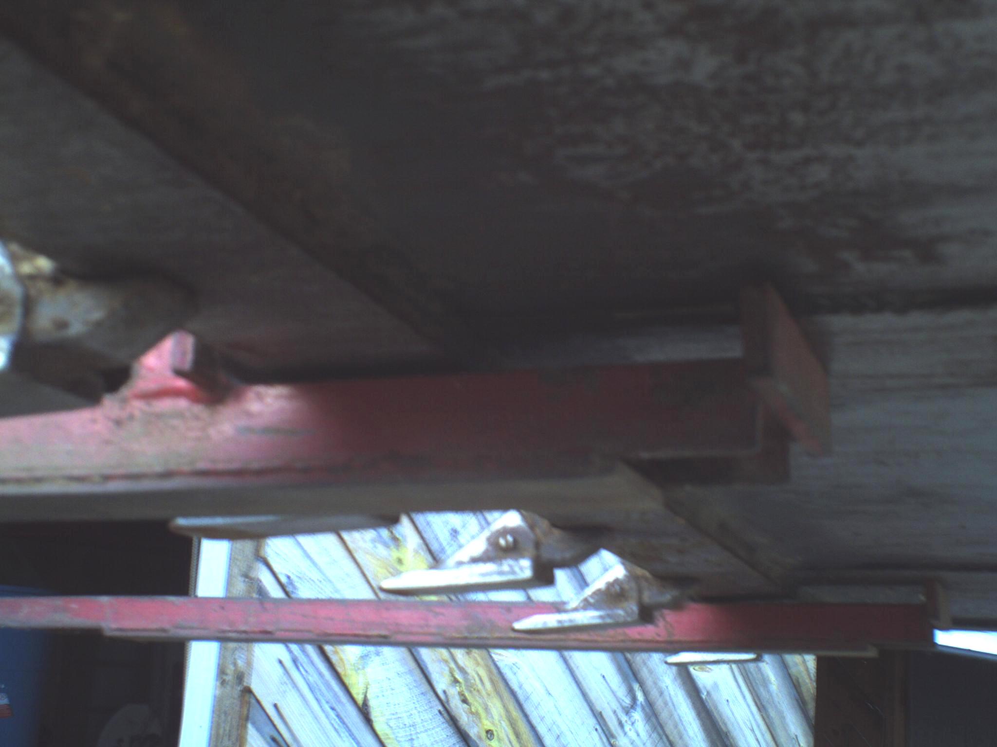

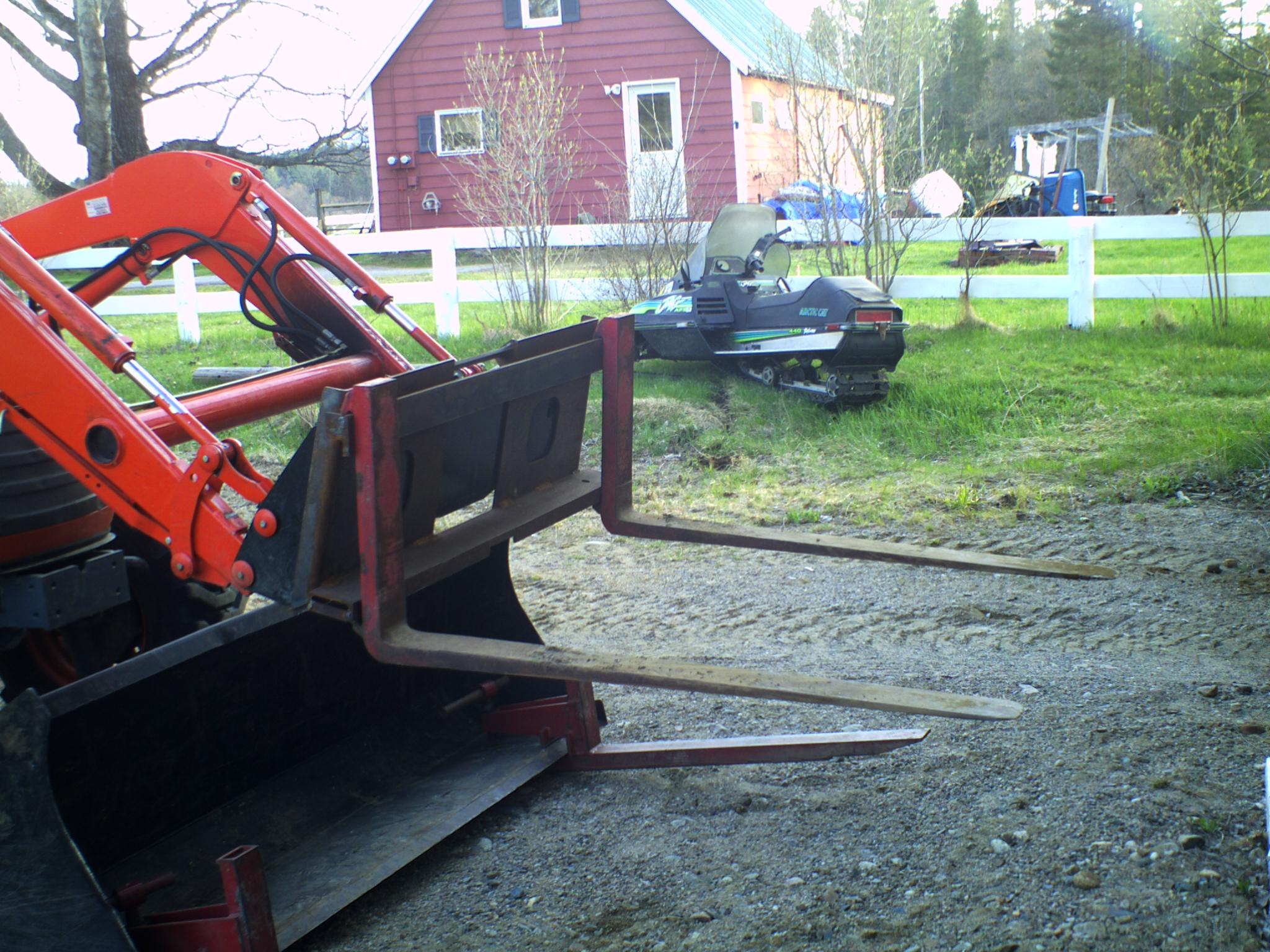

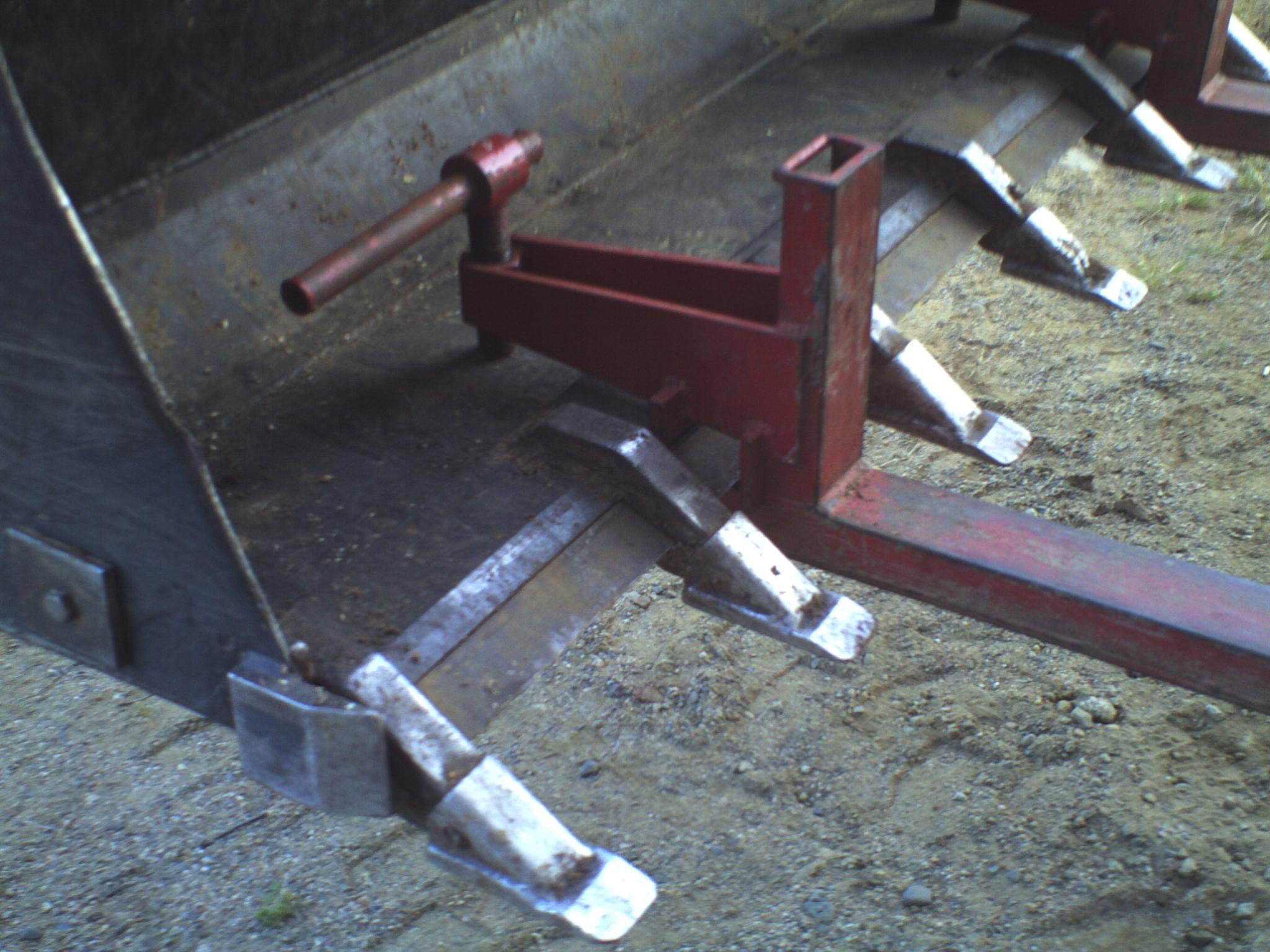

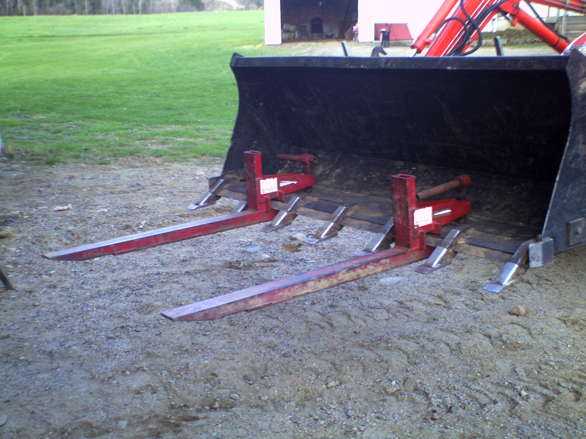

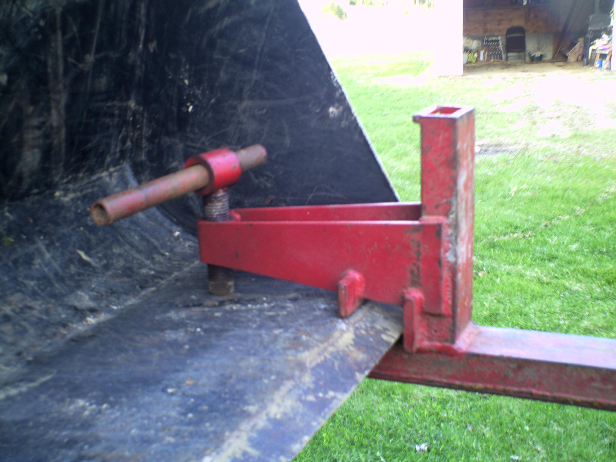

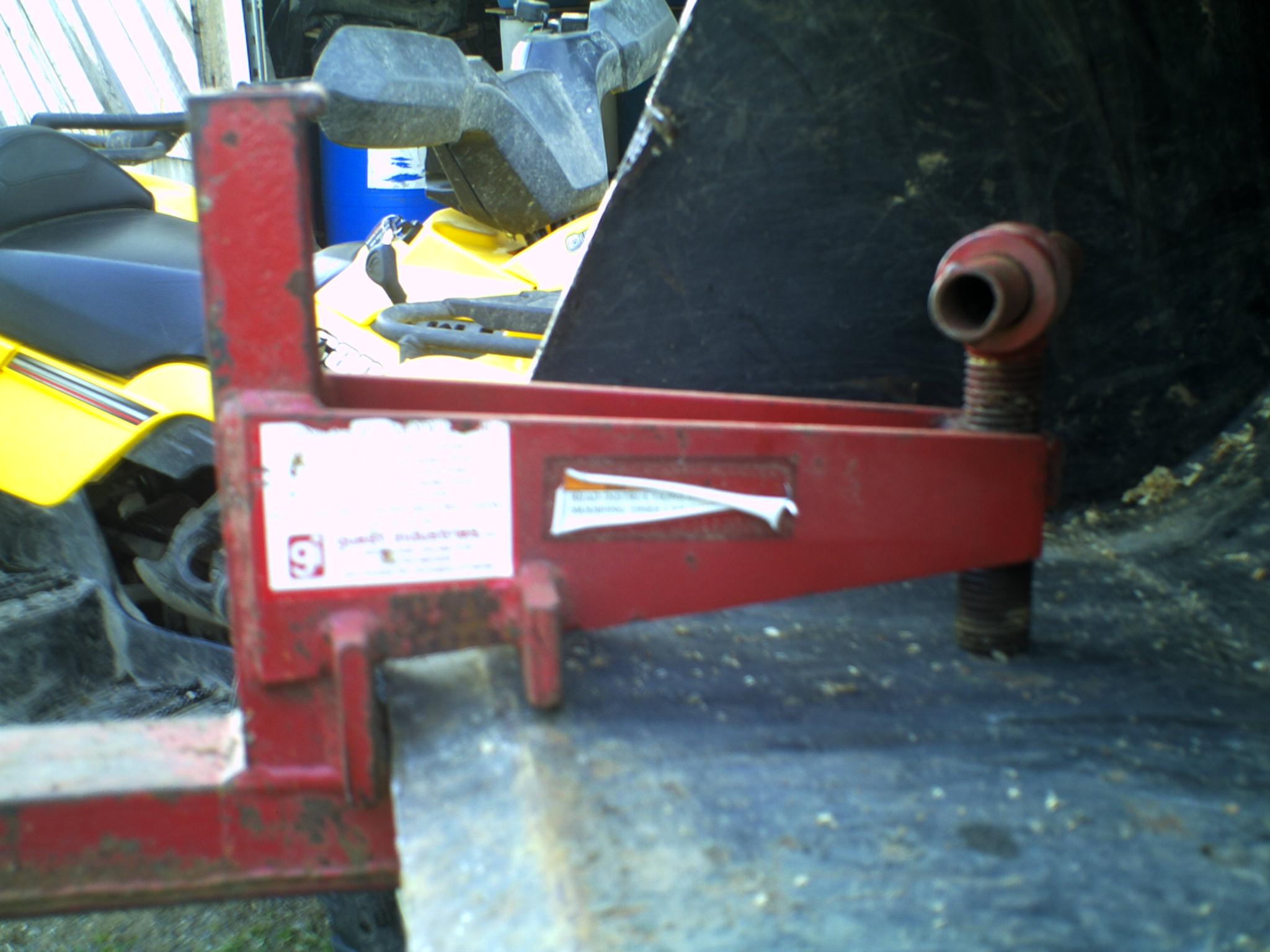

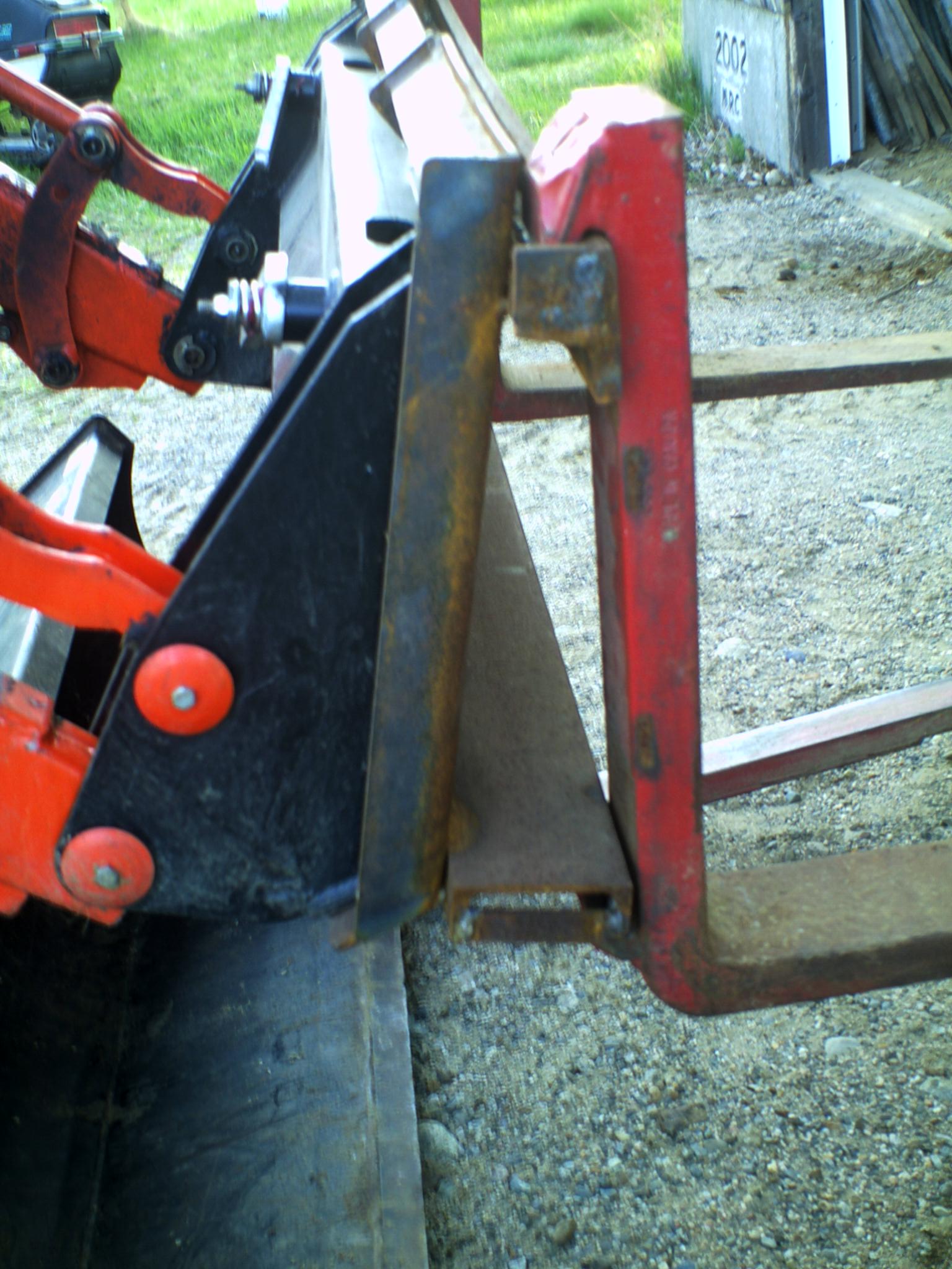

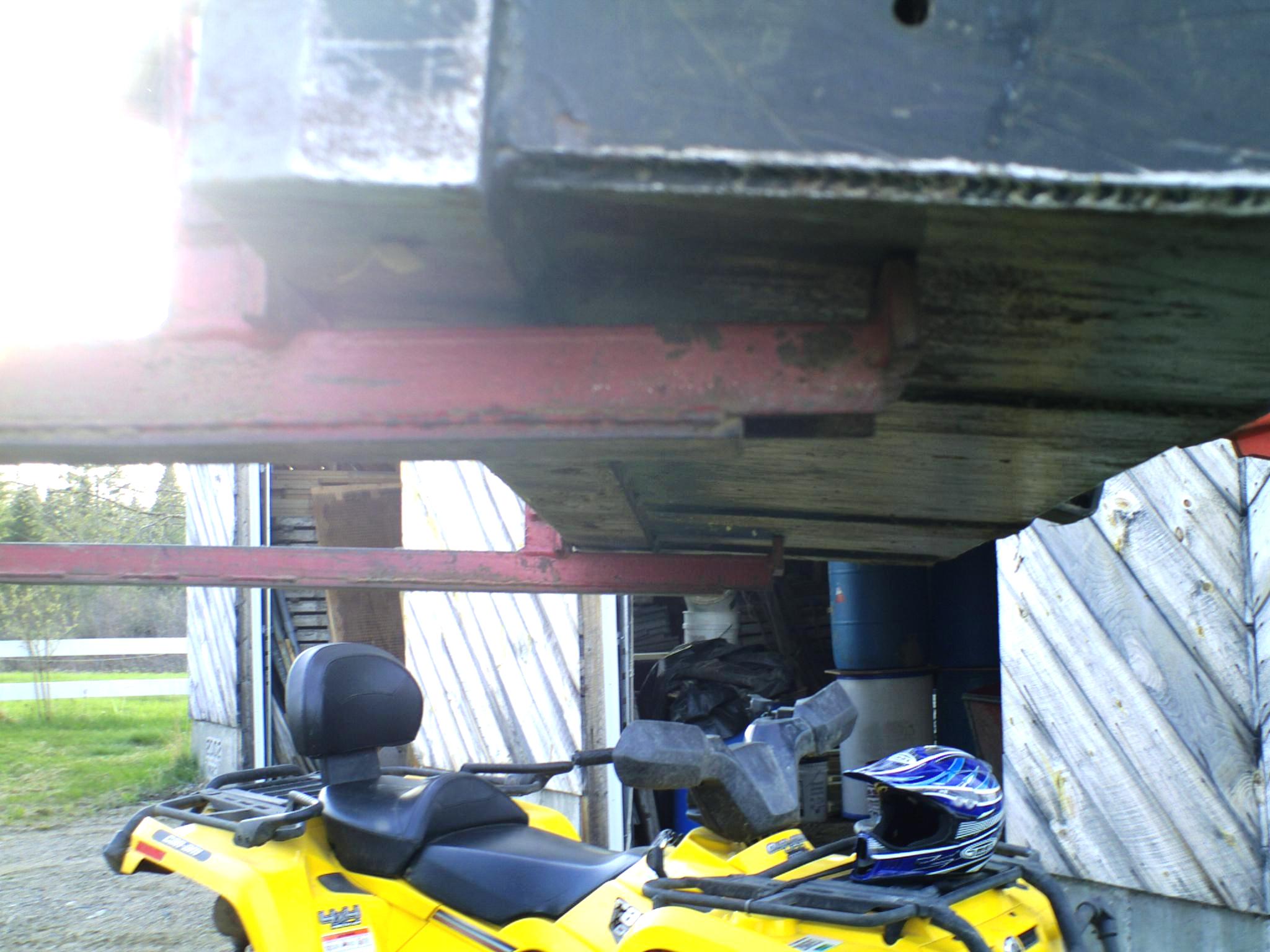

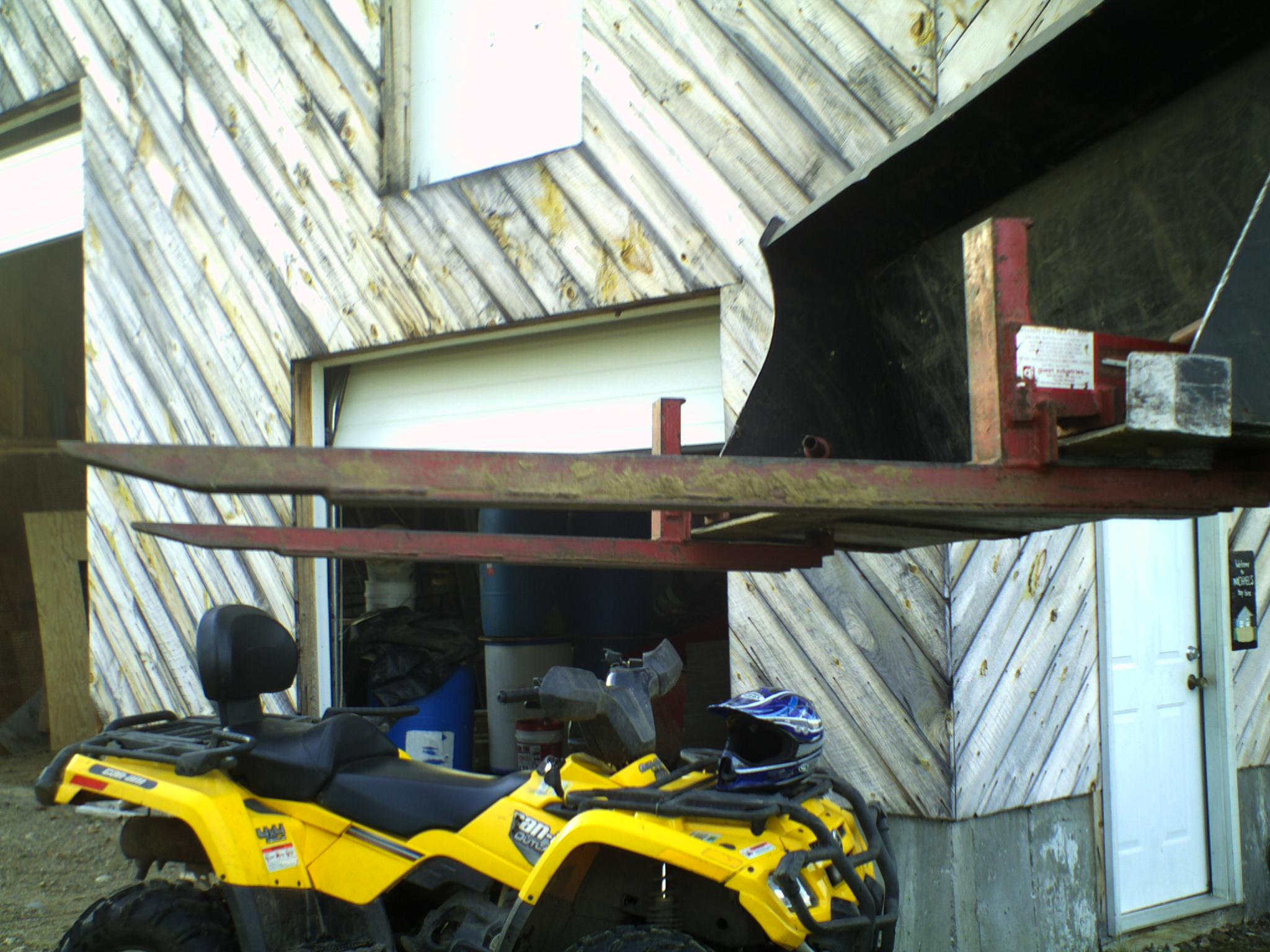

Nearly a month ago kilgore101 asked about my clamp-on bucket forks. They are made by the Guest Industries of Torrington Ct. Their website is currently unavailable ???? Anyway, they're rated 2000lbs spread over both forks at the midpoint of the fork length. Have used them on three tractors, the third with & without toothbar attached. Pics on Kioti without toothbar, with toothbar, & newly built quicktach forks. Poor picture quality due to my crappy camera. I would fine tune the forks, ie weld in some metal to improve the fit if only used on one tractor but the work well as is.

Those clamp on forks look similar to the ones I've got for my tractor...
I tried to use them the other day and wound up bending my bucket... it bent back during usage though so I guess it's good... but I'm wondering if my bucket comes off as easily as yours. I'm thinking it won't.
