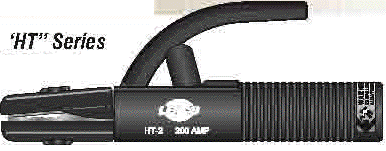

This is the Lenco HT.

Got the HT in today. Love the high handle. I can almost get my big knuckles under it. Gloved fingers are no problem.

That Lenco looks nice, good quality.

My only complaint with Tweco is that after using them for a few thousand pounds of welding rod, the grooves wear to where the only one left that will hold a 3/32" rod is the 90 degree groove on the very tip of the holder.
That's similar to the way this Lenco has started out. The end 90 and 45 will hold smaller rod but the rear 90 won't. The smallest it will hold is 1/8.
Ian
