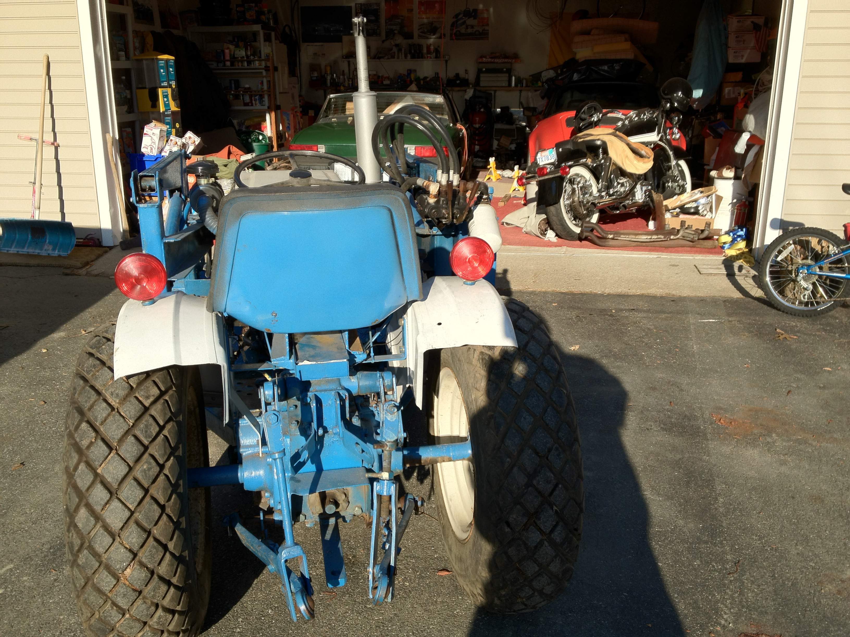

What model tractor is this?
Did we confirm its cat 0?
I think the Beaver was Cat 0 with the factory arms. I know mine is (was as I havent' had the 3pt on in years).
   / Class 0 or 1?
#12
Thanks for all the help, Cat 0 it is!
I did find that correcting the lower arms sends them into the tires quite frequently( 2x in 30 minutes).So unless I have a piece of equipment on I'll leave them backwords. Only takes a couple minutes to correct them:)

   / Class 0 or 1? #13
That is a common problem. I use a rubber strap to hold mine together.
   / Class 0 or 1? #14
I do likewise on my JD tractor though it's very rare to not have something back there even if it's only my receiver hitch since I drag a small trailer around a lot.
   / Class 0 or 1? #15

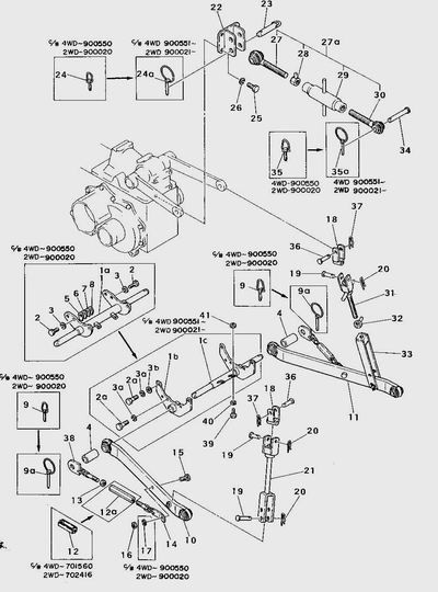

The older Kubota B series had the sway chains on the inside of the arm like the op had... Also notice the chain hook adjustment brackets up by the toplink mount... That is to take the slop up so the arm doesn't hit the tire.
Here is the satoh drawing for clarification.
