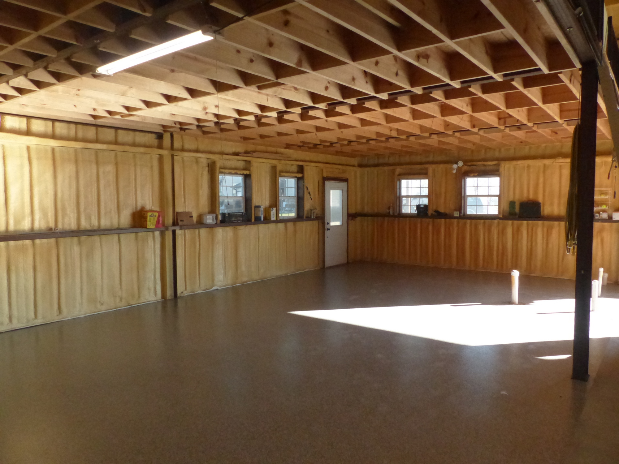

I've got a 40' x 60' steel barn with a nice concrete floor. Full building is spray foamed on the inside, nice and tight. I'm fixin' to build out a 20' x 40' x 9' tall section to be used as a "clean" shop and crafting space for my wife and I. The "ceiling" of the space has already been built as a loft/storage area, accessed by a staircase outside of the 20'x40' footprint. Floor has already been beautifully epoxy sealed. The intent is to condition this space with a mini-split system, while the remainder of the barn is unconditioned.
My first dilemma is how to construct and insulate the walls of the 20'x40' space, and how to insulate the "ceiling". Spray foaming is an option, but expensive and perhaps overkill. If I go fiberglass batts, does the vapor barrier need to face the conditioned space, or the unconditioned space? Would R-11 fiberglass be sufficient (2x4 stud walls), or do I need to go to R-19 (2x6 stud walls). I'm located in North Texas, hot and humid in the summer, cool and sometimes humid in the winter.
I'll certainly have more questions as I go along, but this is a pretty fundamental one that I need to resolve before I shoot the first wall down.

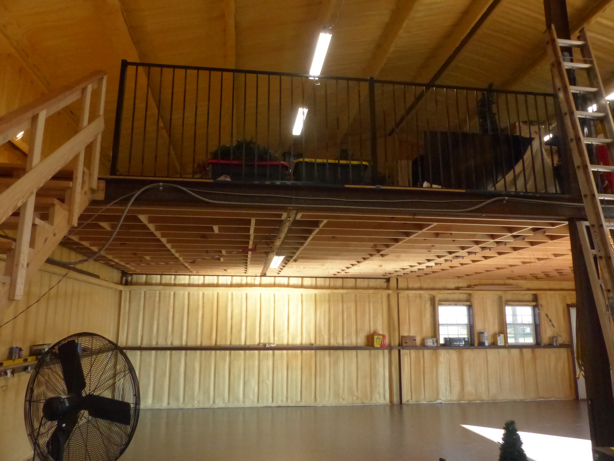

Got some good points there, (removed). Figure that I've got the "dust generator" part covered by going with a finished, sheet rock ceiling in the room. Insulation batts in the ceiling, between the joists that make up upper floor storage. Again, could go spray foam instead, but a lot more expensive. If using batts, which side should the vapor barrier point to, conditioned side or non-conditioned side?

Nother thing bout drywall ceiling, drywall itself gonna weigh 1280 pounds. Dat take away from deck capacity half a ton you not able to store upstairs.

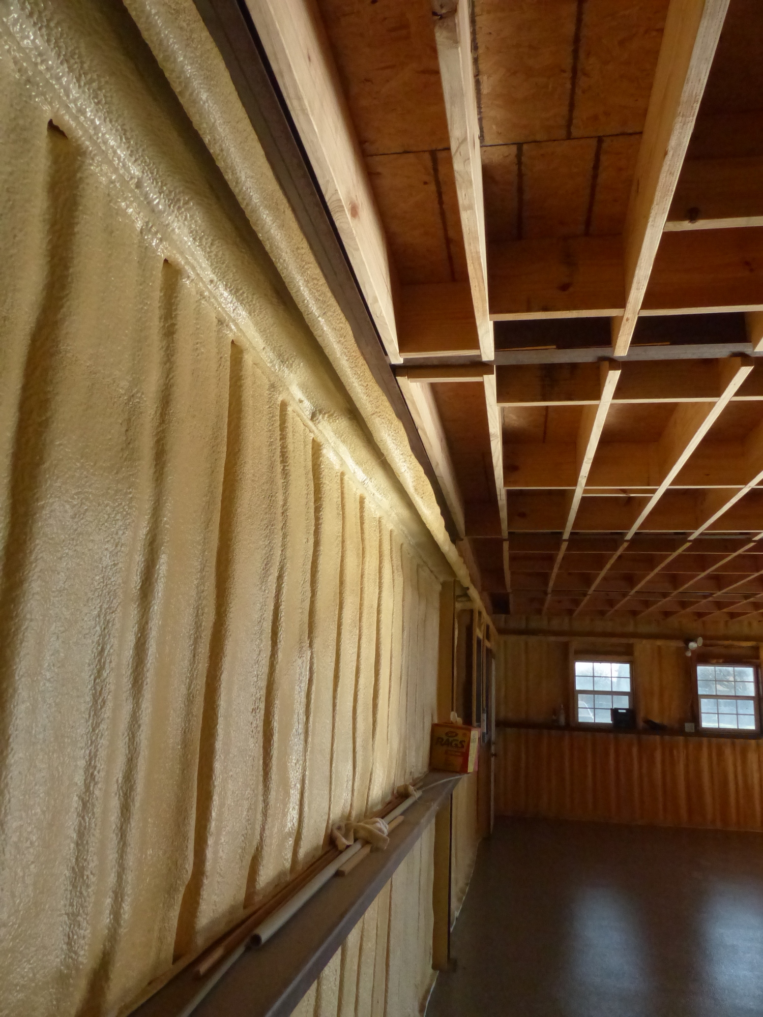

Prime directives from my wife are:
  • The room must be cool in the summer and warm in the winter. Temperatures controlled in the mid-60's to mid-70's when she's working.
  • The room will be nicely finished, with paint and good lighting. No "tin barn shop" finish in her space!
Epoxy floor was considered to be a "compromise". Basically has to be finished to an "inside the house" level. My concerns are mostly centered on avoiding any potential condensation problems because the rest of the shop is not conditioned space.
Here are some photos to better show what I've got.

Floor probably also gonna be BIG problem hauling humidity into room from ground cause not properly isolated from ground. Epoxy on top only minimal value UNLESS carried onto wall to isolate floor. Gotta connect floor seal to foam seal.
