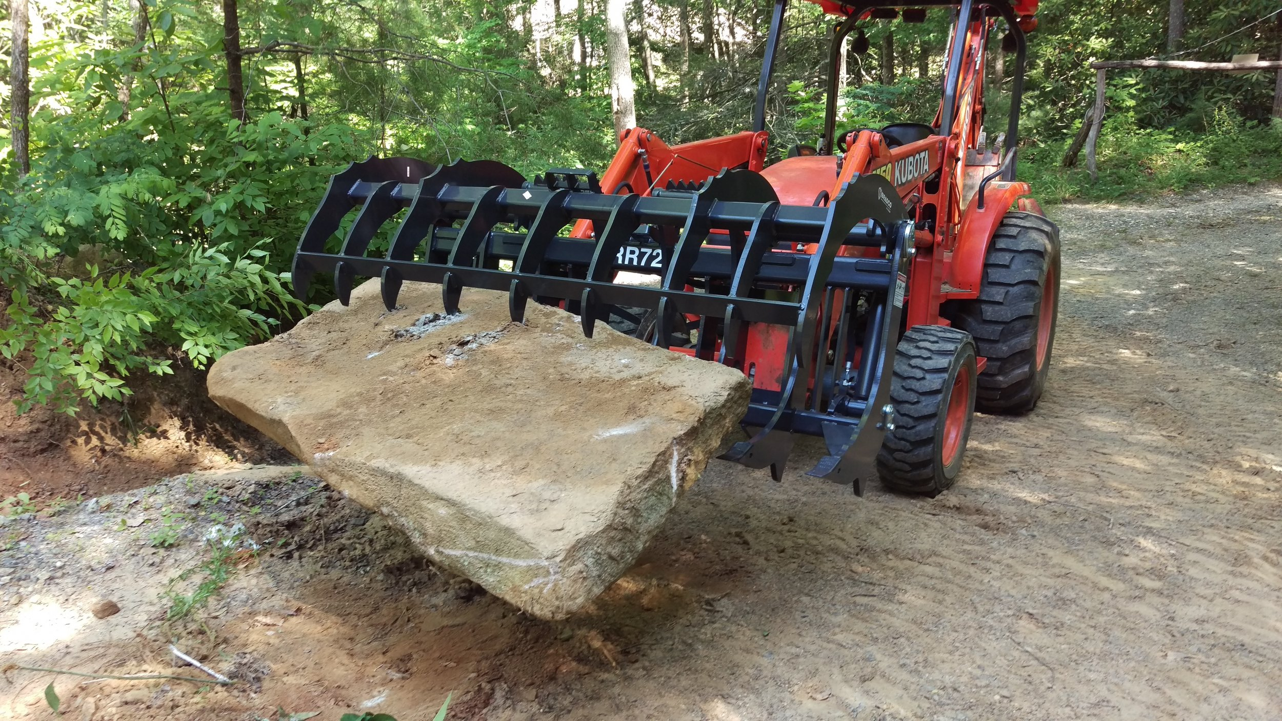

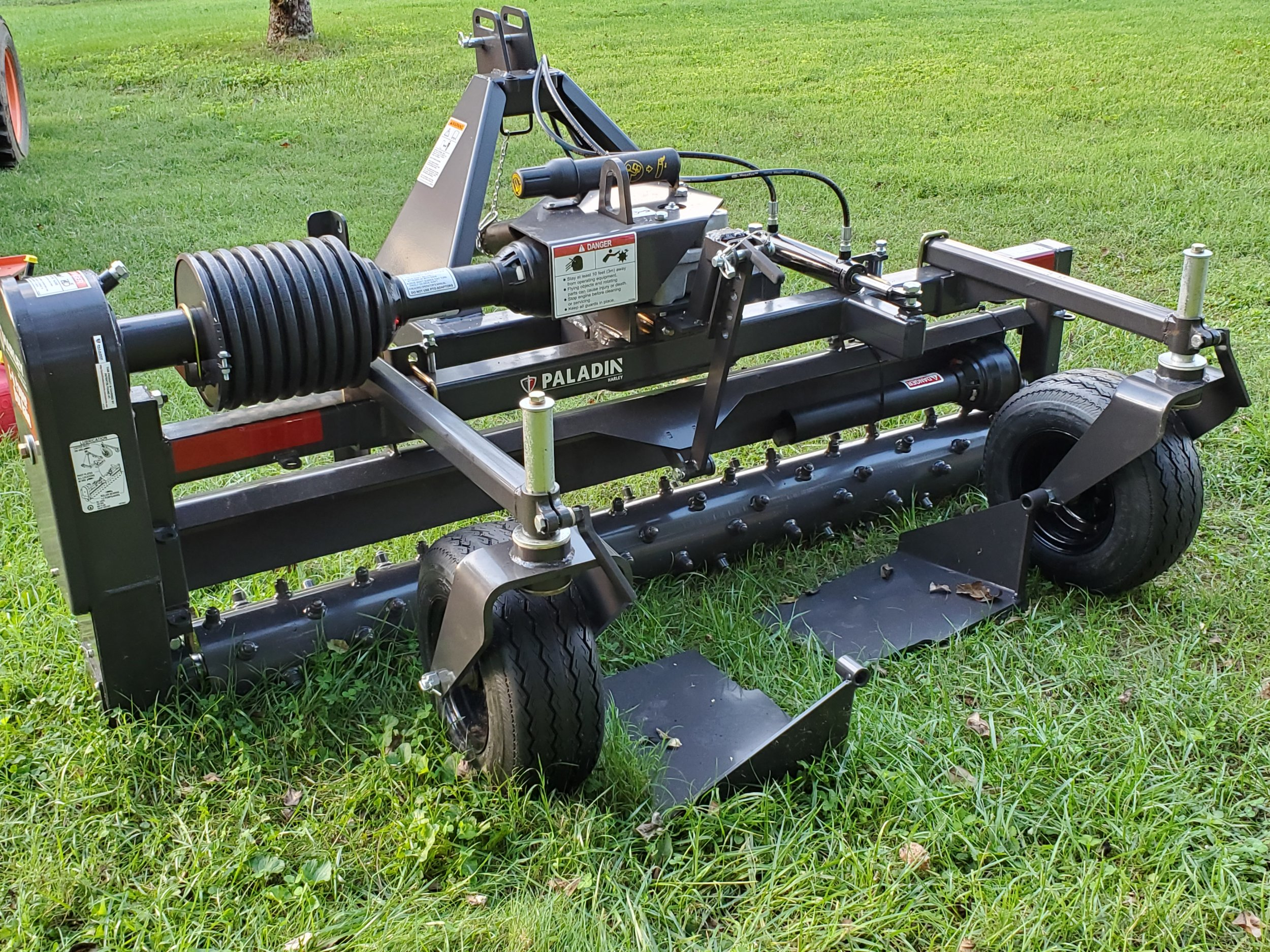

joea99,
Sounds like clearing that many rocks from 1 to 2 acres is a bigger job ( time wise ) than a B21 is capable of. At 43,560 square feet per acre and assuming a 4 foot wide root rake grapple and only working the top 4 inches of soil and 100 liner feet of clearing per hour, you are looking at 109 hours per acre. OUCH.
How much is your time worth? Time to start thinking about renting larger machine with more weight ( traction ), horsepower, capable of wider root rake, and greater capacity of pushing root rake thru soil to remove rocks. I am including 2 pics of machine and root rake I use to clean stumps and rocks ( anything larger than 8 inches) from soil and then move off to spoil pile. After "big" rocks removed then I go over it with power rake to remove everything else and leave soil level and ready for planting. A 8K lb or larger trackhoe is capable of running both the larger root rake grapple and the power rake. L pic gives you some idea of grapple tooth spacing and R pic is the power rake aka Harley Rake. You will find you can clear vines and low brush from land by dragging the top backwards by floating the top on ground or driving forwards and using lower teeth to to clean rocks buried up 6 to 8 inches below ground level in single pass. Depth will depend upon machine weight, horsepower, and root rake width.
I can clean, using root rake, about 1/8 acre of large rock ( over 8 inch size ) per hour and final clean and level the same area per hour using power rake. The M59 is a 11K+ pound machine with 60 hp.
Hope this helps with your project.

Imagine the price of the Harley Rake is scary.
Harley rake delivered Aug 2020 was $8,000 and I am guessing it is a good bit more now with all the crazy in the world. Renting for a week or month could probably be done for a grand. Could also have a local landscaper come in and do the work but they are probably also all backed up with work and just taking only the most profitable jobs.
As an aside but related to current crazy pricing. I paid $38K delivered in 2014 for used 230 hour M59 with hydraulic thumb and full set of Kubota shop manuals. In may 2022, I priced a new M62 ( the M59 with 2 more feet of reach on backhoe) at $95K and delivery of 1 year.
Rent if you can or down size your project until a year or 2 goes by and the world gets some sanity back.
