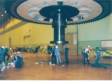

As an aside I worked on hydraulic governors on hydro generators and if someone saw you near the governor with Teflon tape you'd be run out of the powerhouse. Here is a picture of the rotor. These units were fairly large. The rotor alone weighed 575 tons.
   / Clean your transmission strainer!!!!! #10
What's the guy with that little engine hoist fixin to do, lift a bolt, nut or maybe a wrench?
