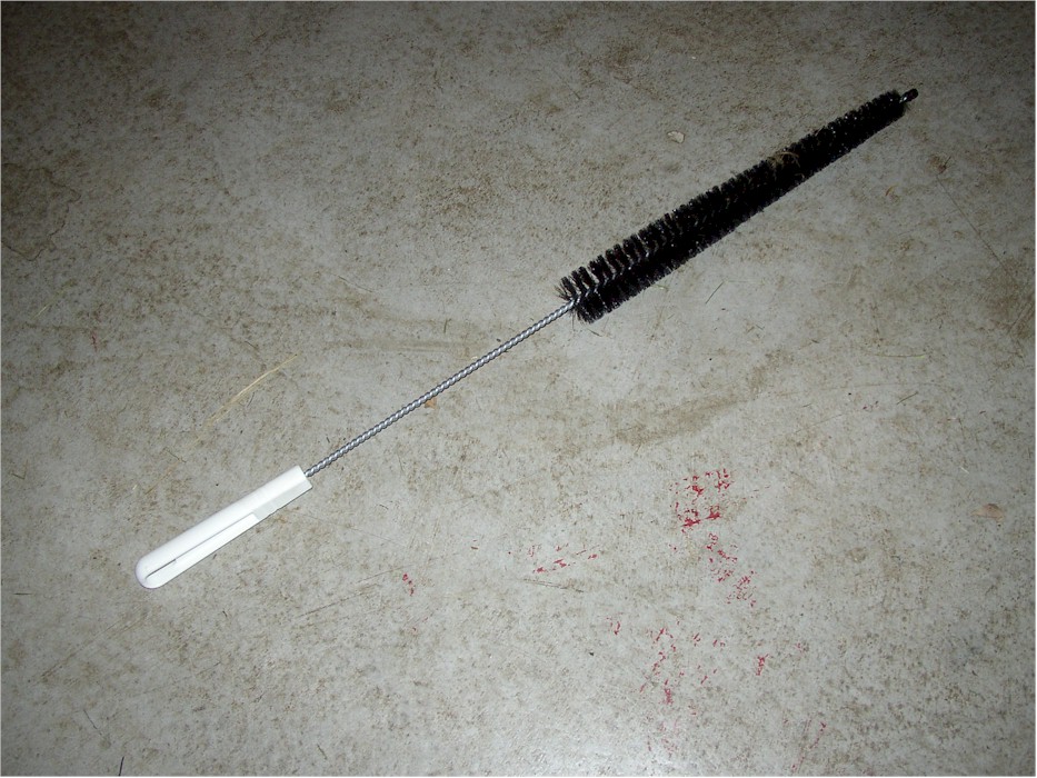

I have a tight clearance between the front of my radiator and the transmission oil cooler. There is a removable screen in front of the radiator that gets most of the chaff, but some can still get to the radiator. I use a Fuller Brush dryer vent cleaning tool available at Lowes. It will not harm the radiator fins and does a surprising job of pulling out the bad stuff. Just a thought in case it might work for you.
