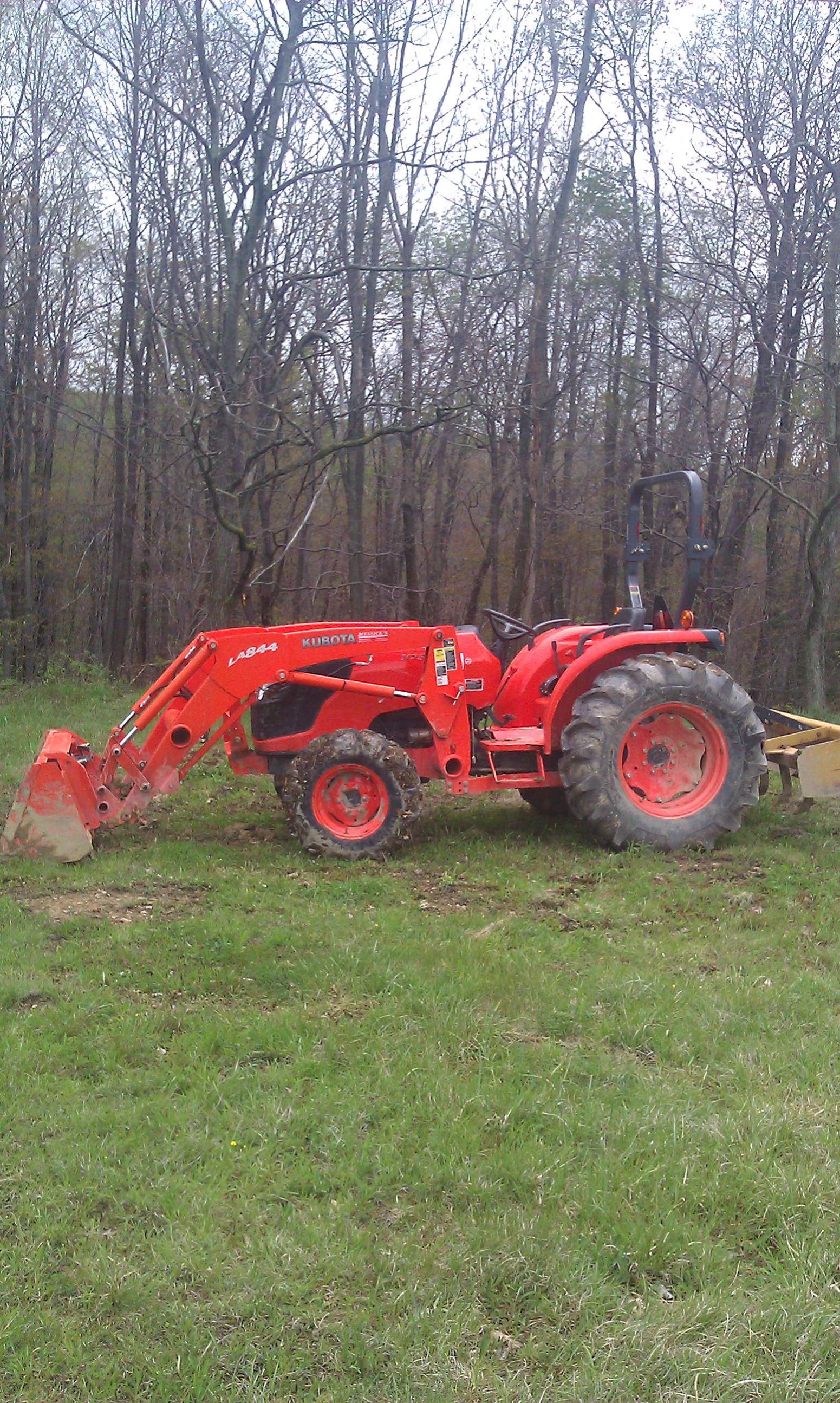

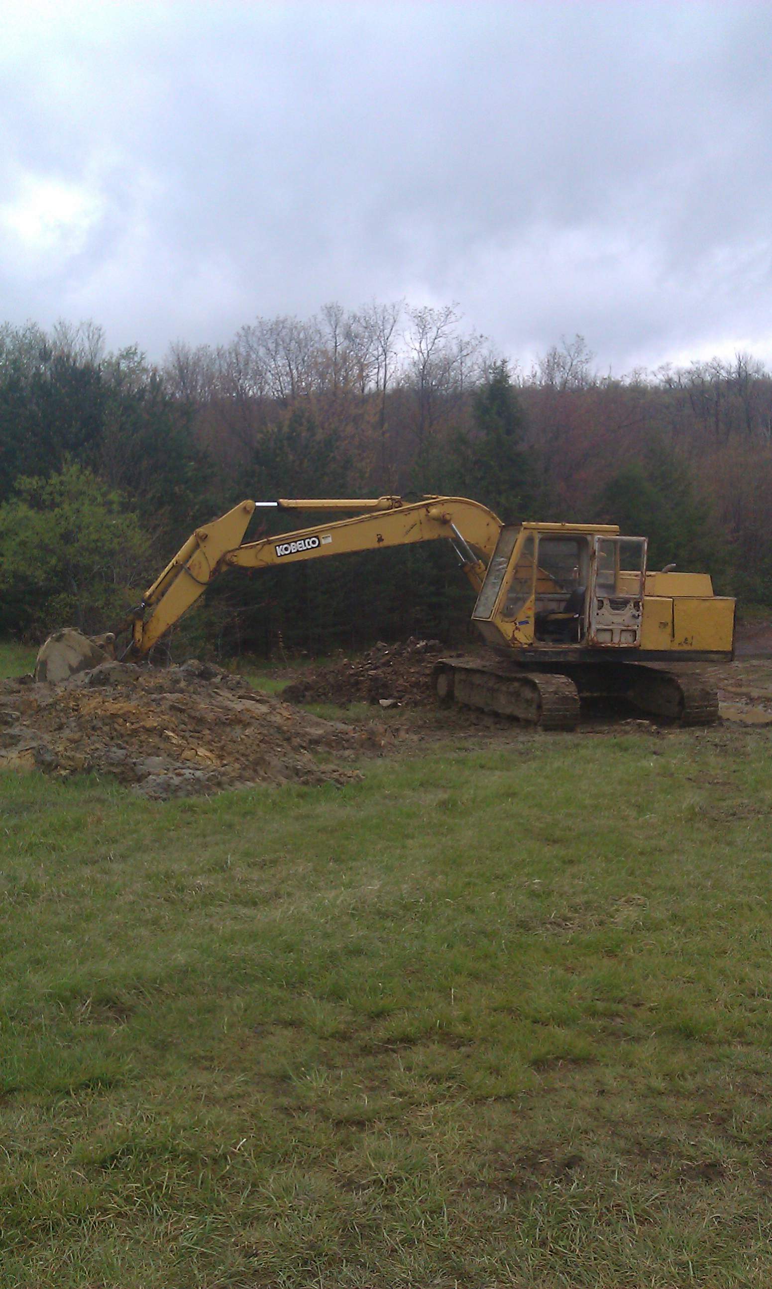

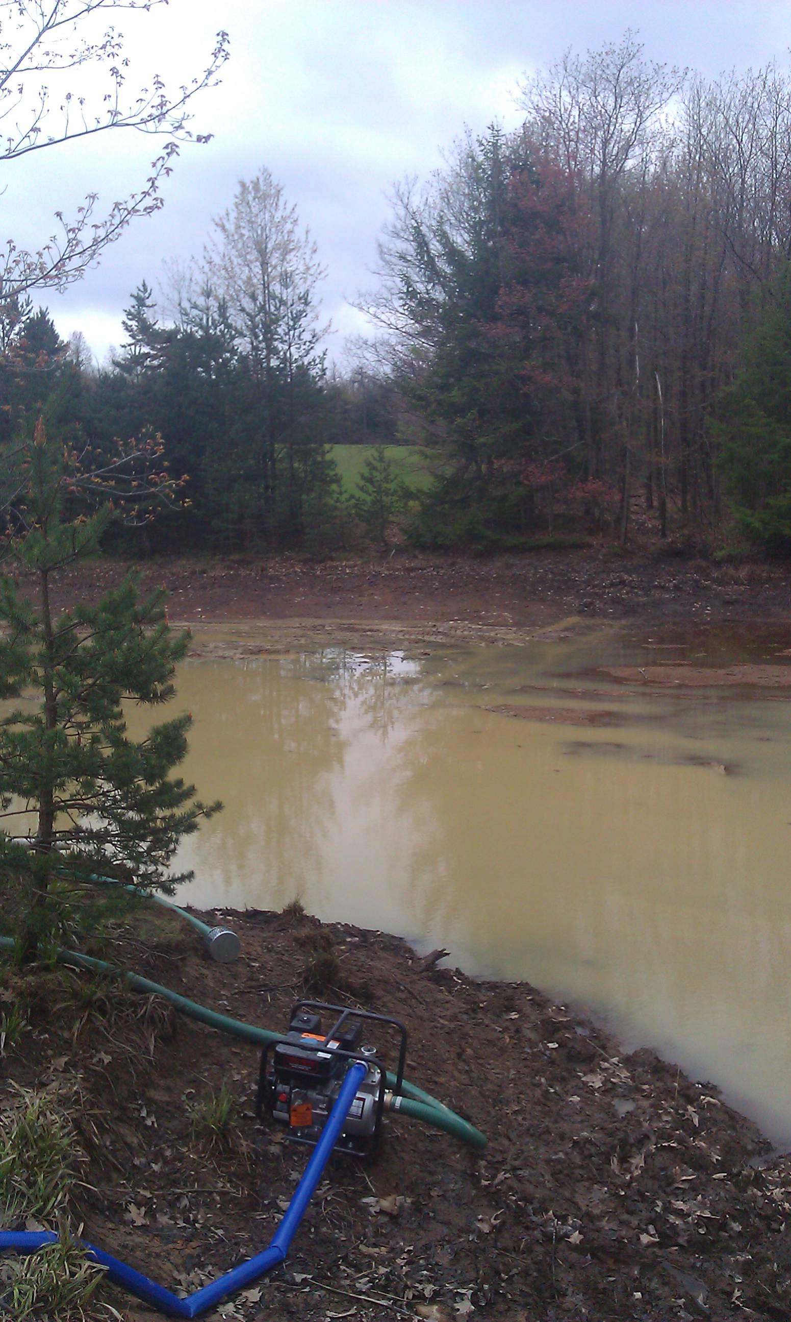

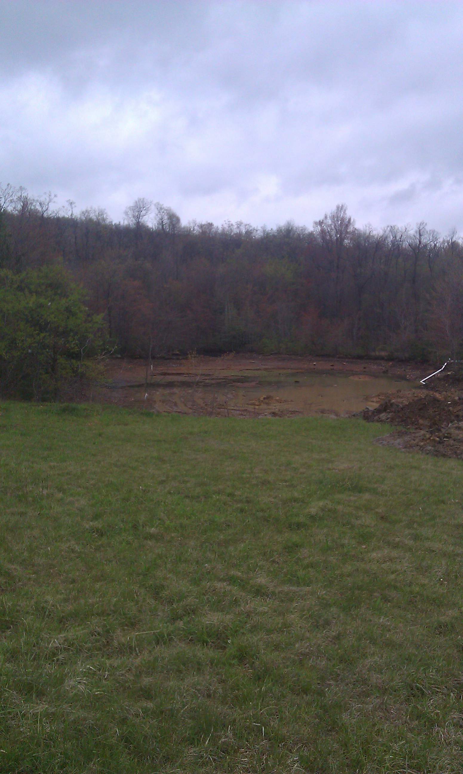

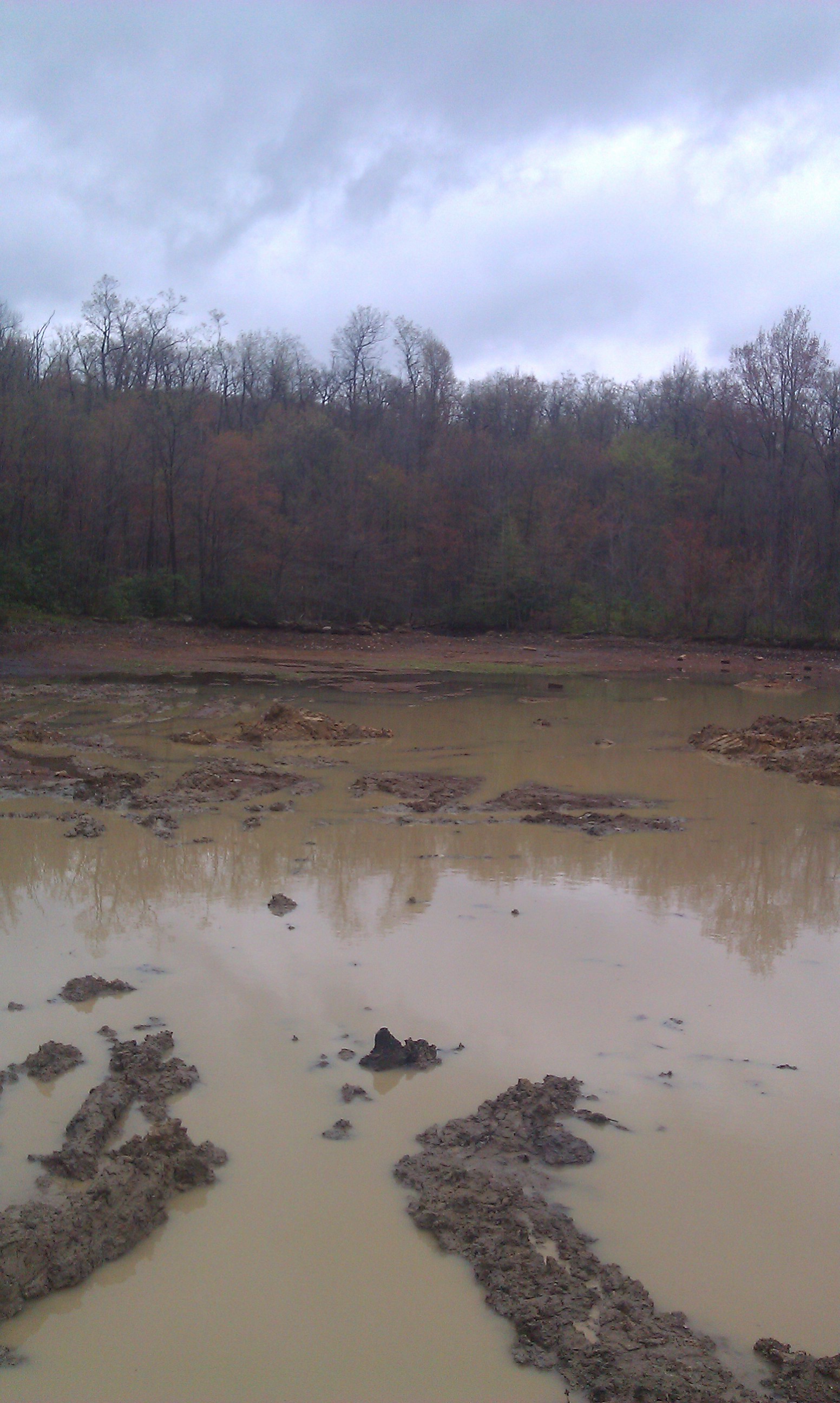

OK, I got the pond all drained and and got the tractor down in it and right away noticed that it wasn't all that full of muck. it was just made shollow I guess. So, i got the excavator that my friend was gracious enough to rent to me for next to nothing and dug down into the bottom.
It looks to me that it is noting but clay. I only dug down about three feet and I still hit nothing but clay. I don't want to go any further down than that. That will make it 10-12 ft deep when full.
Well, I quickly found out that there is no less than three springs running into the pond. It fills up rather quickly. as in one day. The pond was dry about 20 hours before these pics were taken.
I also found out that my Kubota MX5100 will take somewhere around 3 months to dig this pond to the depth I want. so, my buddy who I got the excavator off is also lending me for a minimal fee a HUGE Pay loader a Cat 980 I don't have pics of it yet. It is sitting at the bottom of my road right now about 2 miles away..I do know I am gonna have to buy that guy a beer !
Here are some pics.
First one and last one from my porch, other self explanitory.
