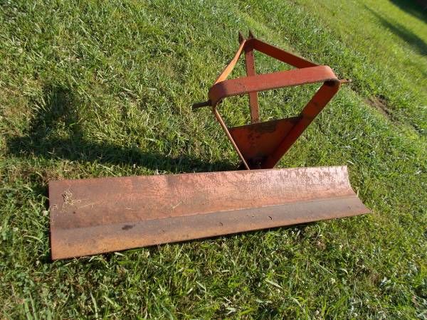

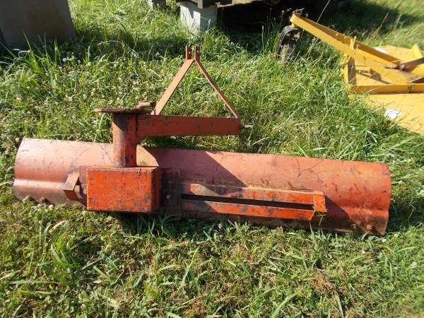

I saw this on CL today and thought about this thread...with an offsetting blade like this and hydraulic top and tilt it greatly increases the abilities of a rear blade...I wish my blade had offset capabilities...The below blade would work well on a lot of my ditching...!

Many blades will offset, but don't have a provision for it. Just unbolt the rear mount, then remount it a pair of holes right or left of center.

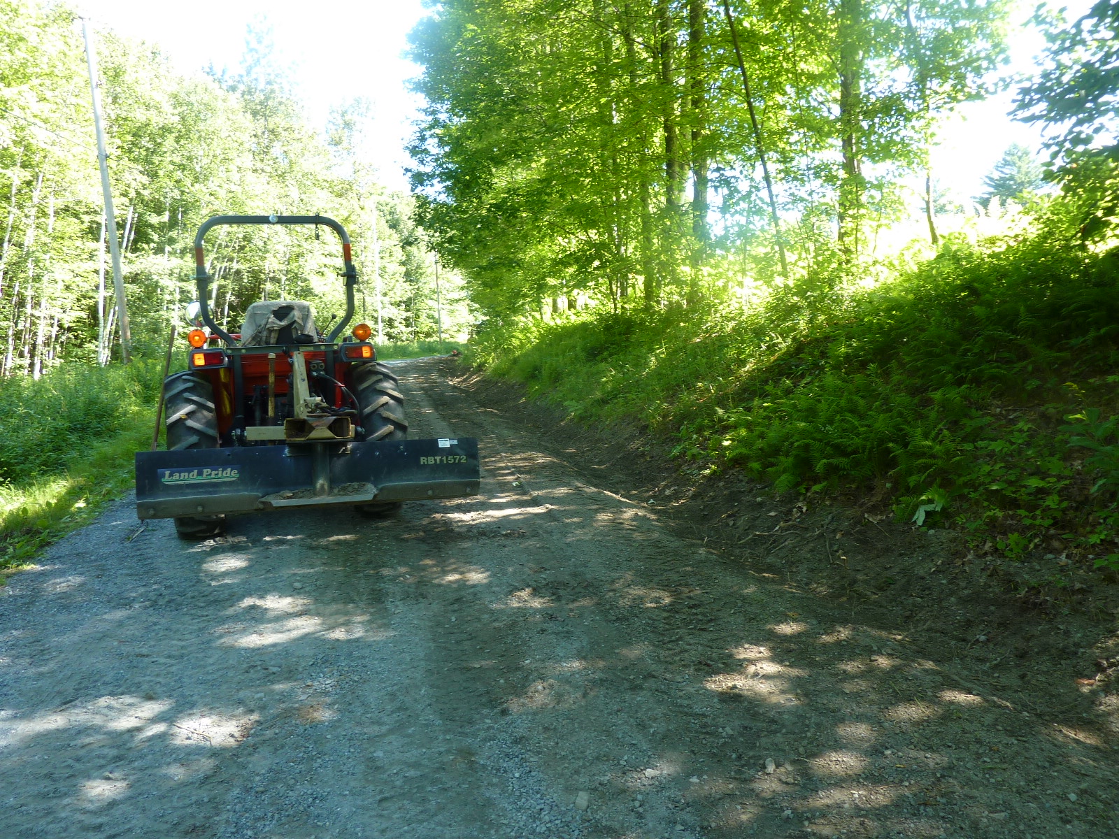

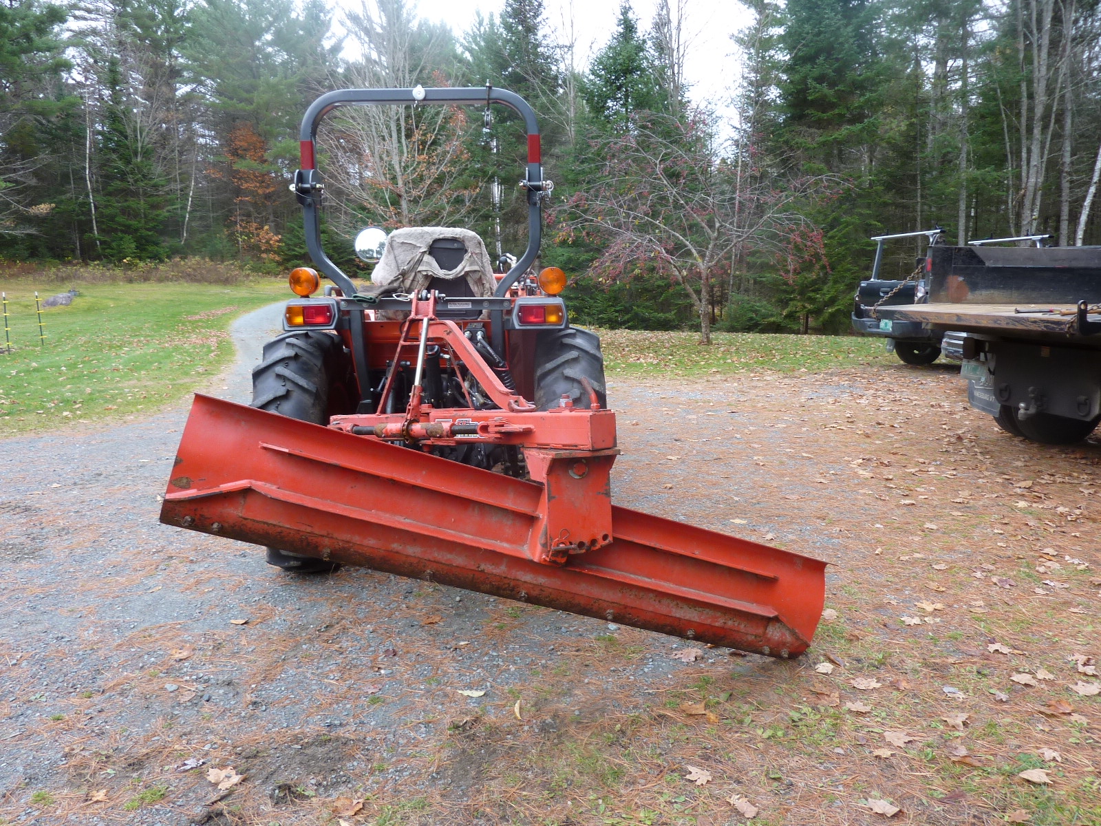

On topic when I clean out my ditches I tilt the blade and angle it and offset the blade I can get the end of the back blade behind the rear tire and it will cut a small steep banked ditch.

I agree about cutting a new ditch or reforming/shaping an existing ditch. I cut ditches with my blades too.
But if I just want to clean out the leaves, using a blade does not work for me. It makes to much work. Instead of a row of fluffy leave that are easy to clean up off the edge of the road I get a lot of dirt, vegetation, and rocks, mixed in with the leaves. Also there are two new windrows of loose soil, one along either side of the ditch, from the blade cutting. If they are not removed and the edges contoured the loose soil just falls back into the ditch. Maybe its just me this happens to but whatever - A rake and a dump trailer is easier for me if I'm just cleaning leaves.

Thanks guys. After hearing all opinions I really need a top & tilt rear blade. The one in the pic would work well. We've got 3 Stihl BR600s & I've used 2 simultaneously & they just couldn't get the wet leaves out. There's some gravel, dirt/mud, & sticks mixed in here & there. It's my fault, this is a new purchase & if I had stayed on top of it, 1 BR600 prob. woulda done the trick. Now I'm gonna pay w/ sweat getting this darn ditch cleaned out...
