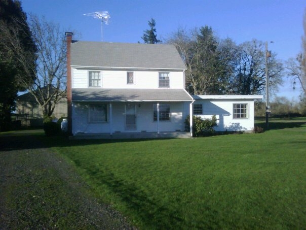

Vinyl siding manufacturers recommend that you do NOT use a pressure washer to clean vinyl siding. It has many small drain holes on the bottoms and a pressure washer has so much power it gets water in these holes and behind the vinyl siding where it can do damage.
I have always sprayed on a solution of 50/50 water and full power bleach. Let it sit and 90% of the mildew disappears. Then I spray what is left, wipe it with a broom or car brush and hose it off. This works for me and the bleach is so diluted after you finish that it never harms anything of mine.
Don't stand under it and spray up, and pressure washing will work just fine. All you need is a ladder that will reach the eves. All you need is water. I did my parents' house every year for 35 years with no problem.
