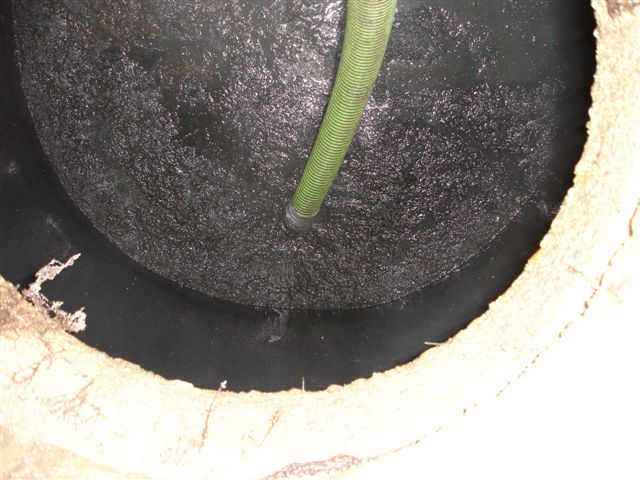

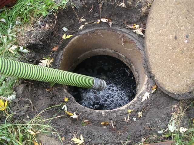

Well, my septic was pumped today. Verdict after 2 years, no scum and only 6 inches of sludge (barely).

The felllow who pumped my tank (septic system "colonscopy") tells me the little yellow cards only come for tanks built after 1979 (don't know if this is true?). He tells me since my tank built 1973, he suspects there are no records of my system, so no yellow card.

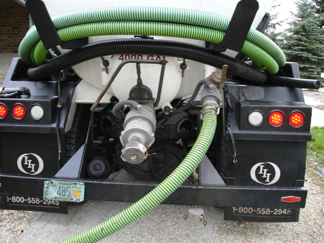

I see your pumper has heated valves on his truck. I have heated valves and heated pump on mine. The antifreeze circulates from the engine to water jackets built above valve to vacuum pump back to coolant system. In winter I plug in block heater and circulator pump at back of truck. It does use up the electricity. plowking

I did not notice, never even thought to look or ask. The fellow who did the pumping was very good and helpful.
