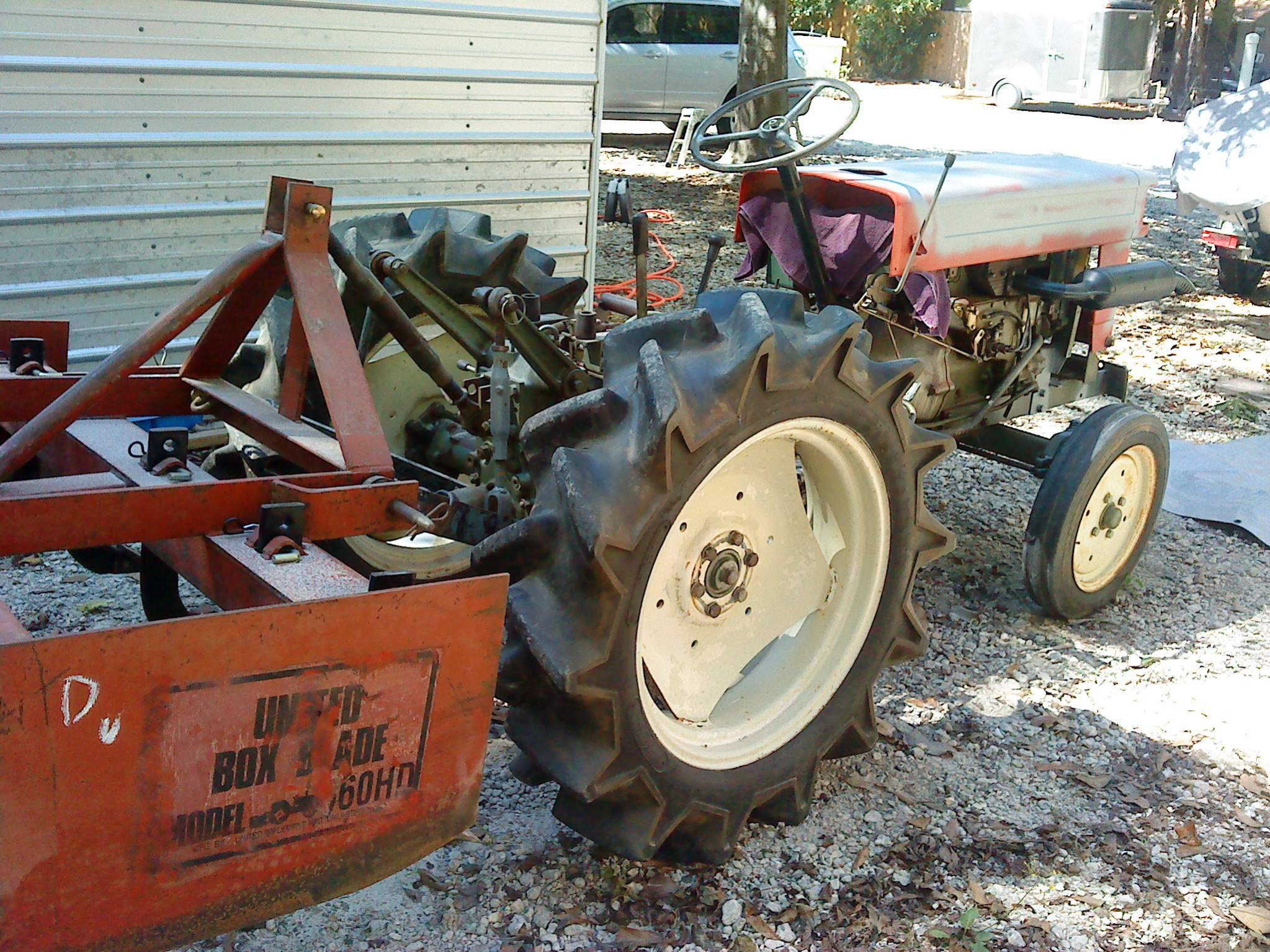

The short adjustable upper link and the 'bridge' (my term) that extend back from your tractor, that is, everything in carey's photo, are specialized Yanmar parts to hook up a Yanmar tiller and lift it in a way that doesn't hit the tires.
In contrast, a Universal 3-point hitch, used on nearly all farm tractors since the days of Harry Ferguson (1939?) has a single longer link in place of those two Yanmar components.

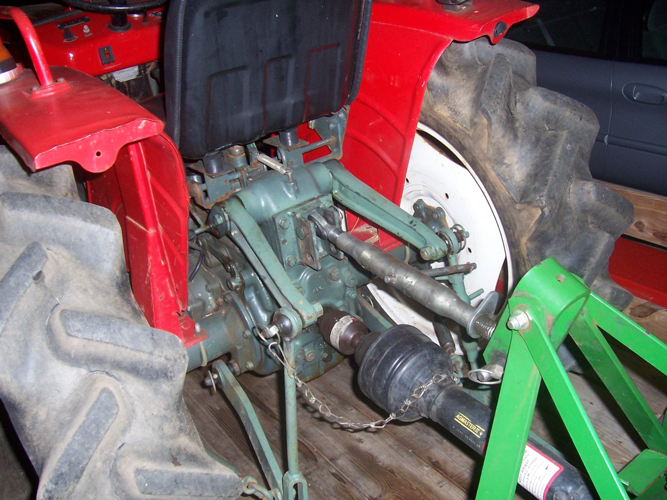

Sorry about that this is all it is.Looks like you have a Ghetto Rig of a toplink mount on your Mower. That is why they have the Tiller Top Link Backet on there. Get a longer adj. top link and just use your pins if you have other Implements. And yes keep up with the top link to the Tiller they can be hard to come by. Here is a Pic. of my Grn. mower setup :p And Chck your PM.;)
Carey

heres another pic of standard upper link.
