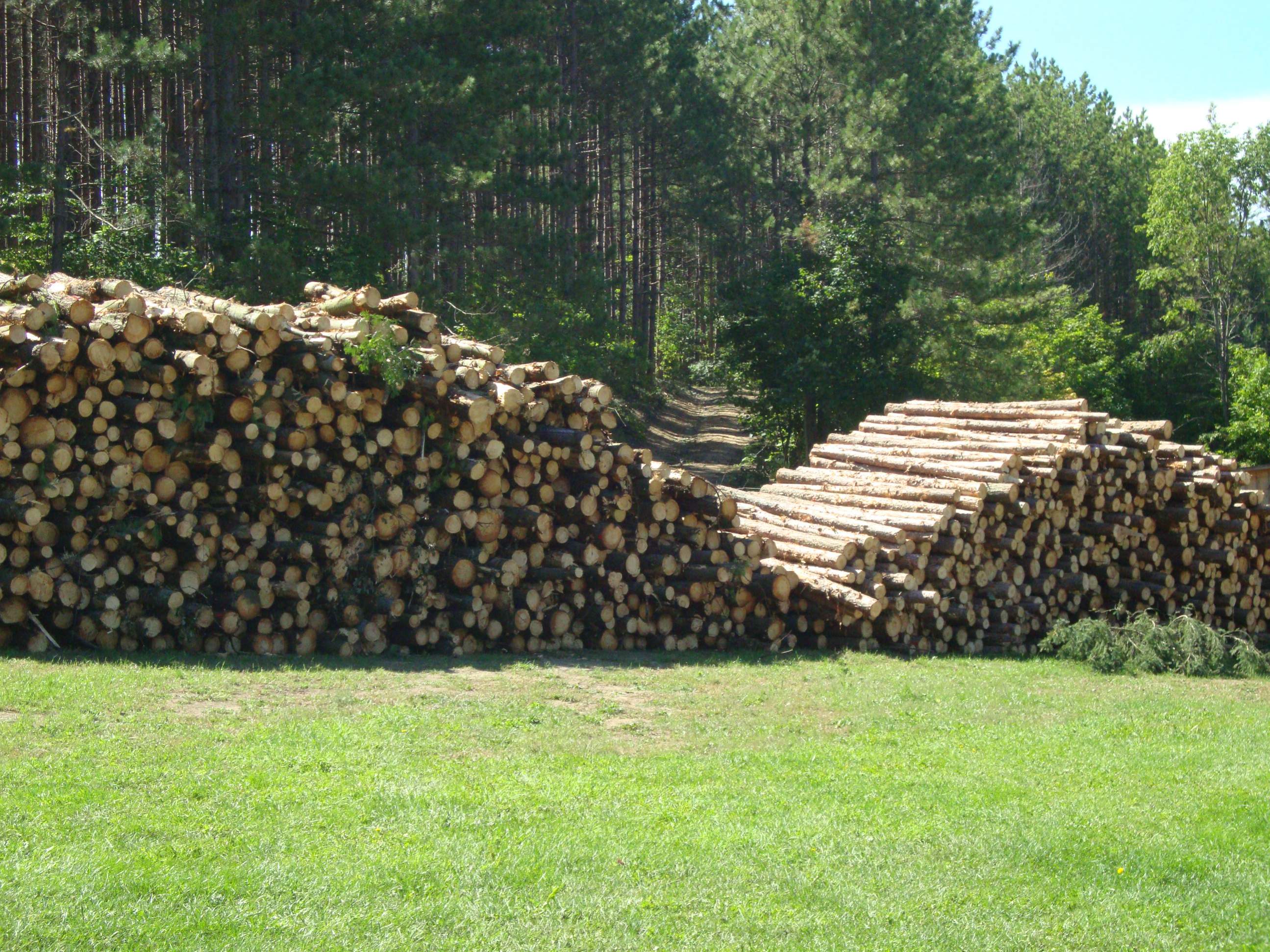

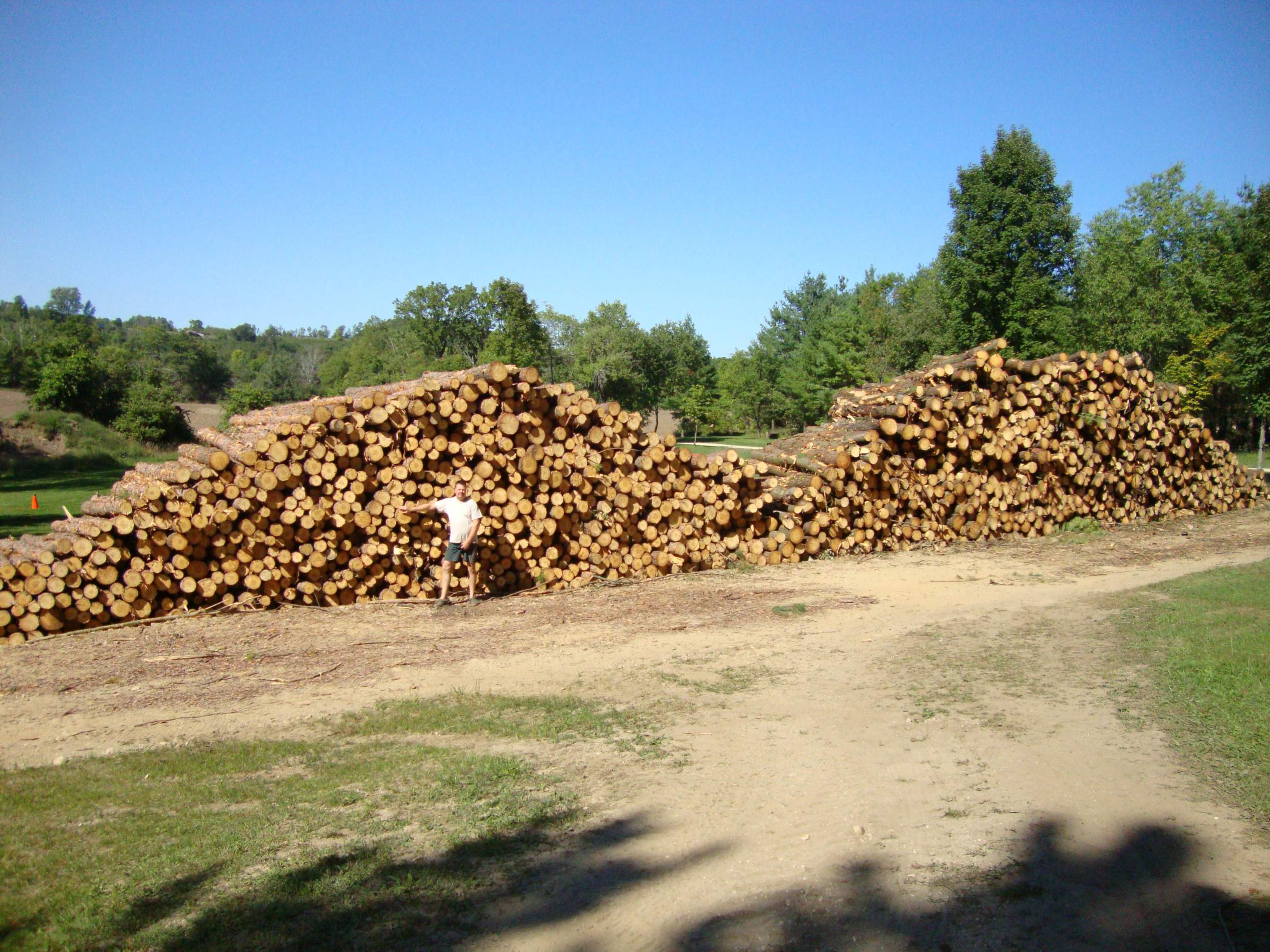

I'm in the same boat! Man, what a mess! And we take such pride in keeping things nice. I had, and still have an excavator on site and got him to take a few stumps out closest to the roadway, and then loaded them up to take for burning. I quickly realized that this would put me in the poor house at $100.00/hr. Also, reducing the stumps in the fire pile takes a lot of fire!
I bought a grapple for my small wheel loader to remove the slash piles and this works good in places where I can approach them from the side, but many I can't. Trees are in the way, terrain is difficult and at times dangerous for the machine, and those stumps are a terrible hazard. Many of the slash piles are placed on top of stumps probably on purpose, and that material becomes difficult to pick up.
No easy answer to this one!
This is only a portion of the wood taken.
