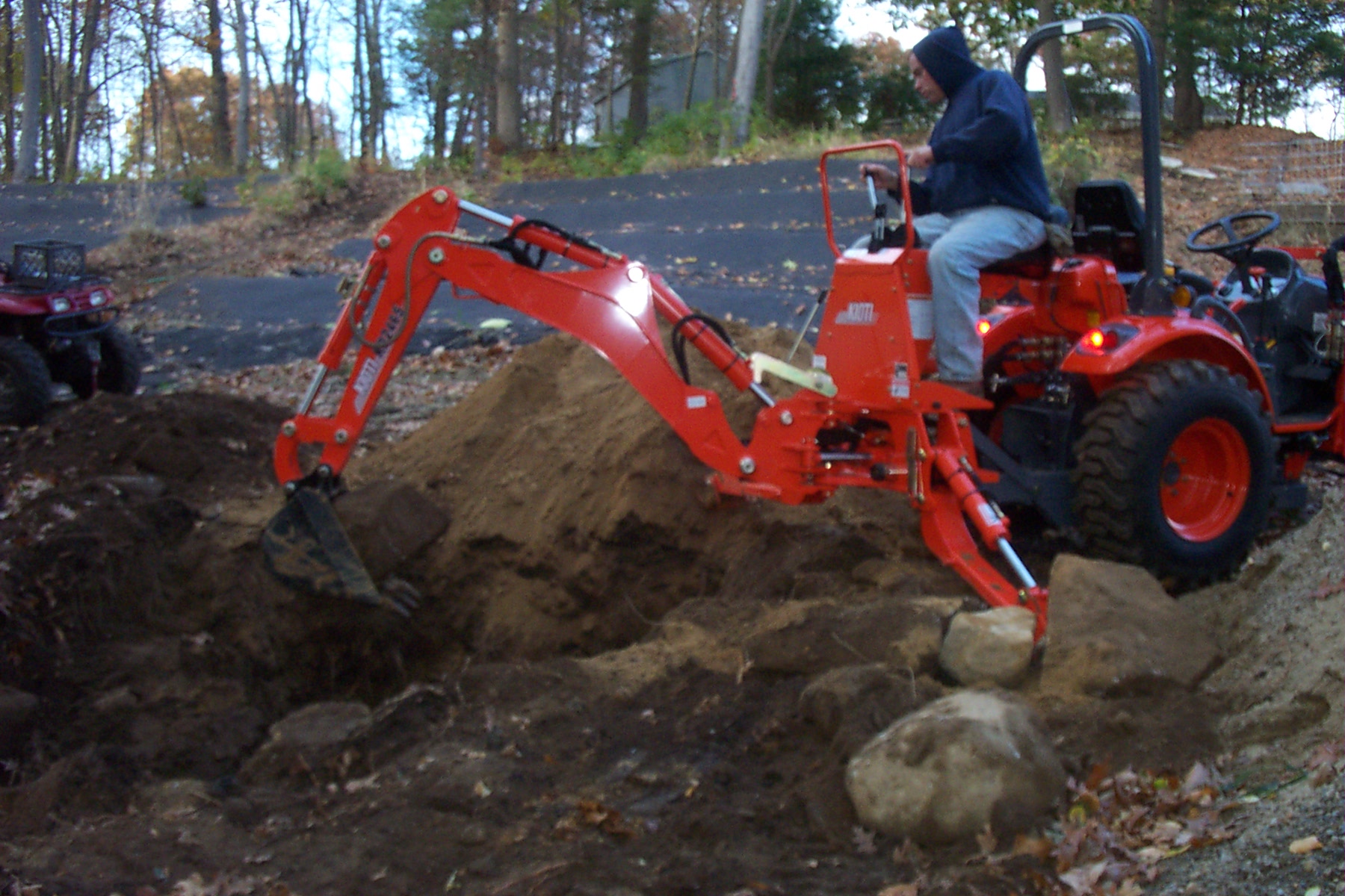

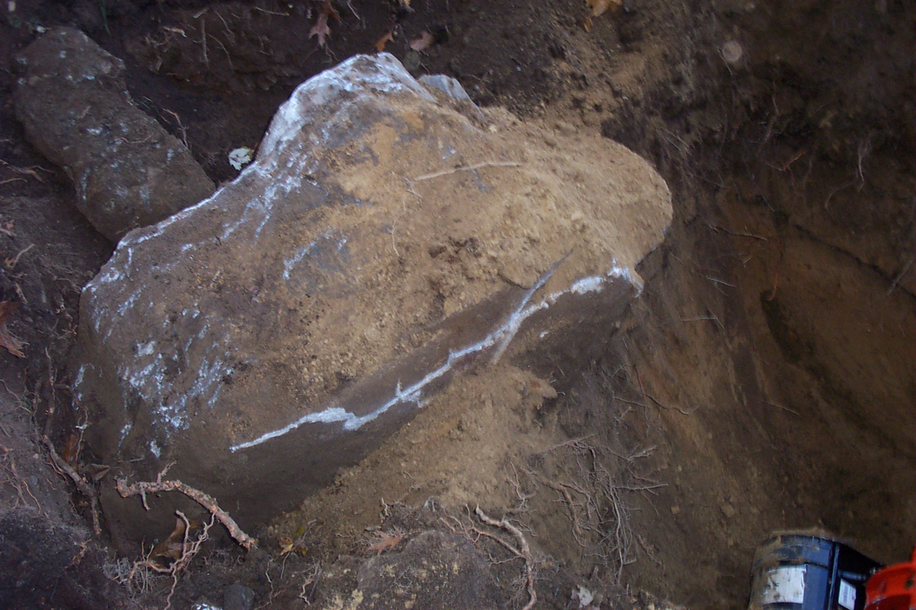

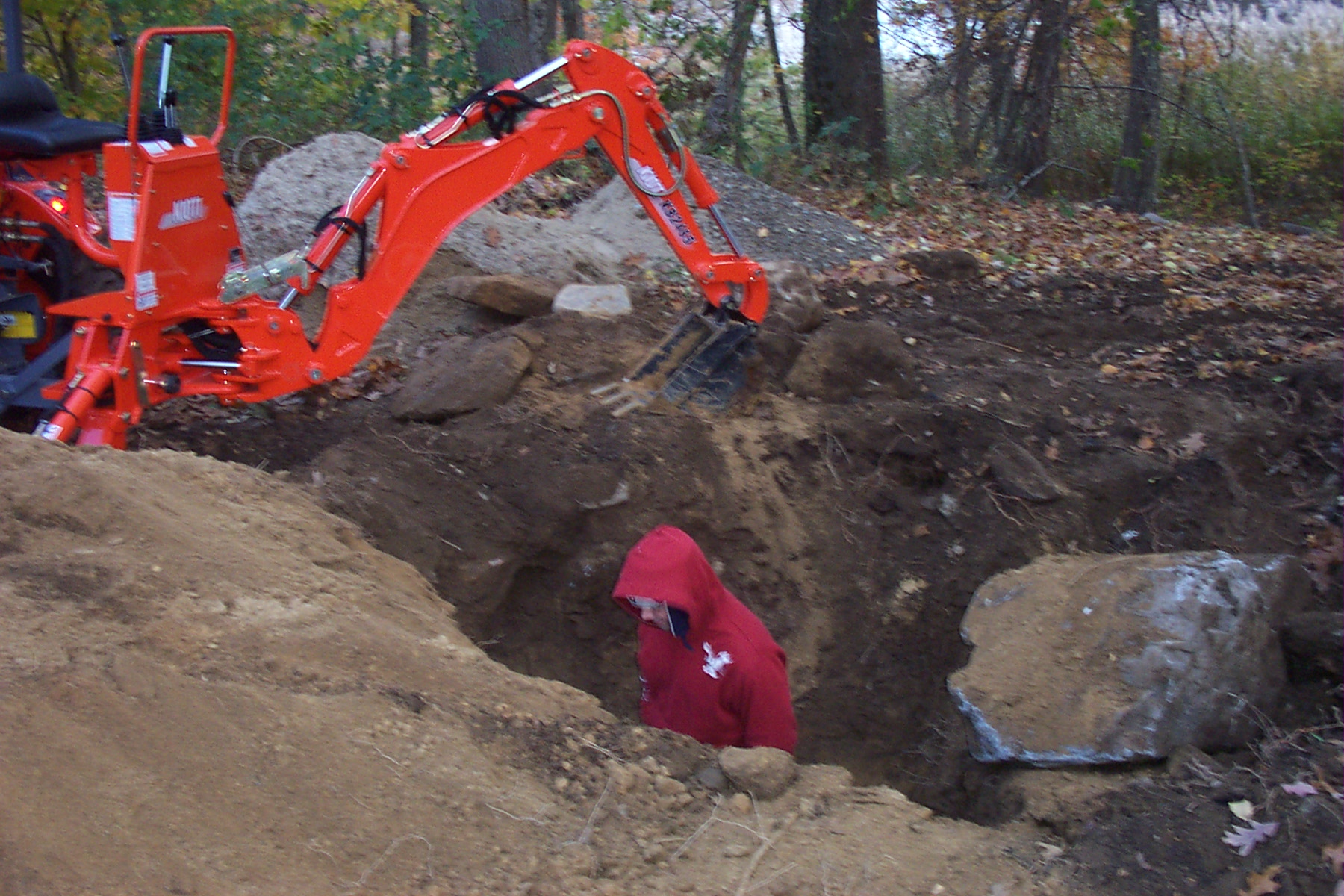

Here are some pics of the kb2465 in action. I am also very happy with it.

Holy Schmoly natem, you could've made a pond out of that hole in the 2nd pic! Was that the wife that caught you trying to fill it up? :)
Just goes to show that our KB2365, 2375, and 2465 are outstanding CUT backhoes - though I'm sorry to hear that a couple have leaked and hope the dealers/factory make it right. I "rolled" an O-ring while carrying and mounting a 1700lb castiron lightpole (right at the hoe's weight limit) and the dealer mailed me a whole new boom cylinder no questions asked.
