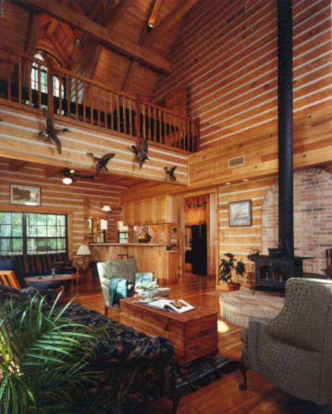

I've just been using a wet sponge on ours now for the last twenty years or so, works great.
