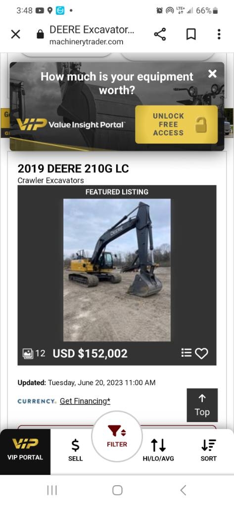

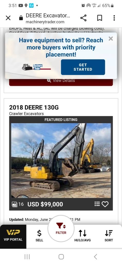

I would rephrase that to, get some quotes from quality contractors. If this is 1 acre per 8 hr day kind of woods; that's going to be around $400k +. I Might look at an older JD 200 hoe, for around $120-150k, and do that. Just know going into it, you probably want to budget $50k for repairs, maintenance, ect. I dont think I would look at the $30-50k machines, they are probably worn slap out.
   / Clearing 154 acres of woods in west Tennessee #46
I would rephrase that to, get some quotes from quality contractors. If this is 1 acre per 8 hr day kind of woods; that's going to be around $400k +. I Might look at an older JD 200 hoe, for around $120-150k, and do that. Just know going into it, you probably want to budget $50k for repairs, maintenance, ect. I dont think I would look at the $30-50k machines, they are probably worn slap out.View attachment 807939View attachment 807941
