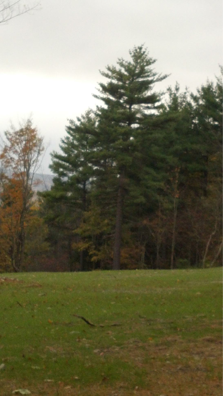

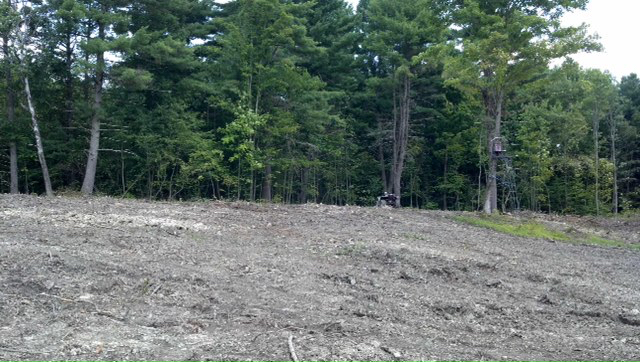

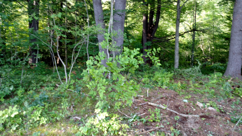

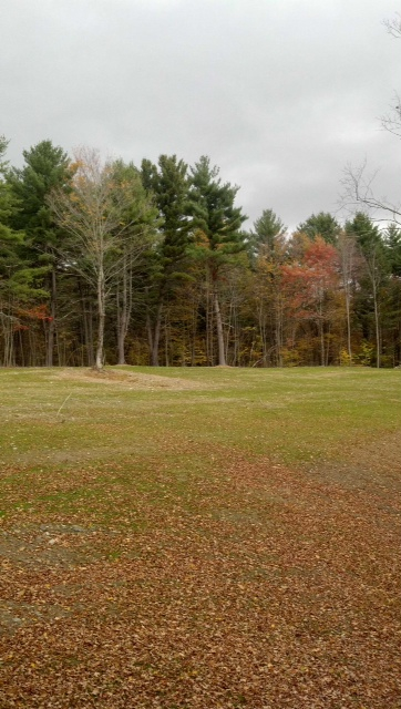

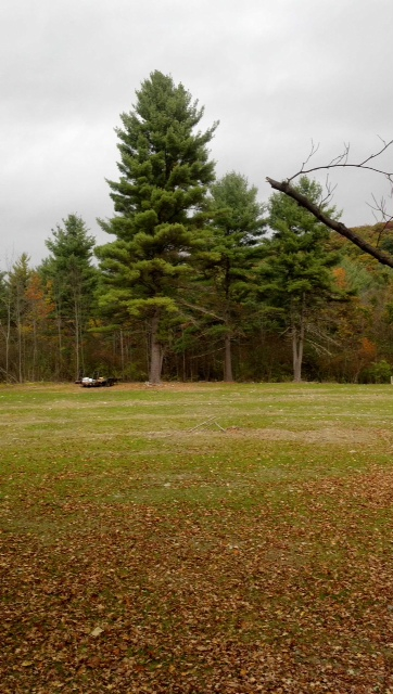

Well, got the seed in a few weeks ago and it is coming in nicely. The clearing in the end was 3.7 acres. Nothing else planned this fall except hunting and some brush hogging in the lower fields. Here are the pics.

To think that 6 weeks ago that entire area was a forest and to see it now cleared and grass growing is a relief. A few minor things to tweak but nothing else major planned until next spring. Time to enjoy the fall and sit awhile in a hunting stand.

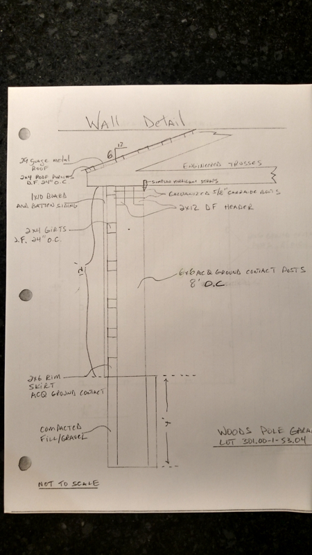

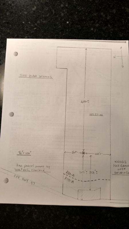

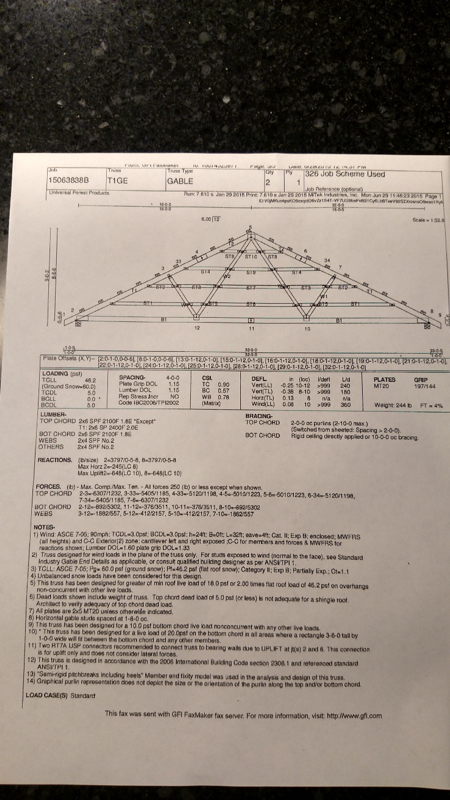

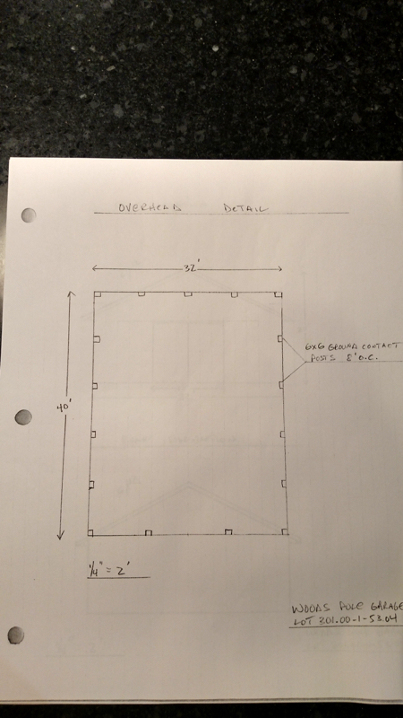

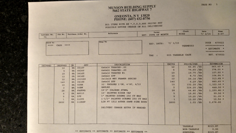

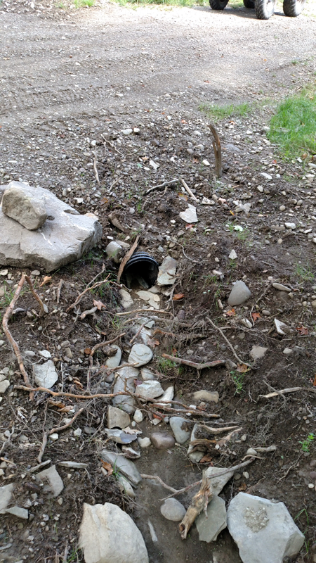

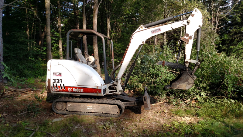

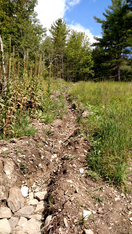

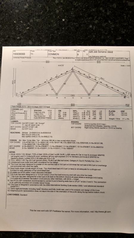

I wasn't able to get much done this spring but have been plodding along this summer. I got tired of renting an ex to do stuff so I bought a Bobcat 331 excavator. What a benefit it is to have that on hand 24/7. I can now do what I want when I want and not have to worry about the weather and wasted rental days. image-1221657747.jpg I had a spring constantly keeping the west end of the field wet. This was going to cause a problem because I want to build the pole barn in that section along with the driveway passing through that area. I dug a 400' long trench along the back and west and put a culvert under the existing driveway. The driveway stops at the clearing for now but will extend past the barn to the house. The culvert pipe is 40' long 8" diameter. And by God it works! The area that was wet is now dry! image-96153174.jpg image-3448246455.jpg image-1373411189.jpg I drew these pole barn plans for the building dept. They were extremely nice to work with and had the building permit back to me in 8 days. I planned on getting some of my old construction crew together for a long weekend and slapping it up. The logistics of getting everyone on board were causing delays. So, I looked into hiring a local crew to put up the frame and I would finish the rest. Not happening. The contractors I spoke to sounded incompetent and the one I trusted to give me an estimate said $6500 to just put in the poles, purlins and tin roof. Just labor. I am providing the materials. No girts, siding, trim doors etc. so, back to getting my old crew together. I am 250 miles from the site so it can be problematic to get everyone on board the same weekend. It looks like it will have to wait until the spring. image-1358091211.jpg image-1466625518.jpg image-2676484390.jpg image-2808318359.jpg image-2808318359.jpg image-755480067.jpg image-2662941685.jpg This was the materials estimate for the supplies for the barn. I am going with board and batten siding and a black tin roof. I will make custom barn doors. image-433090470.jpg I had 13 loads of bank gravel delivered and leveled out the pad. I had a pile of topsoil that I used to feather down the edges. Down the road I plan on putting 2 8' wide lean to's on both sides of the barn. Before image-1976266189.jpg After image-2462293789.jpg I also had some fun with the new bobcat and cleared a bunch of brush from the clearing to the creek. I got a brush pile 30'x60' 10' high. Gonna be some fire! Before image-883573244.jpg image-4117953616.jpg After image-1513740493.jpg image-2943074628.jpg Well, I figured you guys would enjoy the pics. I always enjoy seeing your projects and pics.
