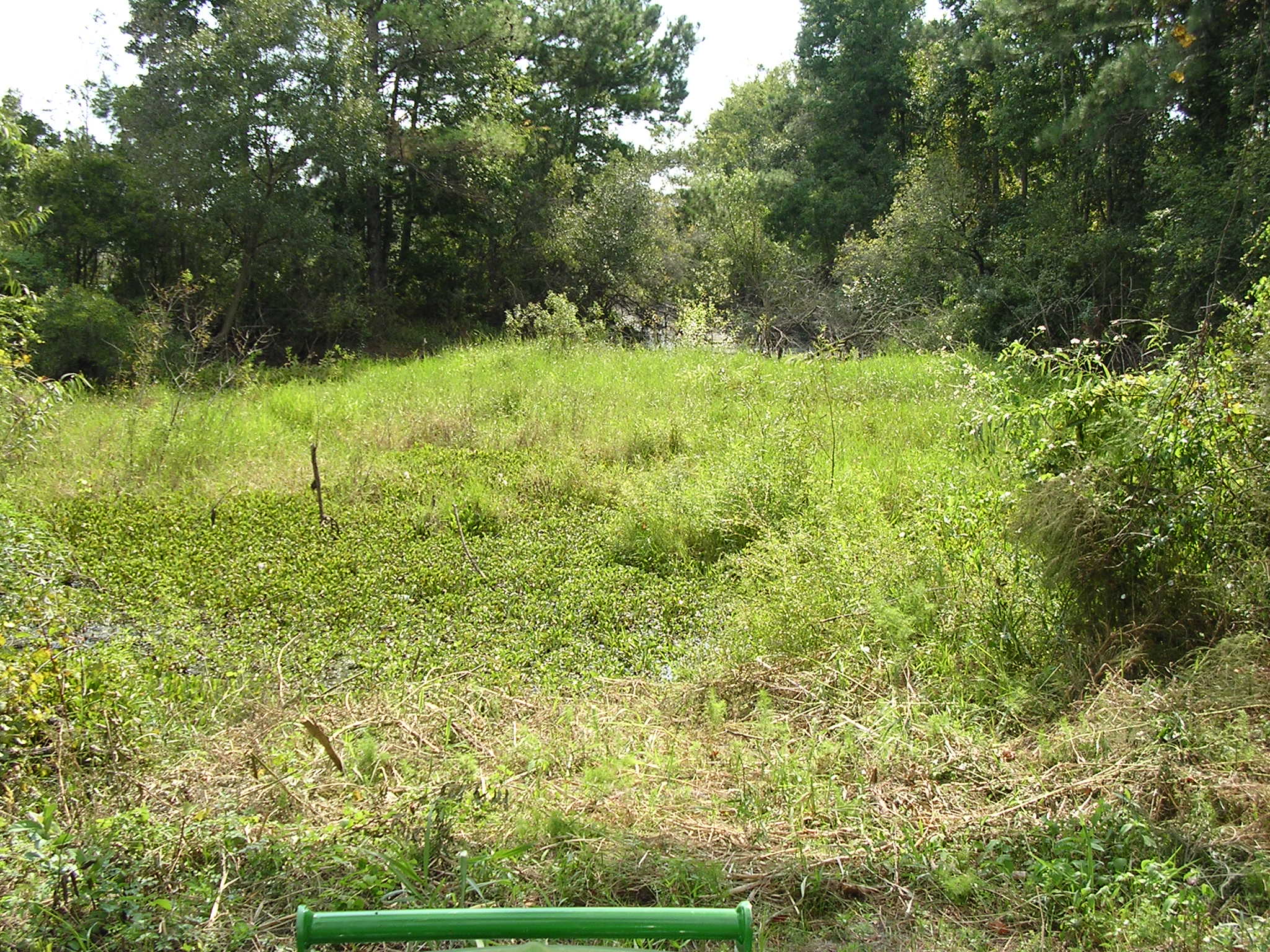

On my new property i have an inlet of a lake. This inlet is about 150 by 100. I'll post picture. This picture is a little deceiving as far as scale. The tree straight across from this view is probably about 100-150 feet out. The grass you can see is all growing from the lake itself. To the right of the large tree is an open section to the larger lake behind (about a 15 acre lake). Id like to clear this out so boating will be easy. The lake itself is crystal clear, but my inlet is full of this swamp grass and water hyacinth. Is their some type of round up spray that will kill the vegetation and not harm the fish and other wild life.
Their is a bank that goes all the way out to the large tree that I will clear with my weed eater and bush hog.
Any help would be greatly appreciated.
Here is the pic:

WOW!! I had to look real close just to see that there really is a lake there. You sure got a job ahead of you!!!!!
Do a search for the posts by "Fishman" and read up what's he's said for chemicals on water plants. He's the expert on these things.
Before you start spraying, I'd thin them out as much as possible, then spray what comes back.
A friend had a stock pond for cattle that was totally overgrown similar to yours. We tried spraying it, but that just made a mess. The plants that died just sunk and new ones took over.
He had a giant rake made up that we used to drag along the bottom to pull out the plants. One guy would carry the rake around the oposite bank. It was attached to the back of his tractor with a long cable. We were afraid a rope might break. Then one of us would pull it through. We got an incredible amount of vegitation out with it. In fact, pulling the plants of the rake was the toughest thing to do!!!
At first, it didn't matter where we dragged it. It also didn't look like we were making any progress, but after a full weekend of this, it really made a huge difference.
Good luck,
Eddie

we owned a lake lot several years ago- had a ton of weeds in the water. We were told in Michigan at that time we could do whatever by hand- no machines. Our neighbor told us about a plan that worked pretty well. An old bed spring with an inner-tube tied to the front- tied to a boat. The nasty part was you need "helper" to ride the bed springs- act as ballast. When you are in the area you want to clear the helper stands on the back of the springs- once you clear the area, the simply float along. This worked well as we were able to circle into the main part of the lake. Maybe you can pull something like this thru your mess, I mean lake.

Thanks for the replies. It actually looks more like a lake in real life than the still frame photo. Also a long summer drought has made the water level go down making the grass look more pronounced. That said, it is going to be a major undertaking. I have heard that local county government can be difficult to work with. I have also heard though that since water hyancinth is not a native plant species then they are way more forgiving to let a person do some clearing.
The box springs method sounded interesting until the point where someone had to get drug through the pond. Being in GATOR territory probably will discourage me to try that one.
I'll probably start by making some type of drag to remoe as much of the vegetation as I can mechanically. In the mean time , i'll do some investigating of some chemical aids as well.

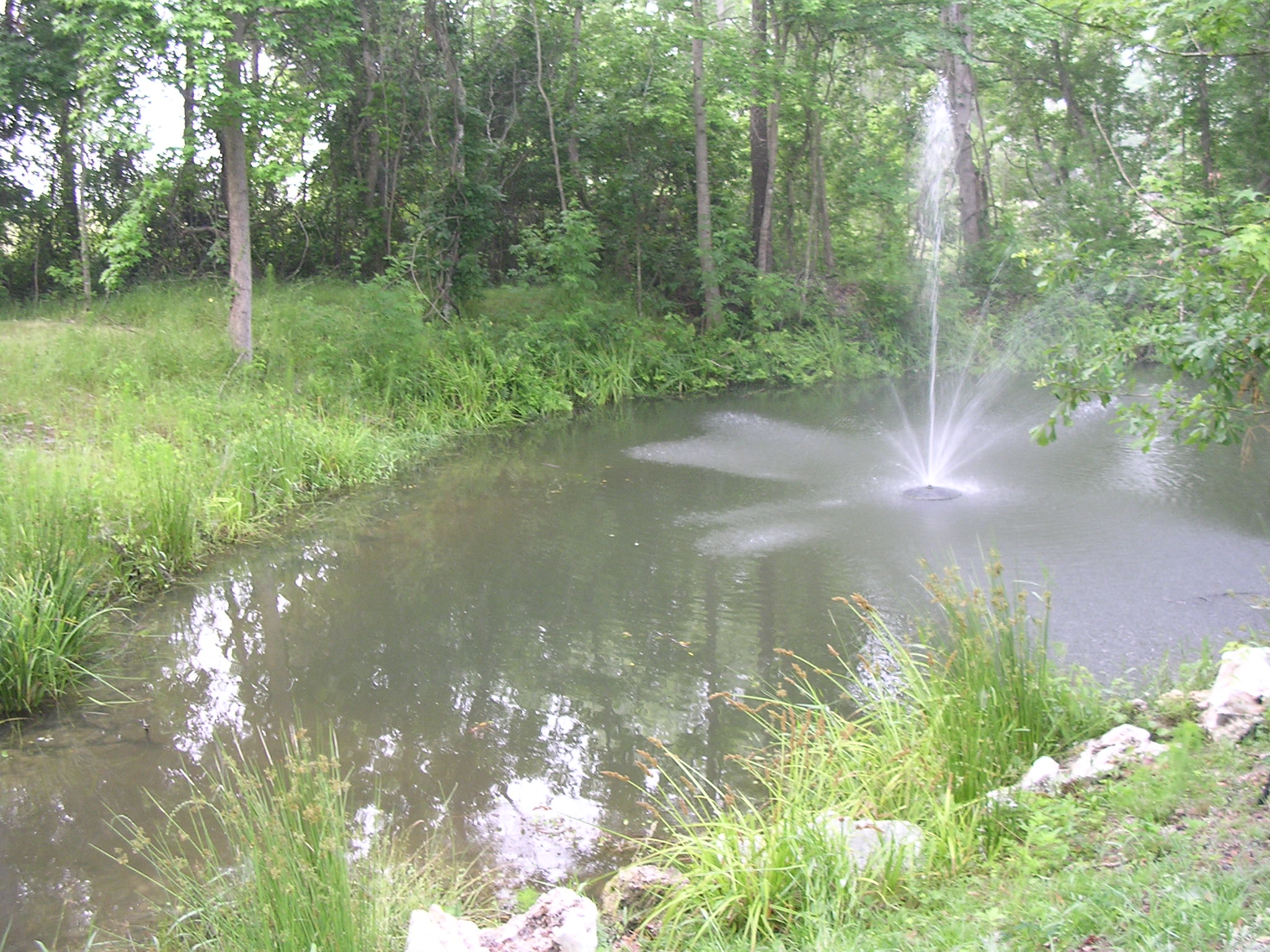

Here is a picture of the other spring pond on my property that is clearded.

   / Clearing a lake? #8
I would do the rake idea to get the bulk of it then fish friendly herbicide.

Do you guys have Roundup Biactive over there? Its approved for use in sensitive environments such as dams, rivers and streams here in australia.
Its safe for fish/frogs etc and is effective in killing many aquatic weeds.
Another brand we have is Weedmaster Duo, its also approved for aquatic use.
Don't use regular roundup (or any of the other glyphosate based herbicides). The regular ones use a surfactant that is harmfull to fish, frogs and crustaceans.
