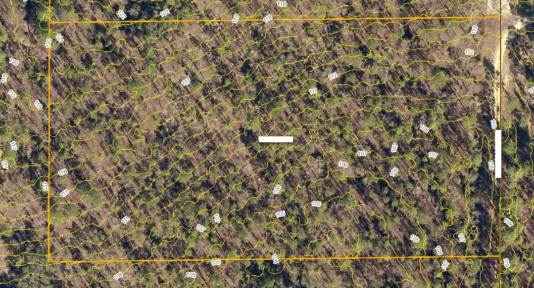

I had a bit of time to poke around before dinner...
Jason - your county has an online tool that is easy to use (it's the same one used where I live). There is some information there that might be useful to you in your planning (property boundaries, zoning, etc.) . If you can figure out how to take pictures on your phone/camera and upload them as attachments to a post on TBN you're computer literate enough to use it :)
Geocortex Viewer for HTML5
Here's the latest aerial/satellite photography of your property from 2017 overlaid with the land contours (labels in feet). So you can see a 16 foot elevation difference between the northwest corner and southeast corners of your property. Not much else to see in the aerial view except trees.
It used to be that if a property was shielded from the road by trees or something else that people couldn't really know what you were up to. That has all changed with detailed aerial/satellite photography available to everyone, including the folks setting our property taxes. Forget putting up a building without a permit - the view of our property is so detailed I can see the BBQ on the back deck of our house.
Chris
Chris
