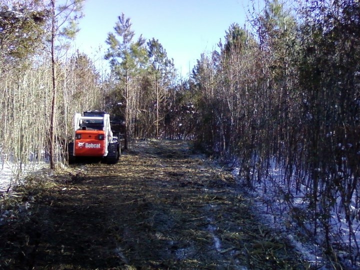

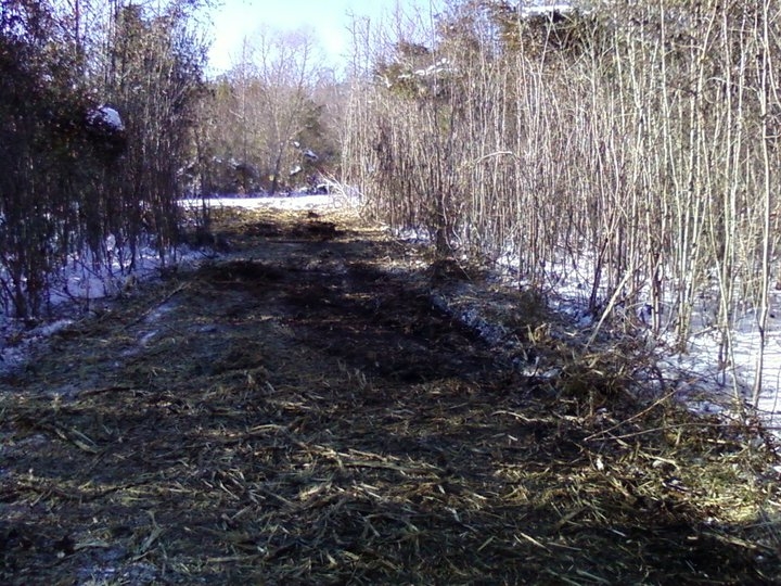

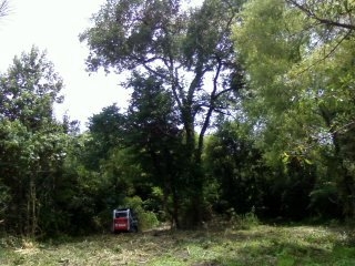

All stated thoughts are good. I decided to rent a Bobcat Forestry Cutter and do it myself after hiring a mulcher.
I rent one as budget alllows and it does a great job plus fun. A Fecon would be better, but too expensive for me. We have 113 acres of which 80 or so is thick woods/saplings. After the mulcher, I maintain through the year with JD 3320 pulling an MX5 mower. I do not even see the stumps and the ground gets better each cut (MX5) due to the mulch.
Here are (hopefully) three photos.

I realize you are not in Texas but what kind of rates are you getting for your forestry cutter rental? Seems like a solid option for some areas of my land but everything I have been seeing around SE Texas is high.
Looks like you are making good progress!

Mike,
What caused me to rent and do it myself was the cost when I had someone else do it. The guy was good, but I could get more if I did it.
* The hired guy cost $1,500 per acre plus $600 to move the equipment to site. He did five acres and did a good job.
* However; I could rent a Bobcat for $900 per eight hours or $2300 for 40 hours. I could do several acres for $900 once I got use to it, which was on the first rental.
I also only rent when tied to a weekend or holiday, so I do not have to let them have the Bobcat back until after two to four days if on an eight hour rental as they are closed on weekends and holidays.
They give me a break or extra hours/day if there is a mechanical issue that prevents me from using it.
This also helped me on taxes. A buddy of mine in Arcadia, OK wanted to rent one to cut his boundary, but the closest was Abiline, TX. Their cost was less than mine.
I am renting over the Thanksgiving holiday to try to cut a boundary and green trail (for deer/turkey) on our West side 2800 feet x 10 foot wide to the river. I clear up to large trees and then go around them as I want to keep them.
This mulching helps with environmetal issues as no roots are removed thus I do not get in trouble with the NRSC or Corp of Eng as I near the river. Nor do I devert any water as the trucks leave no footprint (per se) and I am not "blading anything" which a dozer or FEL would do.
The mulcher cuts to the ground leaving noting to harm the JD wheels or impede the MX5.
Best to you.
Jim

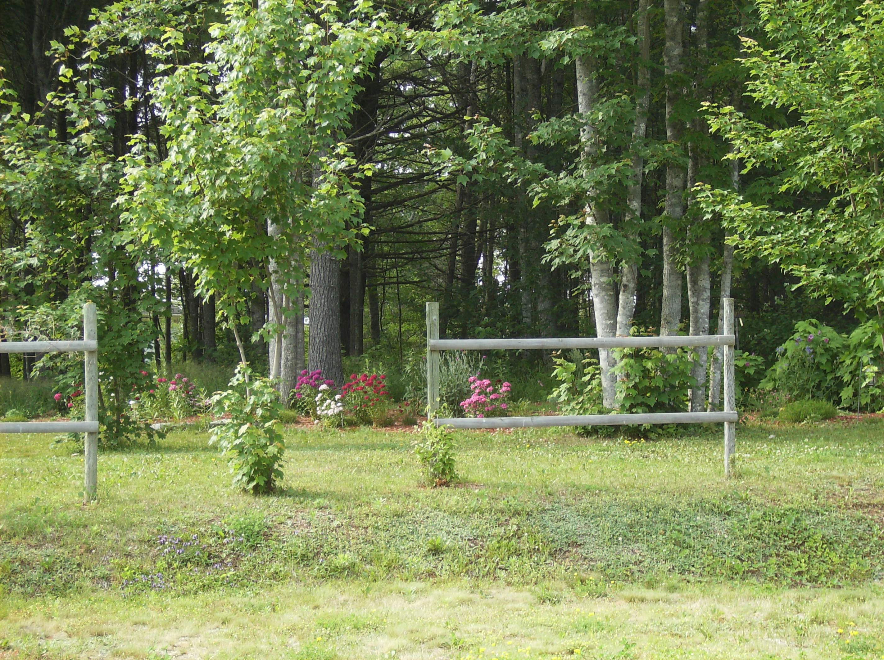

Wish you better luck than I had, once we cleared all but the trees we wanted for the lot before building, within two or three years we lost some to winds, either snapping in half or uprooting themselves entirely. Not particularly strong winds either, but once they were no longer protected by surrounding trees the exposure to weather proved too much for some of them.
The first pic is where we decided to clear cut and replant where we wanted them for landscaping, mature trees (maples / oaks) in the background, can make a nice balance.
Row of spruce to the left of the birch were planted 8 years ago, approx 2 feet tall. Are now 15-16 feet.
