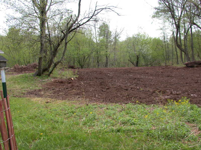

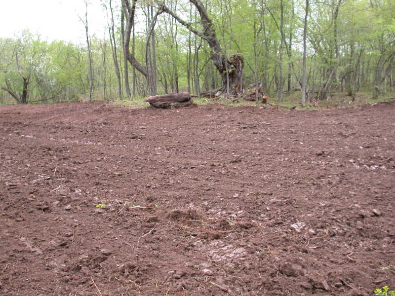

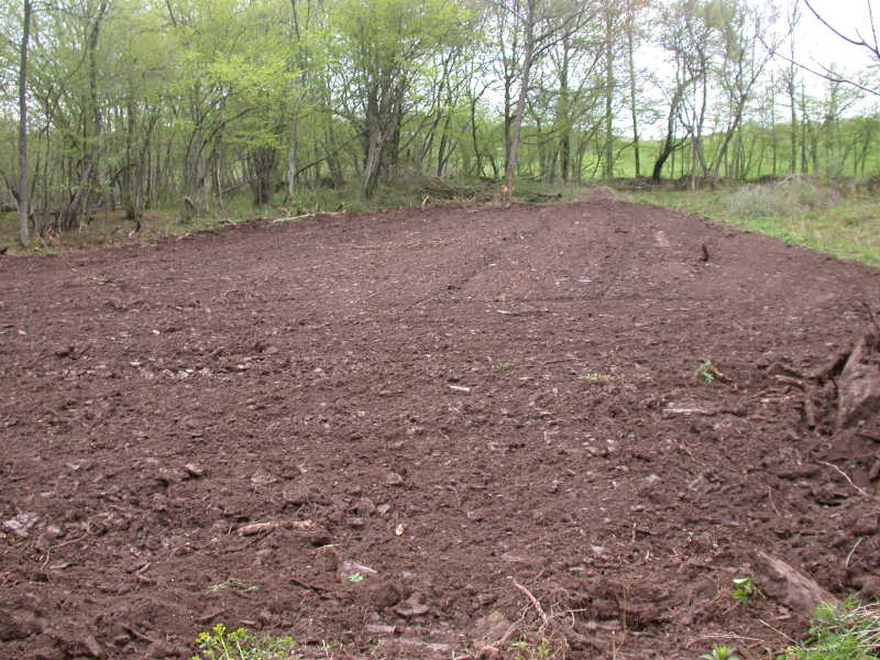

Hi,

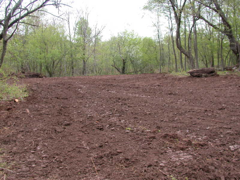

What I found is that my 2720 with a 46 BH could pull smaller trees out, say in the 6"to 8" range. Once I got to 10" trees it became a real chore and forget deep tap roots like Walnuts. I'm pretty experienced at pulling stumps and using the tractor.
My 3320 with the 485 BH is much quicker but it's got a lot more digging power. Either way if I have to pull 20 stumps in the 10" and above range I call my dozer guy. I like my land level and pulling all those stumps leaves things messy and the ground undulated. Let the dozer guy do the heavy work and do the lighter stuff yourself. The time will be greatly reduced and so will the wear and tear on your machine.
Here's a fruit orchard I made last year. You can see one of the large rocks in the picture. It's quite big although the picture doesn't show it. Way more than my 2720 could move and a chore for my 3320 too, but doable. The dozer guy moved it for me and saved me the work. He also leveled out the field. It's now all grass and mowed. Originally it was full of Hornbeam and Hawthorne in the 6" to 12" range. More than the 2720 could do in reasonable time. I think you can see where the dozer pushed the brush. All I had to do was move it over to my other field. Believe it or not I only had to take down one hardwood (Cherry) about 4" in diameter. Hornbeam can take over in some soils.

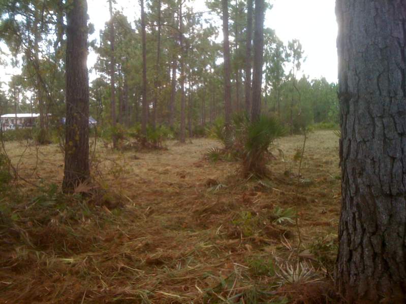

I tried a dozer...huge mistake..pushed off all the top soil.If you are going to hire out;use a bobcat with a forestry head(mulcher).I am in the process of doing 90 acres(long term job for sure) with my L4240,grapple,tooth-bar and brush-hog.Chain saw the larger stuff.We are leaving the mature trees that we want,trimming the apple trees etc,using the junk trees for firewood.
Plow or boxblade the open areas and plant buck-wheat.(buck-wheat kills the brush root systems and adds nitrogen to the soil.
we have hired out to one of these machines a couple times. They work wonders will not disturb top soil, and you can flag any trees you want to keep.

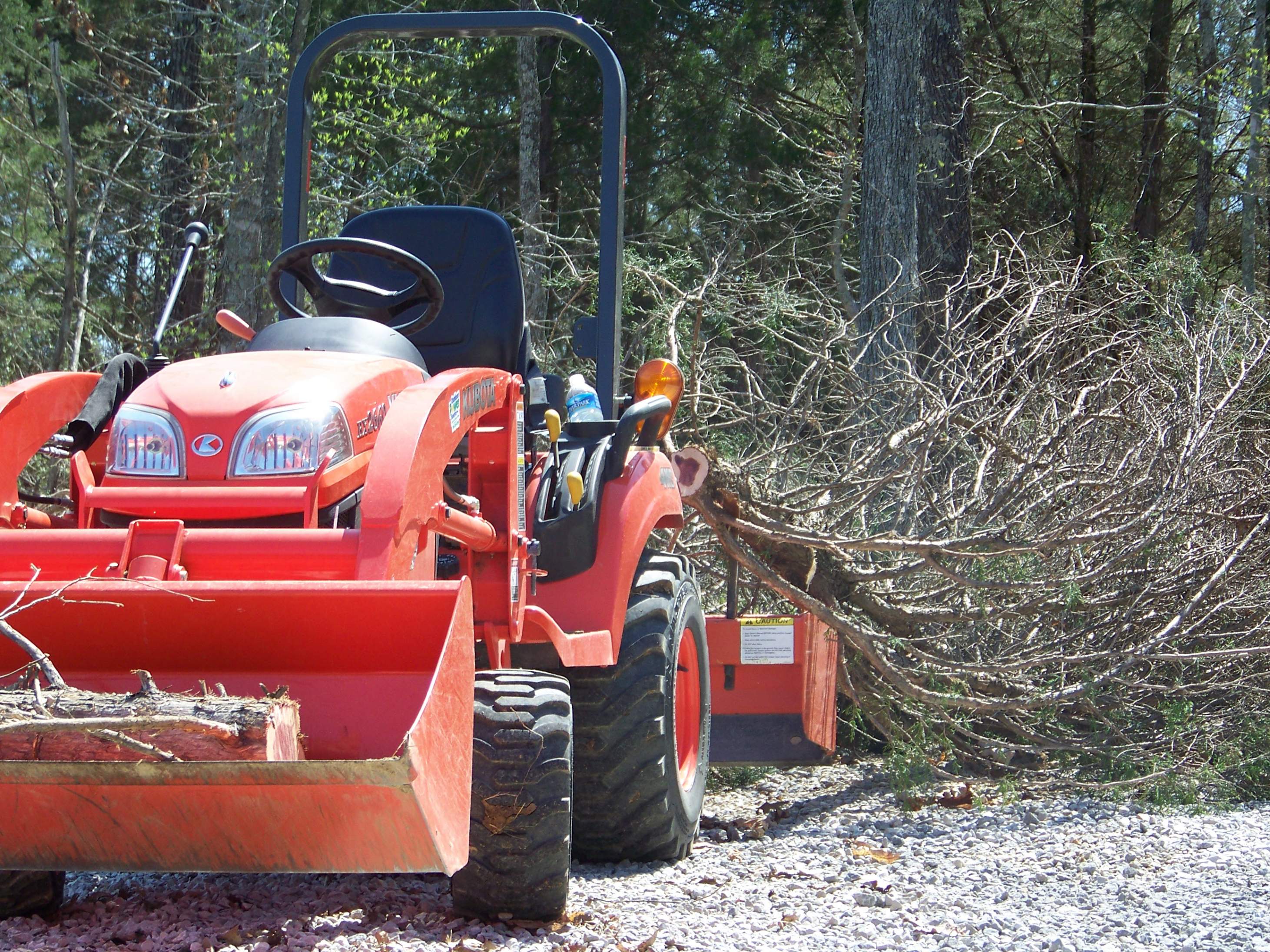

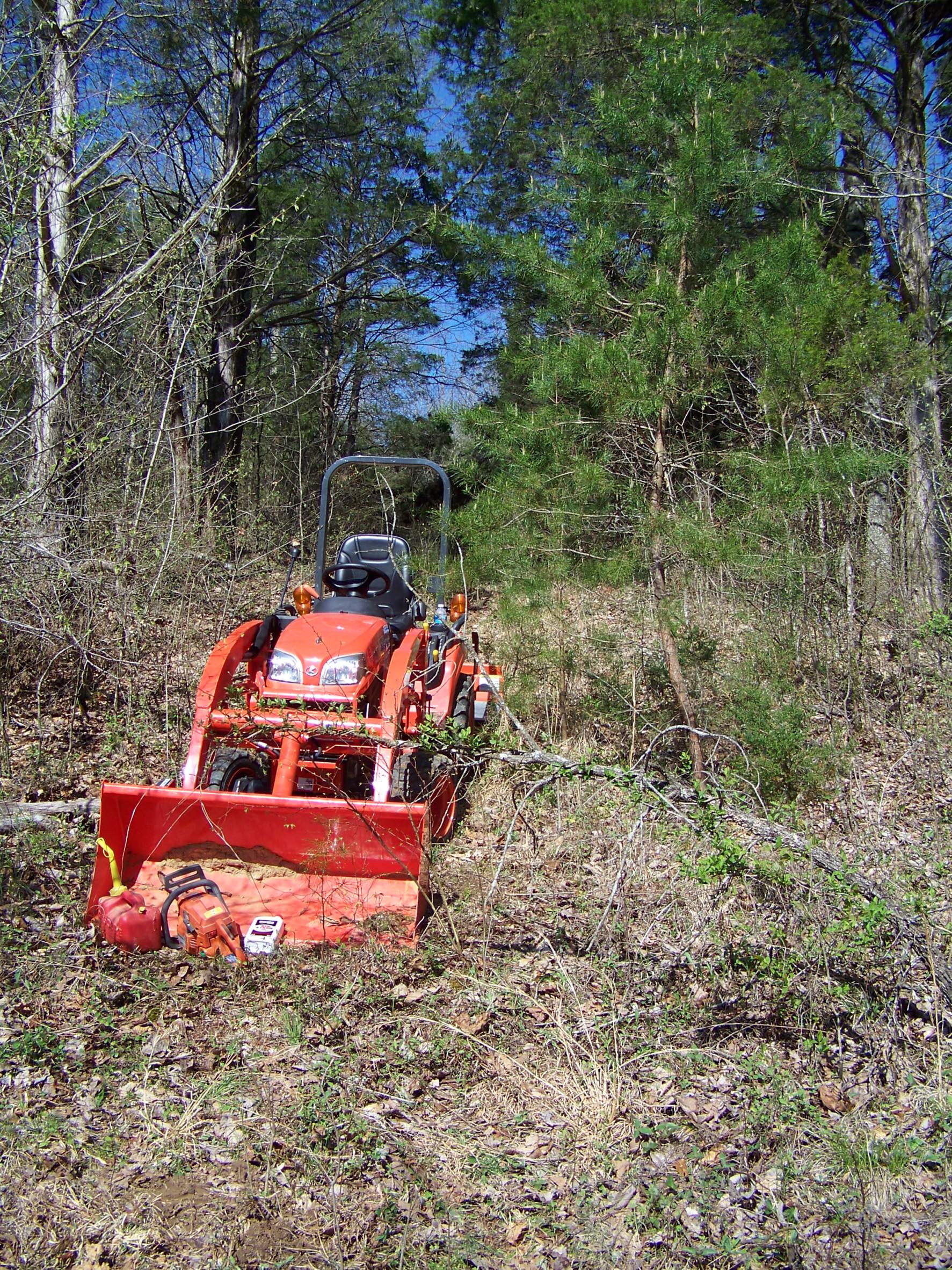

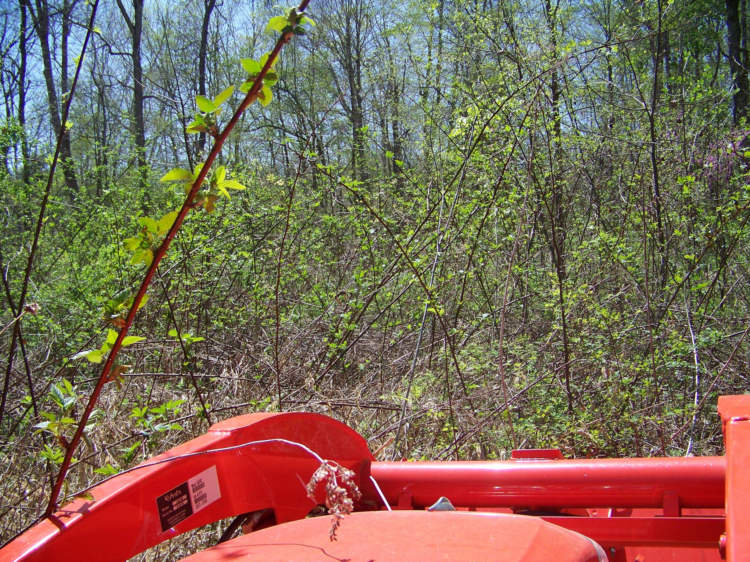

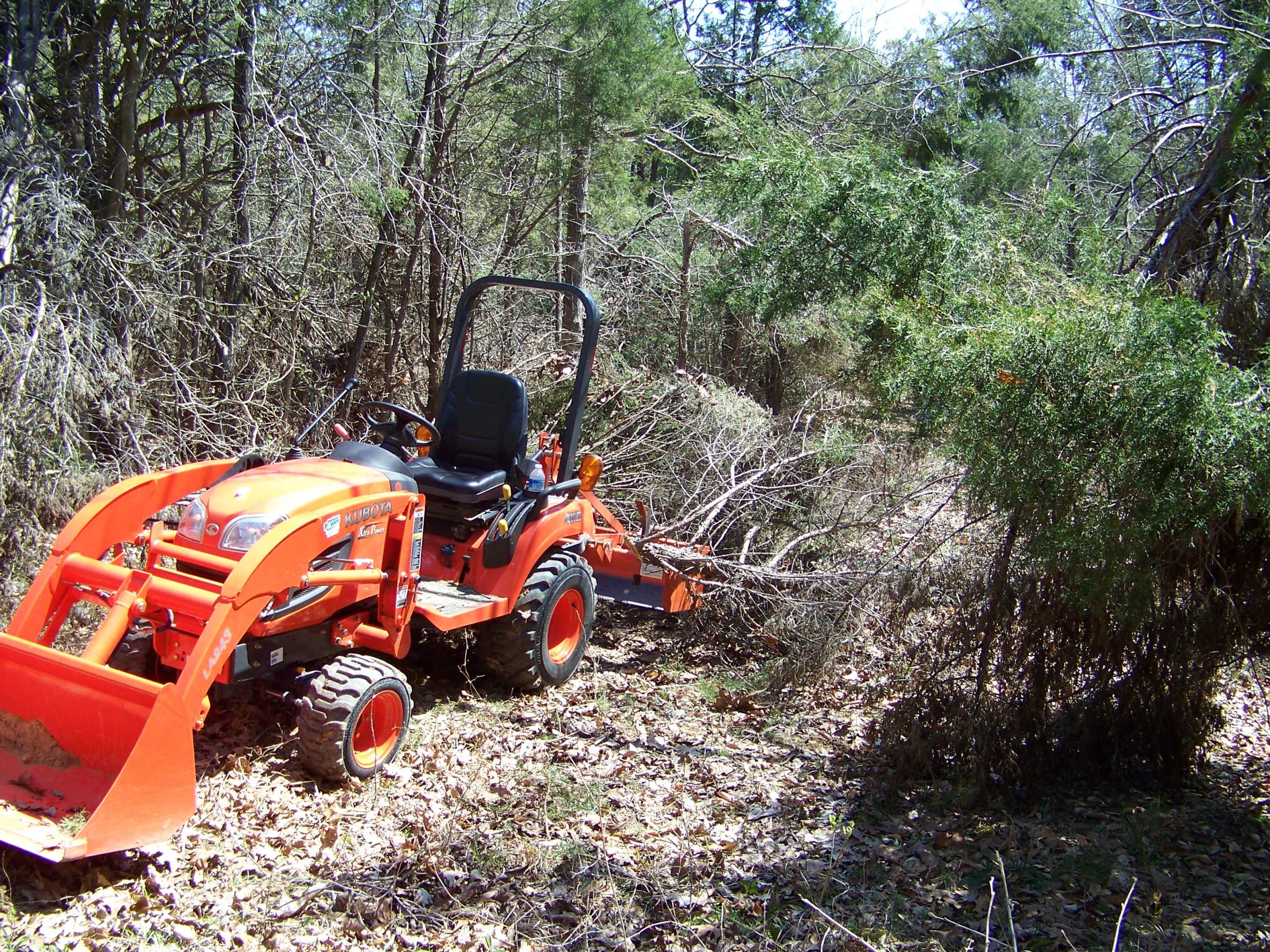

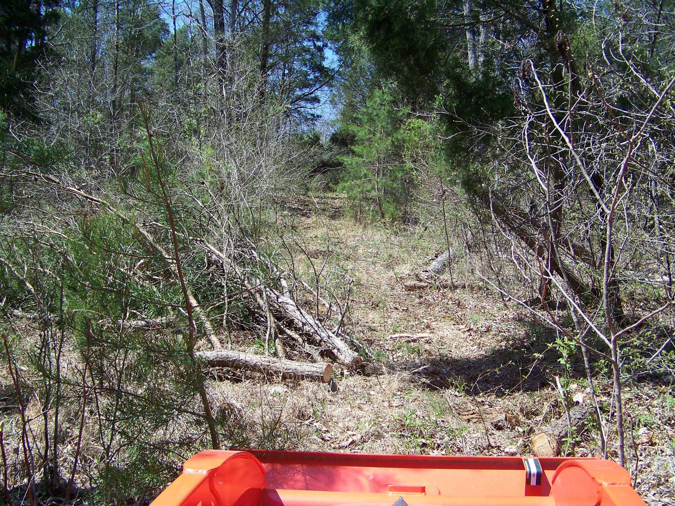

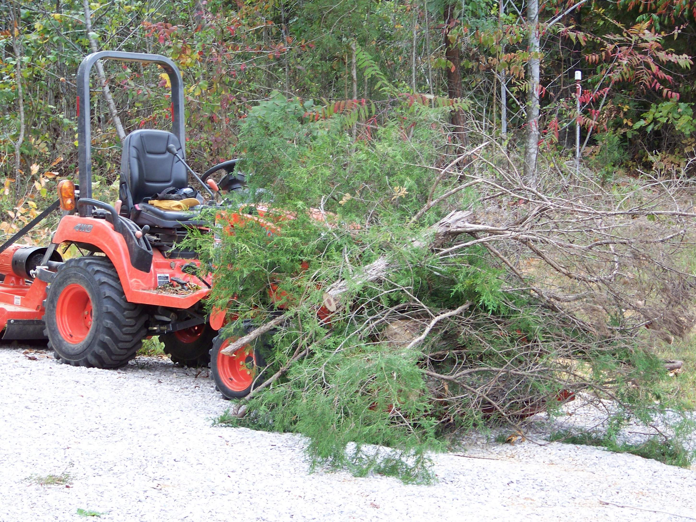

I haven't read all the post, but in the last month, I've cleared 1 acre (thick pine trees, some hardwoods and devil inspired vines) with my little BX25, a Kawasaki 4x4 and a chainsaw. All done after work, a couple hours at a time.
I use the BX for knocking the smaller trees down and digging up by the roots with the back hoe. The larger trees are cut with the c/s. I use the four wheeler to drag as many as 5 trees away to my dumping point at the other end of the property.
It's amazing how that little back hoe will dig up a stump in minutes.
I got an estimate of 5k to "manicure" my land. That was all it took to decide to buy the BX and do it myself. I figured once the land was manicured, I still had to maintain it, so I would of had to buy a tractor anyway...right?
This is NOT hard work by any means. It's FUN work.
I don't know about you guys, but my tractor is more fun than any toy I ever had.
