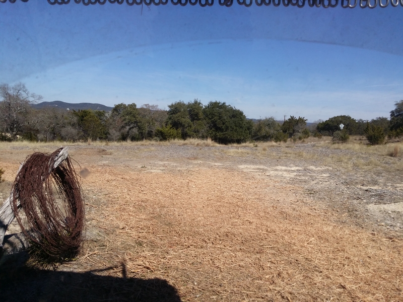

20140215_122300 (800x600).jpg20140215_130941 (800x600).jpgRed, I had a forester tell me that nothing will grow where mulchers have been. I disagreed! I have customers that tell me the same thing.. and opt for chipping. I use my property as an example and explain that it's the mulcher operator that makes the difference. It takes longer when big, coarse shreds are built up so thick that it smothers the ground. When the operator creates a place for the grasses to be protected and the shreds compost and add ground cover, the grasses can come back quicker. You do need sunshine and some rain but mostly, grass seeds are already present and probably dormant. Good mulching creates places for birds and mammals to deposit more seeds as well as a place for runoff to deposit seed.
I reclaimed a caliche pit and keep adding layers of shreds to build the area up. I do it in thin layers so my existing grasses aren't smothered. A few years ago there was nothing there..a moonscape. I now have to mow that area after it goes to seed.
