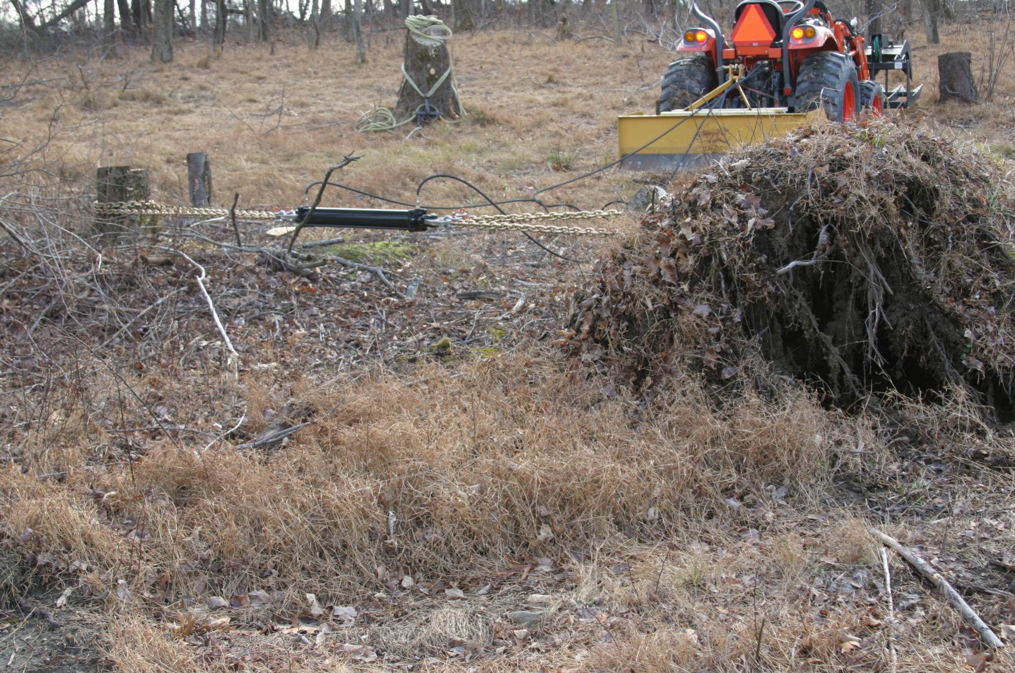

This is how I've been doing it lately. The cylinder pulls with 29,000 lbs. of force.
I really like this idea. :thumbsup:
   / Clearing rocks and stumps #29
WOWWOWOWW that is a really awesome idea! have you run into any stumps it couldn't pull? what kind of trees, and sizes have you been pulling over like that Jake?
   / Clearing rocks and stumps #30
I just got that going and the frost arrived, so it's only pulled about four stumps so far. I think the type of dirt makes a bigger difference than the size of the stump. I have sort of an upland swamp with springs situation. Mostly clay.
