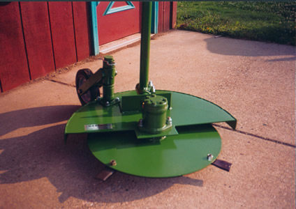

My Dad had one of these David Bradleys with one of these brush and tree saws, plow, discs, cultivators, front mounted reel lawn mower, front mount sickle bar mower and home made snowplow. We used it for many years with good results. I remember trying the brush saw only once and that it did the job but tried to kick sideways. You obviously had to watch for dirt and stones.
Here's a link to the site. David Bradley tractors at work
