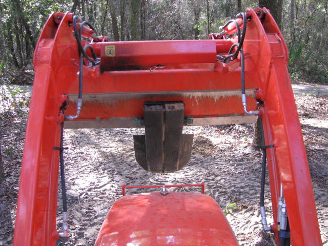

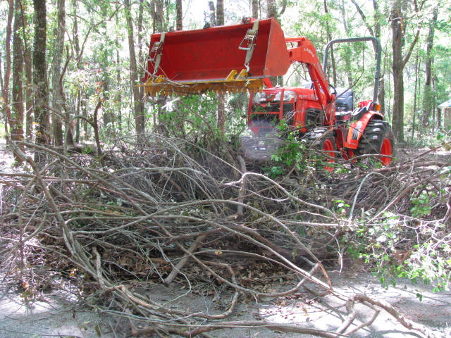

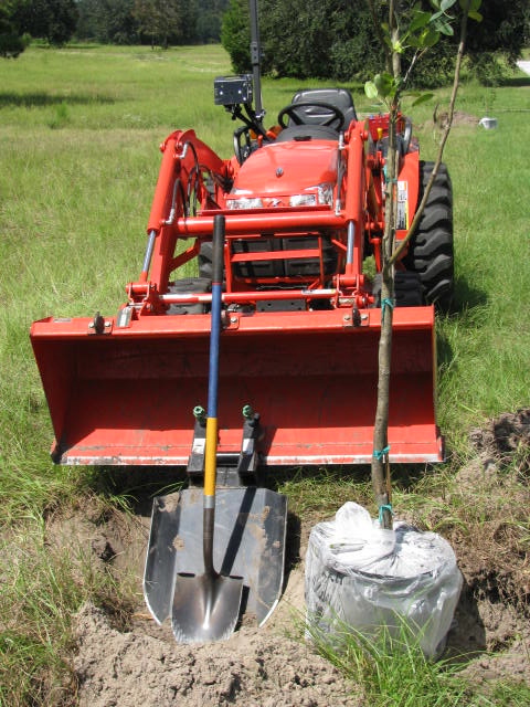

Wait until after a good rain before going after the roots.
I recommend a Ratchet Rake for your bucket for pulling out the roots. A great tool for $300. Available from T-B-N store and most Tractor Supply stores.
Softwood roots will likely come out of moist soil easily.
Hardwoods, especially oaks, may be difficult by the time they reach 2", but you can spray the hardwood roots with Roundup/Glycophosphate 2-3 times, with a week between applications, then drag them out with a Ratchet Rake after a couple of months. When dead, root clumps "release" in a couple months, at least in Florida.
An L3940 is about the ideal weight tractor for a $400 bucket spade to function optimally, however I think a Ratchet Rake will handle your tasks.....in moist soil.
I would recommend against using your tiller. Not the correct tool.
I have a Ratchet Rake and a heavy rollover box blade. For what you want to do the Ratchet Rake will be effective, the box blade marginal. For an acre it would be worthwhile to buy the RR. A Ratchet Rake will also pile up your roots for burning.

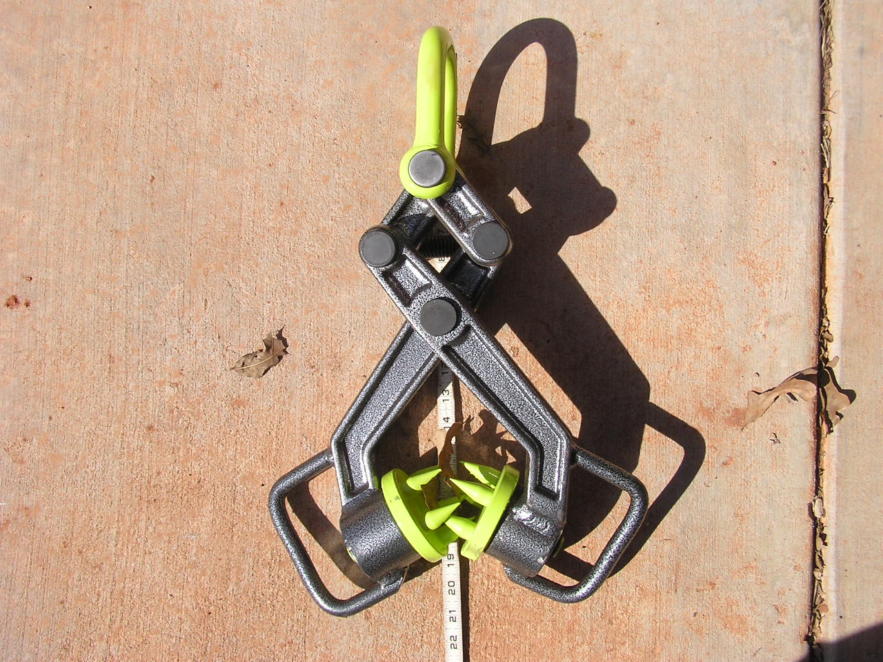

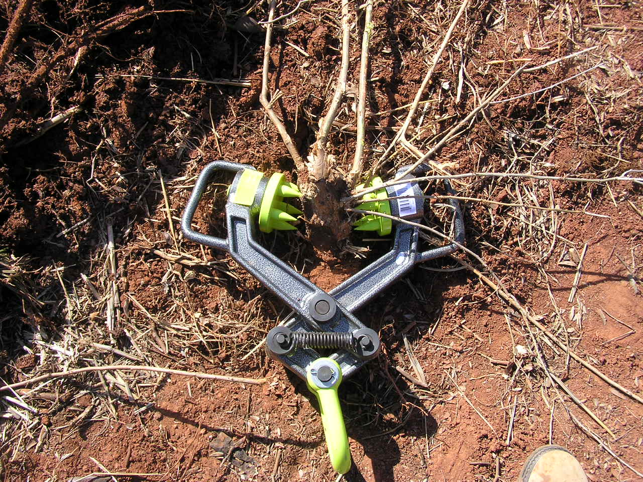

You might want to consider a BrushGrubber | Home. I have a middle sized one and a big one. Works best with a helper to take it on and off while you remain in the tractor seat.
My experience with my RatchetRake is that it works better smoothing out dirt and gravel than it does removing small trees and bushes.
/ Clearing small trees #10

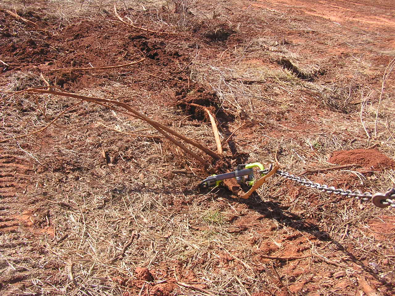

I also have the big Xtreme Plus, 35 pound one, it is stronger than I am! :laughing: It works great on roots or short stumps that are hard to get a chain on.
Right click the pictures to open in a new tab.
Be sure to carry a prybar to get it off the root, notice how far the teeth are sunk in.
