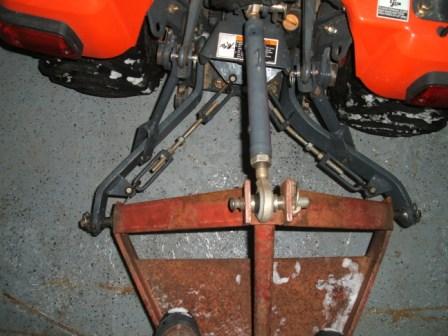

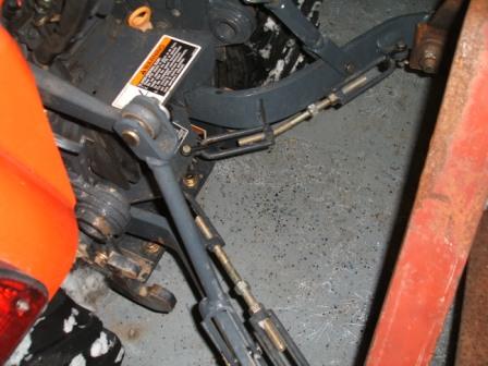

Anything can be bent. Plowing in reverse with the blade turned around and I found an immovable object. First photo, bent turnbuckle, second looking down from the rear, bent right lower arm, third, both arms next to each other. My fault, not Kubota's. I will get it straightened and go on with life.

I wish I had pictures of my tractor when I did that to mine. My lower arm bent the same way and the adjustment link actually broke I bent it that bad. I was actually disapointed at the damage that came from hitting the object.

Tommy V, It's amazing how much this looks like what I did to my lower arm pushing a blade into an ice packed snowbank a couple of weeks ago. I didn't bend the arm quite as bad, but did break the turnbuckle. I was able to weld that back pretty quickly and the lower control arm is still useable. I had not been hitting the banks with great force and have been doing this for a few years. The tractor may swing the front a little, but that was o.k. with me...it was never a violent front end swing or anything like that. I almost exclusively push the blade in reverse for snow removal and will straighten the arm this summer....if summer ever gets to Maine that is, and am considering reinforcing the arm somehow.
Do you have any concerns about the arm being weaker after straightening it or, if reinforced, do you think there is greater potential to do damage someplace more critical and harder to fix than the arm itself. So far, my plan is to go slow, stay paranoid, and keep fingers crossed...do you have any solutions for allowing minor give? Dyer, retired

Pretty sure the arms are engineered to be weak enough to bend in the event of a impact with something that does not want to move. I would not reinforce them. You will end up breaking something very expensive!!! I bet the rear housing on your tractor is at least $2000.00, plus several hours labor to replace it.

I've kind of arrived at that same conclusion and will just be more careful with the back blading. I think the problem was that I got away with doing it wrong for so long that I felt comfortable that nothing was going to get hurt in it all. I really thought I had been the lower arm worse than I had. It did bend, but not as bad as yours and was just twisted on the pivot shaft balls. I've got it back up and working, but will just go slower....I'm doing o.k., but don't really want to spend $2000 (probably conservative guess) for something that could have been avoided. Plus, they tell us that winter is going to end here by August! Dyer, retired

Sorry about that, but my 9:26 response to TommyV was meant for you. I agree with not taking the chance of reinforcing something that will break the more expensive item later. Dyer, retired
