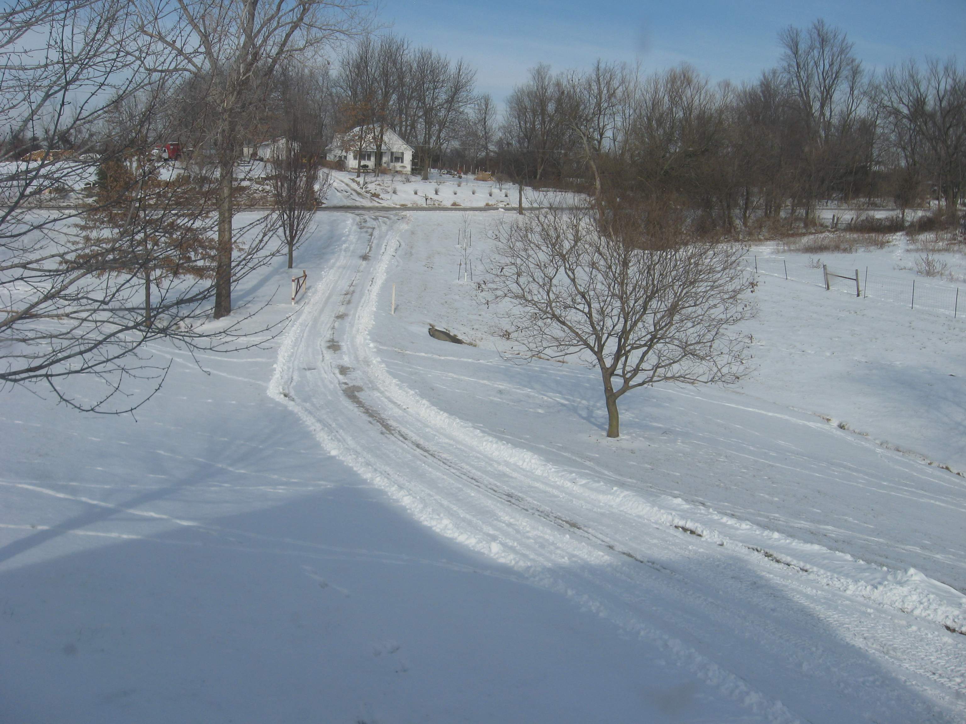

For 40 years, I was used to clearing snow off paved driveways with a lawn tractor with front blade and walk-behind blower. Then, when we moved "out", we got 400 feet of gravel drive with a couple of concrete pads thrown in, and a compact tractor. I bought a front blade and blower for the tractor (JD 2520) because that's what I thought would work best. However, I have not been able to keep them from digging into the gravel.
This year, I tried something different. I tried just pushing the snow down the middle of the drive with the loader bucket in "float" and the cutting edge tilted up about an inch. This worked beautifully! The bucket rides along on the "heel" and doesn't dig in.
After the first pass down the middle with the bucket, I make another pass down each side with the rear blade angled to push the remaining snow off the sides. I have a pair of gauge wheels on the rear blade that keep it from digging in. My rear blade also pivots on the vertical axis which helps it follow the contours of the drive.
So, as much as I hate to admit it (because I have a dedicated front blade and blower) I really think the FEL and rear blade are the best tools for most snow removal situations at my place. I will use the blower for the really deep snows, but they don't happen very often. Looks like the simple solution was the best in this case....
