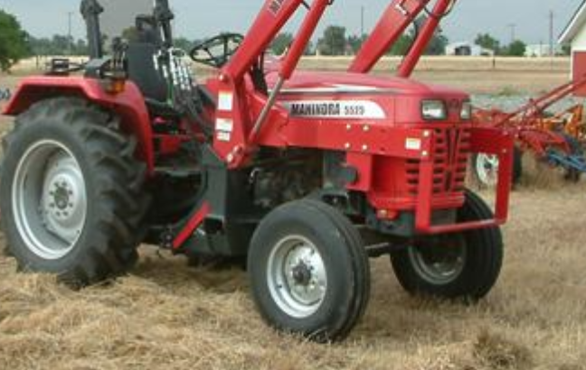

Never had a radiator clogging problem with my 2008 Mahindra 5525.
The radiator itself is enclosed by the hood on top, the battery tray structure on the bottom, and the nose of the tractor that carries a screen that keeps crap off the radiator. It's a lot easier to clean that nose screen in the field than to clean the radiator air passages. One of the things Mahindra got right on the 5525.
Good luck
