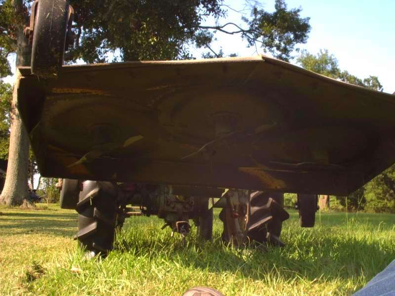

Hi,
By chance I stumbled on a Customization to my 60" KK Rear Finish Mower that seems to have done more than expected. I have not yet read of anyone else doing this so I thought I would share my results.
What I did was to Remove ALL of the Blade Baffles underneath the cutting deck. This was done to help the blades from Choking when I ran into Tall, Thick grass, which it does tremendously help. To my surprise after a day of cutting and looking underneath the deck, I found almost NO areas of compressed grass clippings and areas of the steel are polished, Freaking Clean.
I know questions are was the Cut Quality diminished, not noticeable to me. Actually I think the cut is better. I decided to clip the lawn very close after the customization, performance was improved, but choking was a problem because of the excessively thick and tall growth. I had to take it slow for that pass.
I can post AFTER pictures if if requested. Pretty easy modification if a cutting torch is in your shop. Also I should state that if you are not an adventurist Do Not Try It. Results here surprised me so I thought to share.

The purpose of the baffles is to collect the clippings and discharge them out to the side. With no baffles, the clippings will probably just lay down where cut, and when cutting tall stuff, it may clog, just like when the chute on the mower deck gets clogged up. But if it works, go for it. You can put them back in later if you have to.

The underneath picture shown is after about 5 acres of clipping, with no cleaning done. The deck has never been pressure washed, only scraped prior to removing the baffles.
Sorry, I should have taken a few pix with the flash on. Will do next shots when clipping after/during rain field tests can be done.

Hey Rhett, is this mower still working good for you. You said that your mower was always a rear discharge mower. Do all three blades turn the same direction?
   / Clogging Finish Mower
Howdie AndyG,
Yes working great, bought the KK 5' Rear Discharge new and yes the blades turn the same direction (counter clockwise).
No baffles has been a great help by not straining my 16 hp pto frequently. If I get into really thick stuff the clippings will still collect on one side (drivers left) and stall my tractor. While cutting thick stuff in reverse the problem is not near as bad, I guess the clippings do not bunch up as much at the blade tips because of more room for them to sling.
I am still looking for other things to try other than buying a larger tractor or cutting so frequently. One day I will probably give the Meg-Mo System a try, kinda pricey to test though, $210 for a set for my mower. Even further down the road I might try extending the left deck side out by 6" to see if that helps. I would like to be able to cut in 4th gear / high range, the 12 plus hours of seat time per cut is getting old. Oh well
