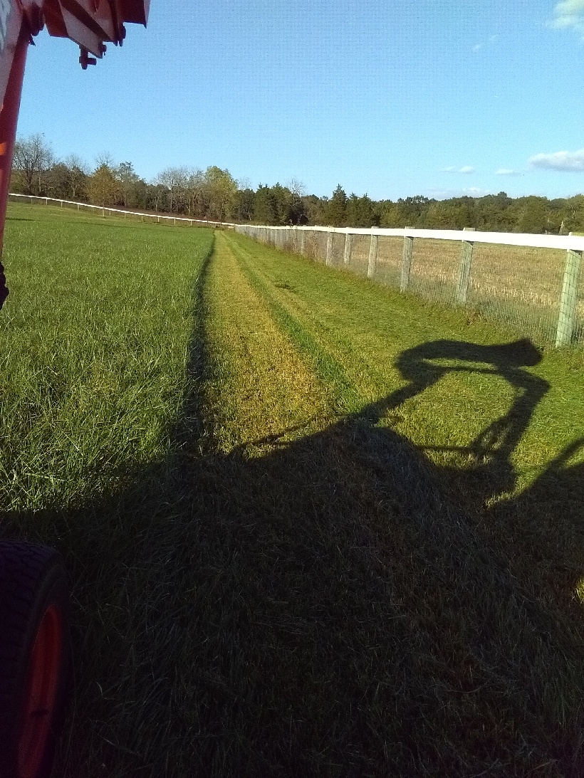

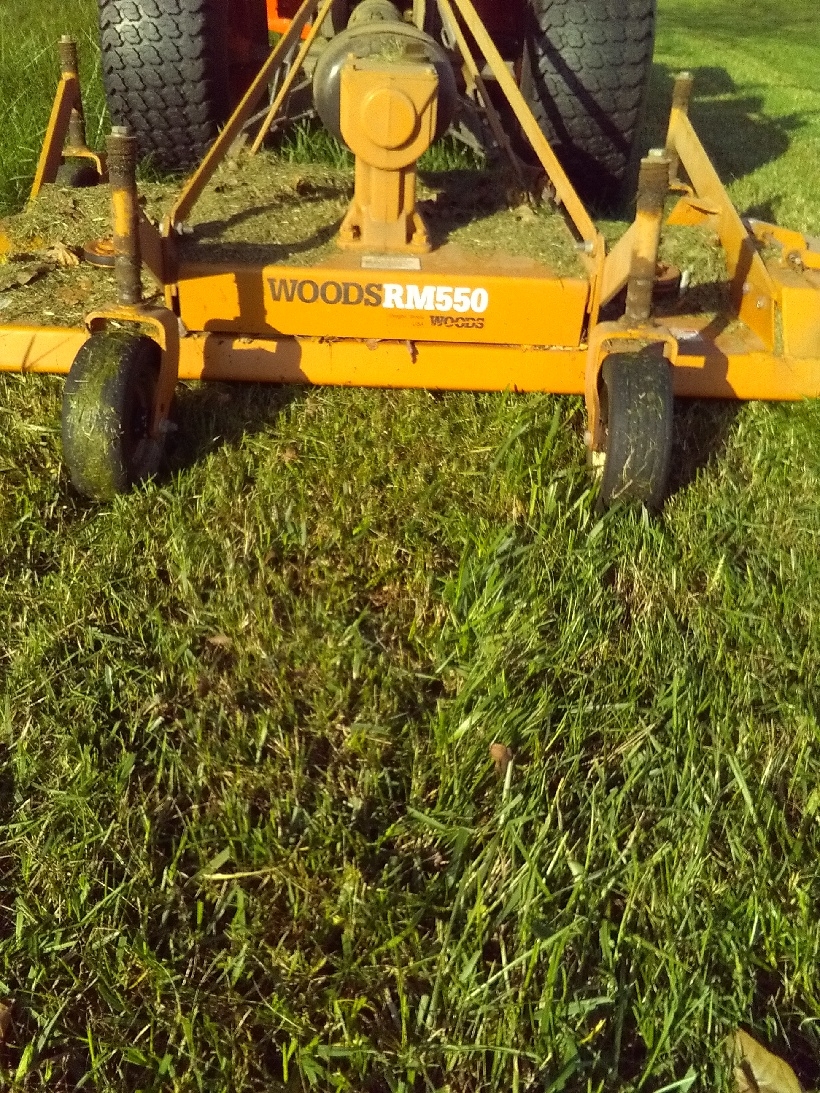

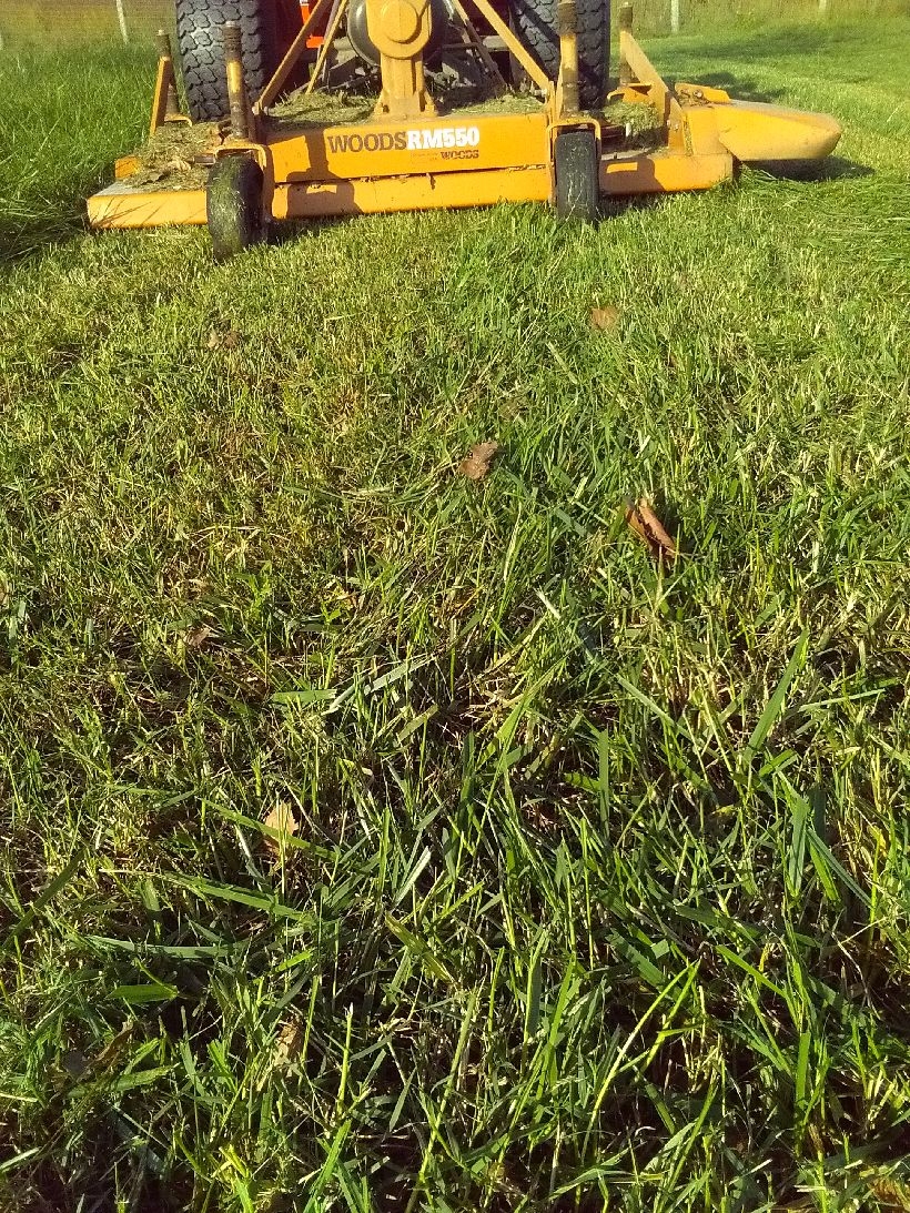

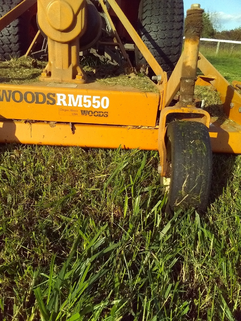

Good afternoon,
I have a Woods RM550 finish mower that has started mowing poorly (see attached pictures). I know the grass is pretty long in the pictures, but I used to be able to mow this height of grass at a pretty fast speed and it wouldn't miss a blade.
All the wheels are set at the same height (4" cut I believe), the blades are OEM part number 18881 and installed correctly, the belt is OEM, I'm mowing at 540 PTO and traveling at a reasonable speed. It was looking like the grass was getting pressed down by the tires and not getting sucked up so I tried OEM 34615KT high suction blades and then some aftermarket super suction blades and that didn't help; might have been worse actually.
It mows poorly even on shorter grass and only does better if I move at a complete crawl. But again, this thing used to tackle tall grass at a good speed and not miss anything. The mower runs smooth, it's not bogging down, spindles seem fine, doesn't have any obvious damage to the baffles, etc. I've had two different tractor repair guys look at it and they couldn't find anything wrong with it.
Any ideas on what could be causing this?

That's pretty dramatic. You've tried different blades, so in my mind that leaves something is going on with the right spindle height or rotation.
Can you post some photos of the underside, and take some blade height measurements?
/ Woods Finish Mower Issue #3
Looks like you are mowing extremely tall grass, like more than 10" down to 4". I'm amazed it's doing that well. How does it do on shorter grass?
Kind of looks like it might be a belt tension issue that is letting the right spindle slip or something.
Have you made any changes to rig before it started missing the grass?

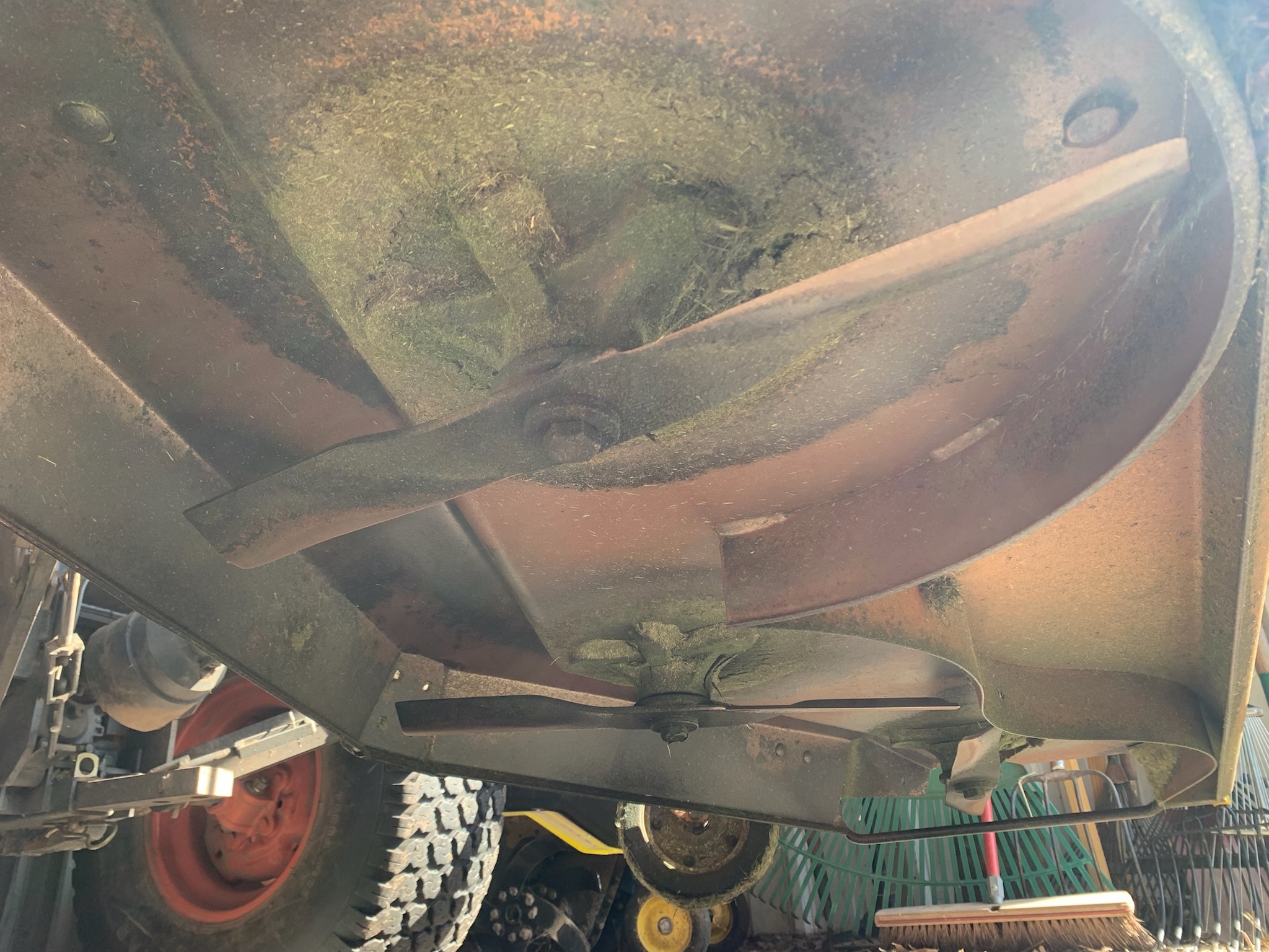

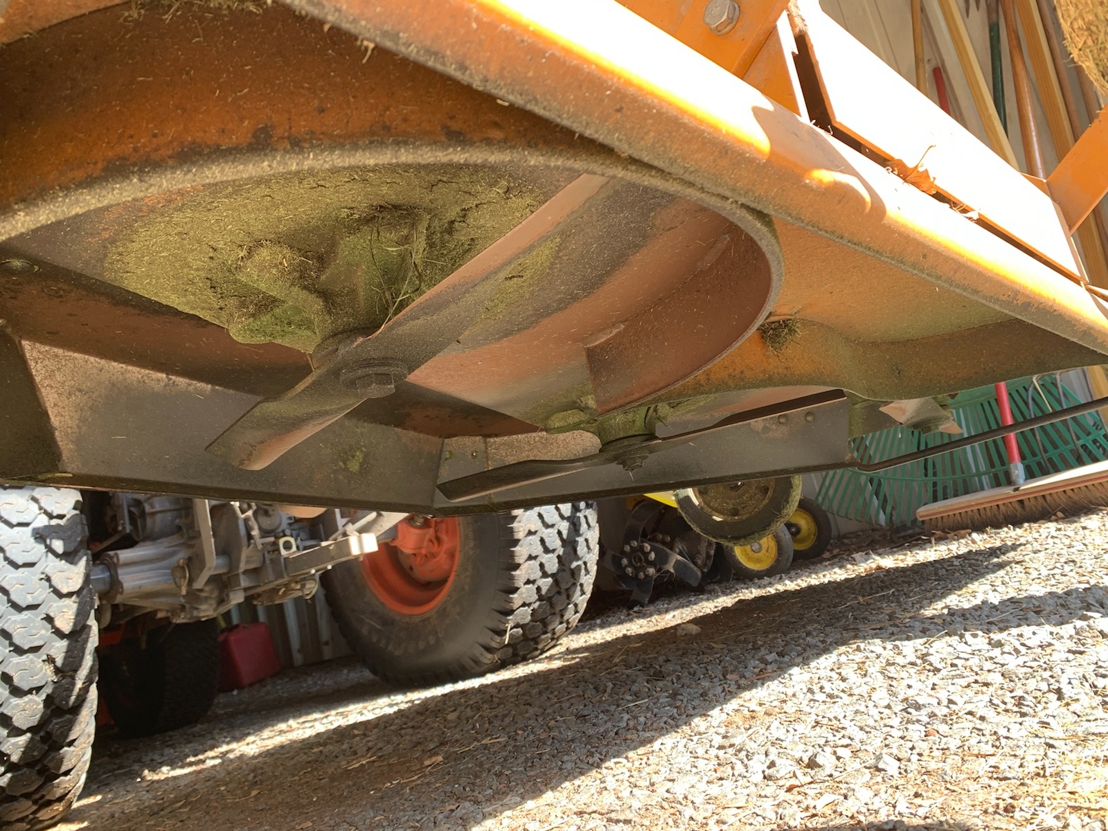

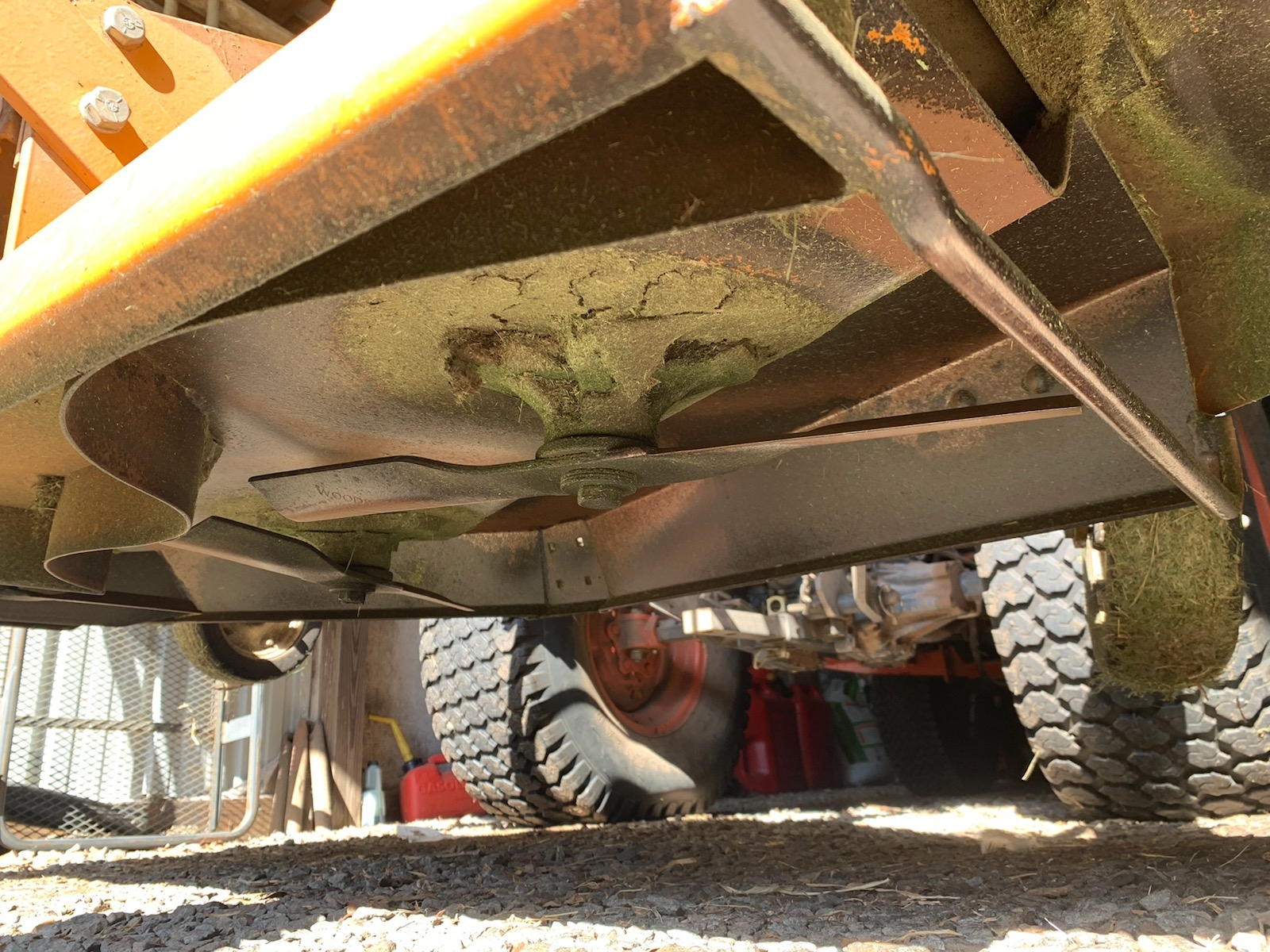

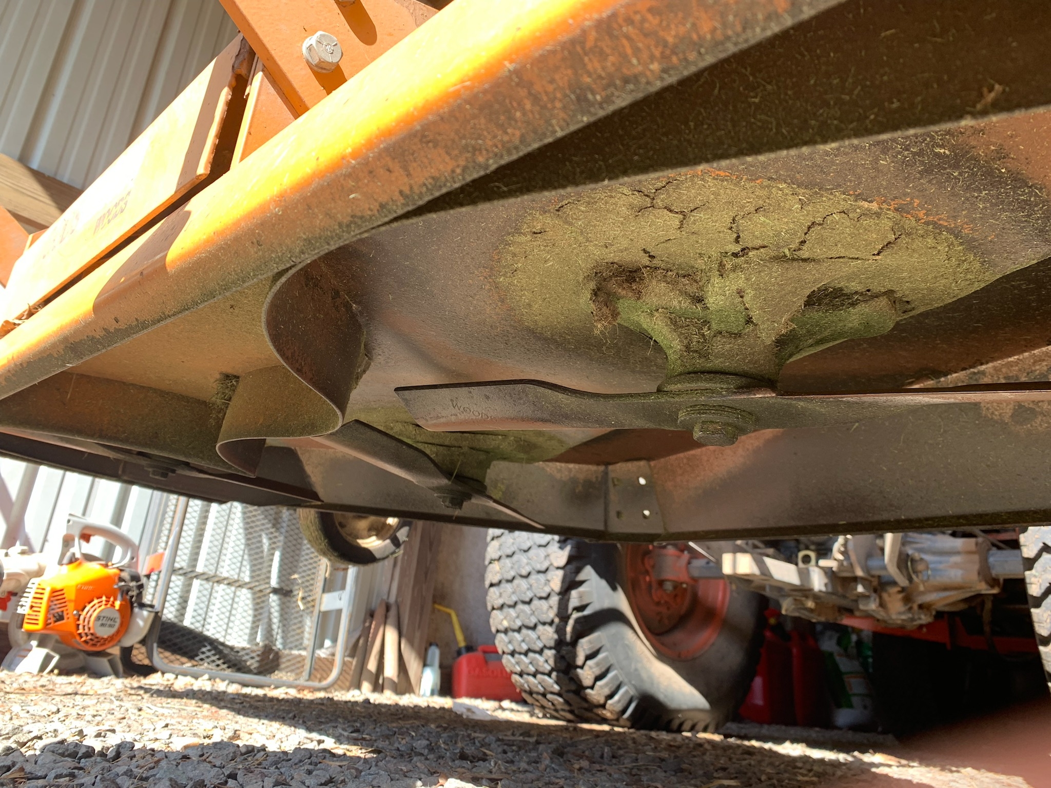

Thank you for the replies. Here are some pictures under the mower; I'll get some blade height measurements and deck height measurements and report back later.
Runner, it does okay on shorter grass but still misses if I move at a normal speed; the only time it cuts decent is if I go really really slow. Looks like it might be the forward swipe of the right blade not cutting. Not sure about belt tension or how I would check or adjust that but the belt seems to be in good shape; if it was slipping would the belt be wearing out? I do not have extensive experience working on this type of equipment.
This has been going on a couple seasons now; been trying different things over time and nothing has helped. I didn't change anything on the mower before this started - in the fall it was cutting fine, in the spring it started doing this. However, the first cut I did that spring was way too late and grass was about knee high and this is my only attachment so I had to mow with the 3pt adjusted so the front wheels were up a little bit. But I'm just mowing an all grass field and I didn't hit anything so I'm not sure what that could have messed up.

All the wheels are set at the same height and I measured the lowest part of the deck edge on all corners: Front Right is 3.5", Front Left is 3.25"; Back Right is 3.25", Back Left is 2.75". (right being the discharge side) On pavement, the right rear tire is just slightly off the ground.
Not sure I did this correctly but I measured the blades with them positioned front to back using the Oregon blade height measuring tool on a reasonably flat driveway; measured near the tip of the cutting edge:
Right Blade: 3 3/8" and 3 5/8"
Middle Blade: 3" and 3 1/8"
Left Blade: 3 1/2" and 3 1/4"
Does any of this look far enough off to be causing the issue I'm having?

Thanks for all the replies. The blades on there are Woods 18881 which are listed as medium suction 20 3/4" blades; tip to tip they measure a little shorter than that. Attached some pictures of how close they get to each other.
The left pulley is smaller than the center and right (discharge side) pulley. I marked the center and right pulley and mowed about 100' and afterward the marks were no longer aligned so that seems to indicate some slippage right? So maybe either a worn pulley or belt tension issue or maybe something internally broken in the spindle (it does run smooth)? Any guidance on checking belt tension or adjusting belt tension? Not sure what I'm looking for here and I don't see any information on checking or adjusting belt tension in the manual.
The section of grass it is missing is not the whole width of the right blade. Could slippage cause that right blade to cut okay on the outside backward swipe but not cut on the inside forward swipe?
