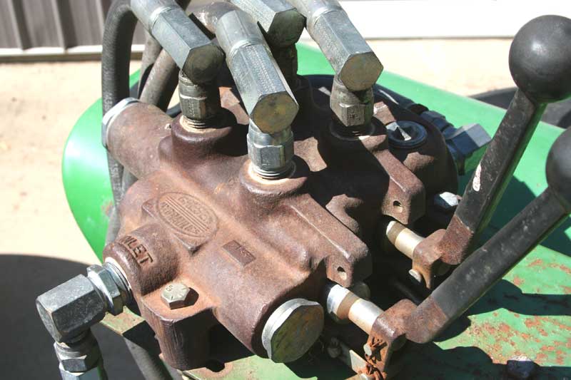

BHD,
I have a 2-spool valve bank on my right fender for the loader controls. I know I can add more spools to it but so far I haven't had a need for more. It would be nice to be able to use that valve bank for the pounder. The control on the dashboard is touchy.

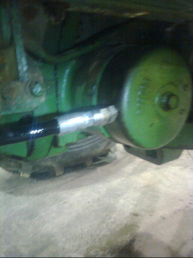

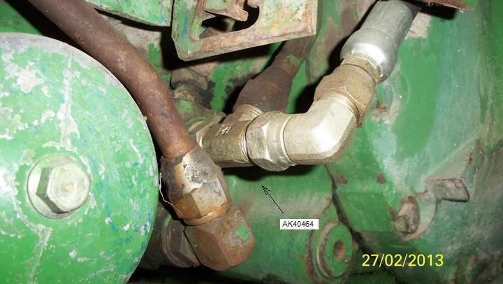

MNBobcat
From reading your other post in JD forum I determined your 3020 is a '64-'68 model which didn't have the option of PBY but could be plumbed by teeing into hyd supply line by brake valve and returning oil to ether rockshaft return line or ported hyd filter cover as shown in attached photos. Bypassing rear remotes(SCV) as shown in photos should give you better hyd operation without the need to tie remote lever to activate scv.
I think that has already been done when the control valve on the fender was added for the front end loader. I have the line coming off the hydraulic filter cover that you show in the first photo.
