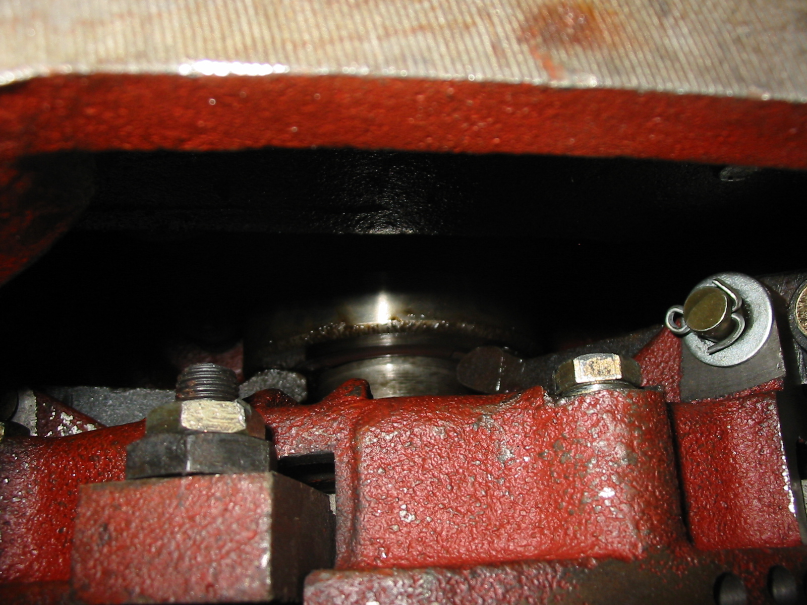

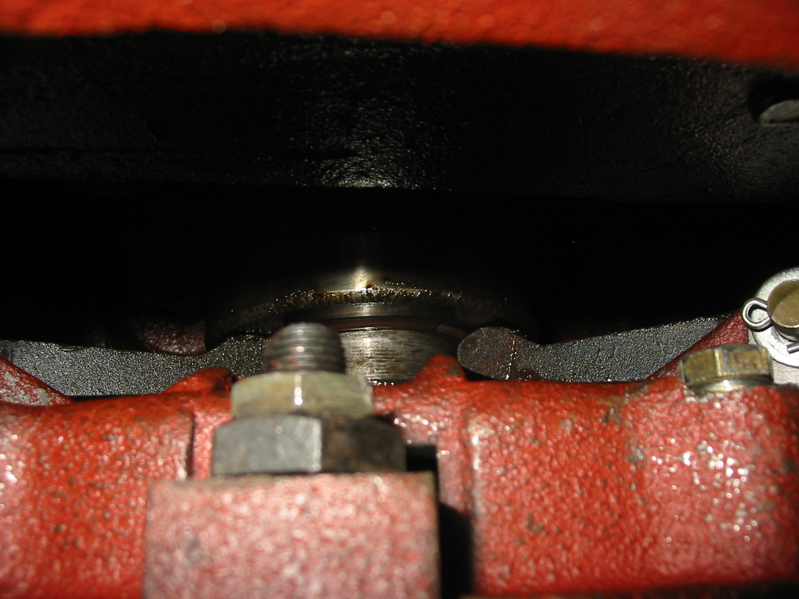

I've added a couple of pics with clutch disengaged and engaged, (respectively). Unless I am missing something, It appears to me that the PTO pressure plate is being thrown out between 1/8" and 3/16".... Far more than should be required.
Is it possible that the driven plate is not releasing from the flywheel cleanly? If so, what could possibly cause something like that?
-Nate

The 1st photo pretty much illustrates your problem, or at least the place you have to start. The spec distance between the clutch release finger tips and the throwout bearing face is only 2.5mm (+/- 0.5mm). That's less than 1/8", and your 1st photo clearly shows at least two fingers exceed that spec. Next - there is a spec for between/among the 3 fingers. When gapping the distance between the 3 fingers and the TOB face, there shouldn't be more than 0.1mm difference among the three. As pictured,, your TOB cannot possibly contact the 3 fingers simultaneously. This in turn causes incomplete separation of pressure plates and friction discs. Under those condtions, gears grind.
//greg//

I appreciate the observations... That pic sure does look bad. I do think this may show something a bit more sinister, (because I had actually very painstakingly and cautiously adjusted the release fingers as you describe). I don't think that photo is particularly clear either.
There seems to be a bit of 'play' in the release fingers, (i.e. the fingers don't seem to come back to the exact same resting spot each time). However, it does appear that they engage the cams/lobes which begin the throwout process at precisely the same time. That's not a statement I make lightly... I took off the spring on the clutch pedal so the TOB can slide easily. Then I backed two of the fingers off substantially. I let the TOB slide forward to where it would very lightly rest on the forward finger. I then brought up the other two fingers one at a time, (sliding the TOB up against fingers to test that they were actually 'firming up' at the same time.
Is it problematic that the fingers can be 'wiggled' in place? I'm not compressing the small finger return spring or anything like that... Just wiggling the entire finger mount. All in all, the machine only has 255 hours on it, and the clutch just isn't worn that bad.
The one thing that I would like to see is the PTO driven plate. I can see the main driven plate, and I can clearly see that the driven plate seems to behave like I would expect. I would be nice to observe the PTO plate in the same manner to see what if anything is causing it to remain engaged to the fly wheel when the PTO pressure plate is retracted.
Again, thanks all for the help, it is appreciated immensely.
-Nate

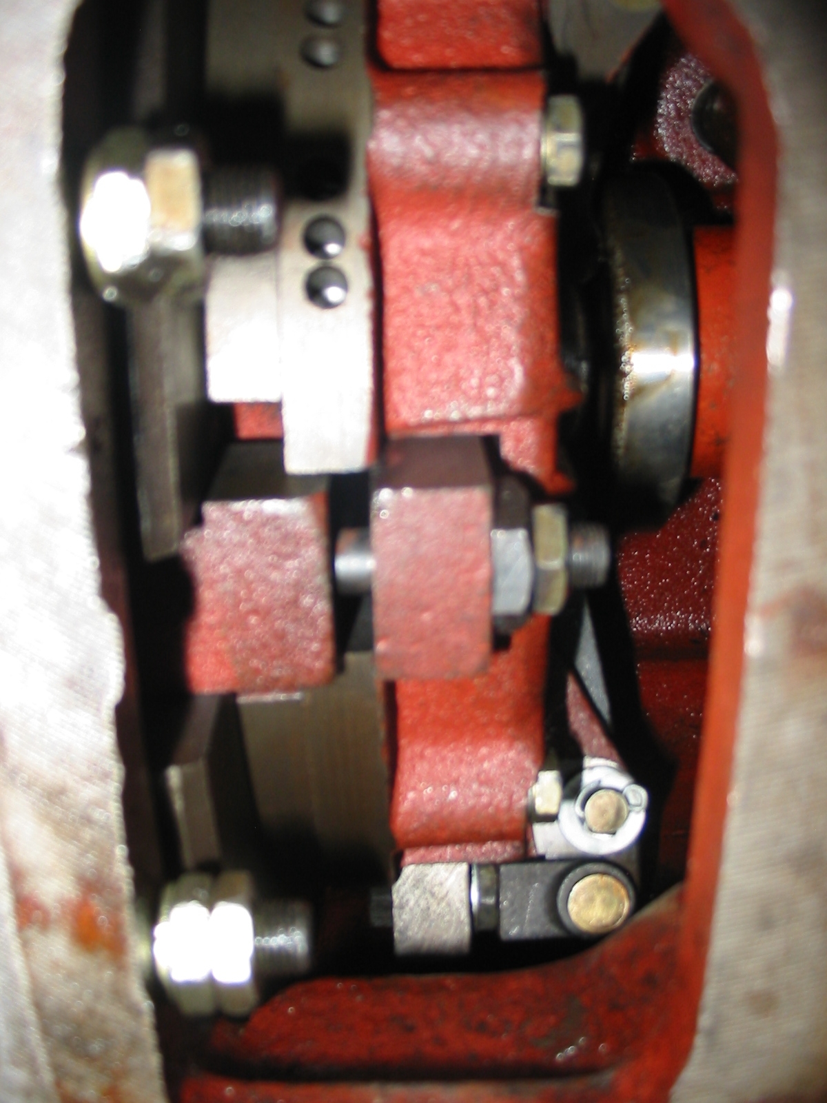

Gents,
Here's a couple of pics that are both in focus and don't have shadows across the release fingers...
I agree that there is too much thread showing on the PTO adjuster, and I can take a lot of that out, (which will of course require adjusting the mains as well to get the .030 - .040 between the adjusting nut and the pressure plate).
However, my initial concern was that I was not throwing out the PTO far enough... Clearly in this configuration that is not the case; the PTO is no doubt getting thrown out too far if there is such a thing.
Which brings me full circle to where I started... Why do the PTO gears continue to turn when the clutch is depressed. Assume that I do indeed have the fingers slightly off of the .1mm difference that is allowed. I will concede that is quite possible. Right now, the PTO pressure plate is being pulled back so far that it's hard for me to believe there is anything that could still be pressing the PTO driven plate into the flywheel.
Sorry if I sound obstinate, but I really am doing the best that I can to describe the scenario and what I see. Feel free to point out the error of my ways... I just want to get the PTO to stop grinding.
Thanks,
Nate
Yes. The adjustments you made have over-compensated the main drive clutch at the expense of the aux (PTO) clutch. Not only should those fingers not "wiggle", they should actually be too stiff to depress by hand. As a result, that clutch is too loose - so it stands to reason that the other one is too tight.
It's a stack height thing, which is nearly impossible to accurately obtain without splitting the tractor. Short of that, it's a hit and miss thing. It appears that the PTO adjustments need to be loosened to obtain the prescribed 1.2mm gap, then the fingers adjusted well past the point where you can move them by hand. #6 in the diagram adjusts the PTO clutch. I think yours are way too tight, you should be able to see a little bit of the spring underneath. In the end, each of those three #6 nuts should have a 1.2mm gap between it and the pressure plate tab.
Then move back to the release fingers. They have to be tightened. If you had the tractor split, it would be possible to adjust them to obtain the spec'd 96.8mm stack height. But since that's not possible through the window, you'll just have to tighten them by guess and by gosh. But for sure, the should NOT wiggle to the touch. Then after once again getting them all to within the spec'd 0.1mm of each other, adjust the external linkage (#13) to bring the TOB face to within the prescribed 2.5mm. At the end, a little adjustment of the stop bolt (#11) may be required as well.
Like I said, trying to return to somewhere near the prescribed stack height - through the inspection window - is hit and miss at best. So you may have to repeat the above more than once before you obtain satisfactory results.
//greg//
