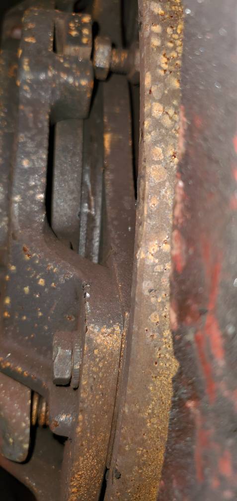

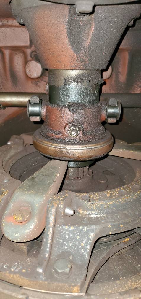

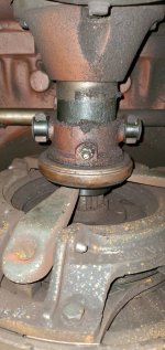

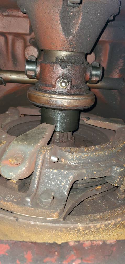

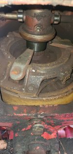

Clutch fork moves as it should. Looks like the clutch is just stuck. I tapped on it quite a bit with a 2lb hammer and bumped it around so I could tap in various locations abut it didn't give up. Any ideas on how to get it to release? Really dont want to split it if I don't HAVE to 20200928_172558.jpg20200928_172606.jpg20200928_172612.jpg20200928_172621.jpg
   / Clutch issue #7
it's stuck allright. Ever bother to grease the throwout bearing? Don't look like it and it's rusty in there too. Only way I know of to unstick a stuck clutch disc without splitting a tractor is find a stout tree and chain it to the drawbar with some slack in the chain, put it in a higher gear than 1st, gas it and when it gets to the end of the slack, it will break loose (clutch pedal depressed of course). Either it breaks loose or it breaks the chain or uproots the tree.
   / Clutch issue
Haven't had this tractor very long at all, so no, I myself have not greased it. I tried the stabbing the breaks while rolling etc but didn't try chaining it to a tree though.........
Might not have much of a choice
   / Clutch issue #9
Brakes won't do it. You need a sudden and hard stop. Just make sure the pedal is pushed in all the way (for obvious reasons).
Don't look like it was ever greased.
   / Clutch issue
Well since it has the gap now im gonna grease the **** out of everything on the chance it does pop loose. In the time I've had it I've pushed alot of dirt/rock, pulled stumps etc and the clutch has never slipped. Never really had a problem till this
