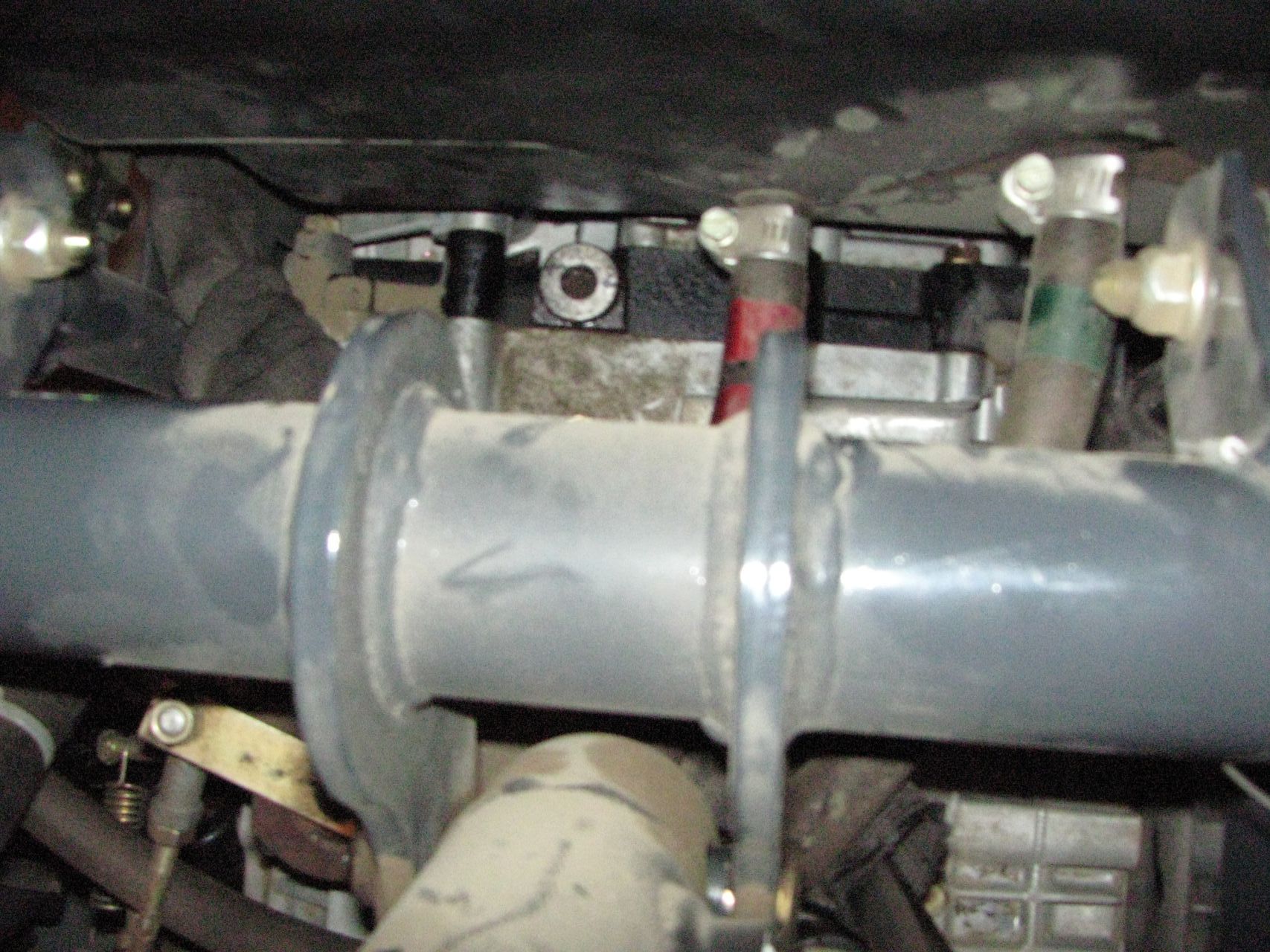

Wayne, can you post a pic of the stock valve location please.
Oh, and where did you hear we could adjust the stock valve? was it in this forum or another?

Nobody on the other forums really talked about adjusting the OEM valve, but I have "heard" that some dealers would do it. After looking at it for a few minutes, it was clear that the allen screw locks in the spring tension, so all you have to do is loosen that, and then unscrew the flat head screw, which in turn relieves tension on the spring.
The plug which covers this is removed with a 10 mm allen wrench. The pictures I took are looking down. If you have a 10 mm allen that works with a 3/8" socket, life will be easier. But after you take the plug out, use a magnetic pick up too to remove a spring, and then use the magnetic pick up tool to take the valve out. I can do it now in less than five minutes, for me the hardest part was locating the 10 mm plug. But, there is only one 10 mm plug on the back half of the transmission, and it is very close to the hydraulic oil tank on my 900. I hope these pictures work!

Guys, this adjustment is what my RTV has needed all along... I reduced the spring tension on the valve three and a half turns and it works great.. There is very little engine braking now. Just enough to slow the machine down gracefully. This also makes backing up a breeze. No more whiplash! Awesome!.. I can see that this valve set to the factory setting provides for engine braking downhill, but I live in an area that is very flat.. No need for it.. This valve adjustment is a no brainer. Tip: Use a piece of 3/4 inch PVC to slip the valve in and clamp with a vice. this will prevent dents or scratches to the smooth areas of the valve and hold it tight when making adjustment to the spring tension. This valve has to slide up and down for the check valve function and is held in place by a very light spring.. any scratches or indents in the valve body will cause it to fail. Be careful and don't drop it..
