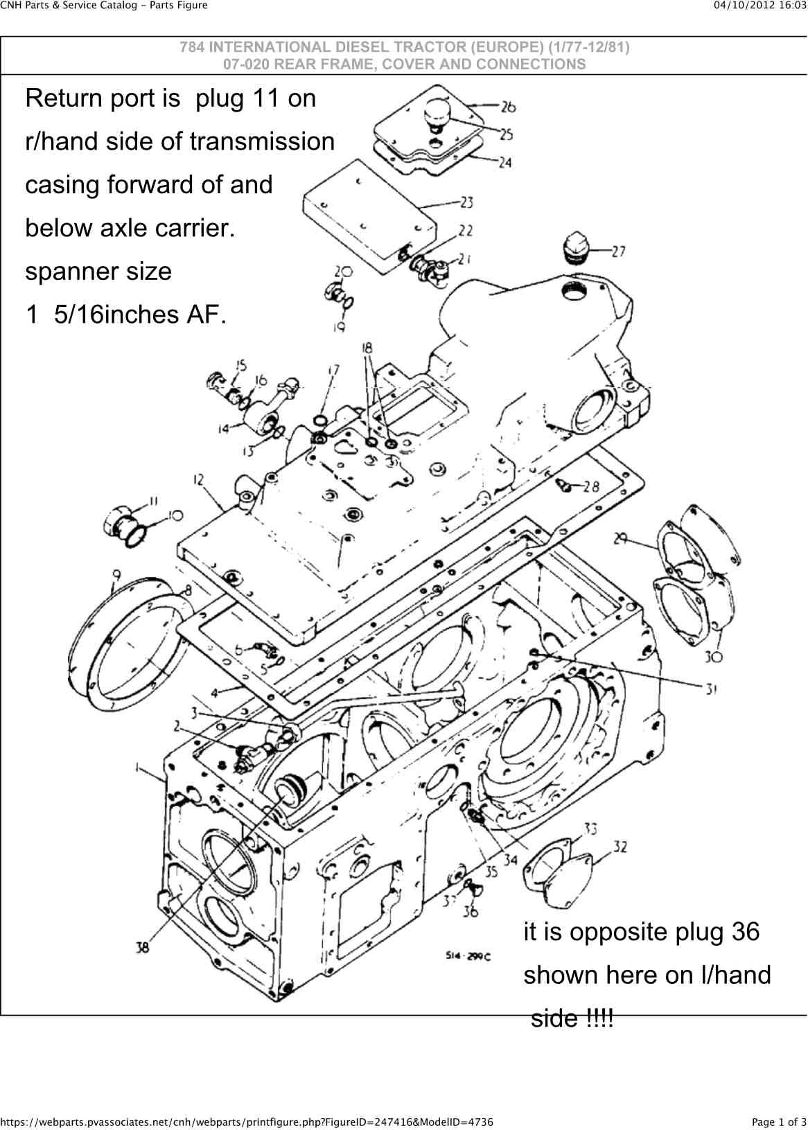

"Gator dog' I think you miss-understood. by 2 or 3 line i am refering to what the loader valve bank requires, bit what is on the tractor ????
First att shows auxiliary valve layout including end plate which will be replaced by the HPCO. (Picture actually shows HPCO but part no's listed are for a blank end plate.??
For correct part no's refer to 2nd att
3rd att shows large plug under axle on r/hand side to be used as return port, The size is 1 5/16inches UNF thread size not spanner size ?????? Due to size of this plug most people remove it then have a local m/c shop bore it and tap it to suit local adaptors, ideally 3/4 bsp or 1 inch JIC

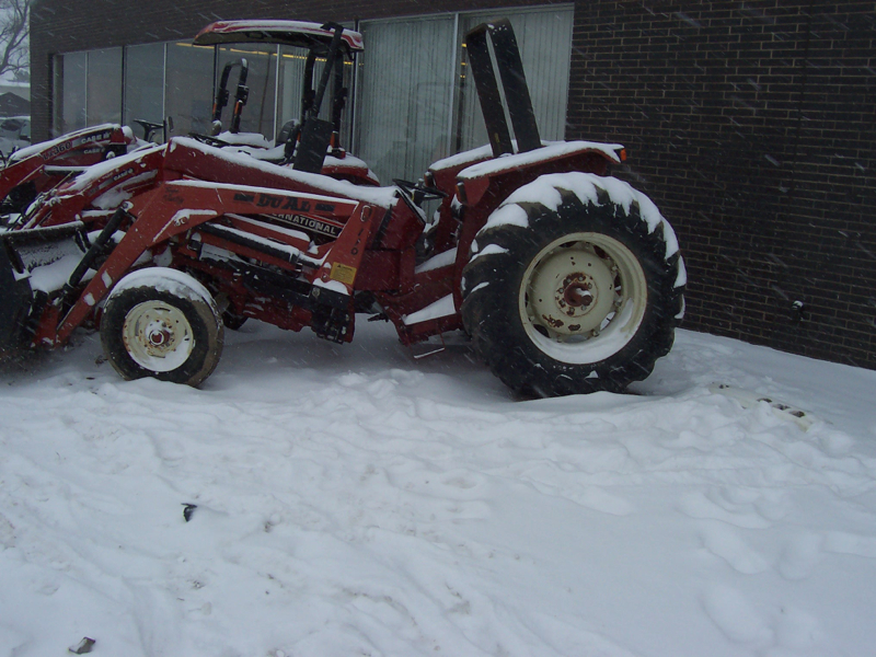

Makes sense. OP: These are great tractors and you will love it. I have had my 684 for years without any problems and I have a Case IH 885 which is practically the same tractor that has over 9000 hours and the only thing that has been done to it is new sleeve o-rings and a head gasket.
This is what my 684 looked like when I bought it. The picture makes I look like it needed more work than it did.
