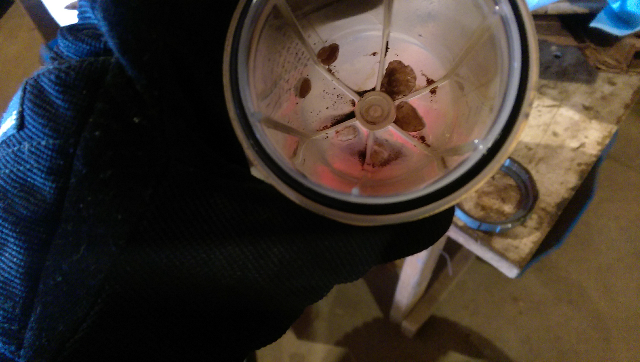

Well, had a chance to change the filter today. There was some "gunky ice" chunks in the bowl. Cleaned it out, put it back on with a new filter, turned the ignition on (activating fuel pump) ... Fuel bowl filled right back up. Tried to start her, and same thing, no fuel getting to the injectors. I didn't need to start it today so I didn't bother heating it up to start it. But, that tells me that it is freezing somewhere after the fuel filter.

Ya,and some dirt.
I'd be thinking about getting my fuel from a different source.

If it was mine, I'd be wondering what it looked like if you took that new fuel filter off. I'd also cut the old filter apart to get an idea what it looked like inside.

I would try cracking open an injector line above the injector and see if cranking the engine delivers any fuel to the line/injector fitting. If not, when you've warmed up the IP and rest of the fuel area to a temp where fuel should be delivered to the injectors, without being hampered by a freezing condition, then there may be sediment or other foreign material that is blocking flow at the IP from reaching the injectors. If you're getting flow of fuel at the 'cracked' line fitting, but still no start, it's possible the injector nozzles are jammed with junk that past by the filter, IF it was completely plugged when you changed it. So cut open the filter, inspect it, and post back results.:thumbsup:
