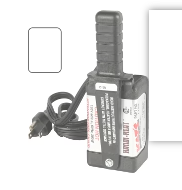

My tractor is not equipped with a built in block heater so I bought a magnetic one, I stick it right on the oil pan... it dose the trick.
