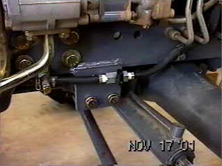

   / Cold TC45D #44
Re: My brand new TC35D...
Thanks for the part #'s. Fixed mine this morning. Haven't put the hose clamps on yet, but wanted to go ahead and post a picture. Cut off a little more hose between the drain valve and radiator to keep it close to the frame.
Thanks again.
Jeff
   / Cold TC45D #45
Exactly what mine looks like....

   / Cold TC45D #46
I have to again post how important doing something to block the flow of coolant through the drain lines is. Plug it, remove it, but do not do nothing. The engine should not be run cool. Even in warm climates, unless the tractor is worked extremely hard, the engine will not warm to "normal" temp, which is mid-range on the gauge. If your in doubt, just clamp or pinch the line from the radiator off about midway between the radiator and drain valve. Use a small c-clamp or something to pinch the hose temporarily. I guarantee that the engine, even only idleing, will raise in temp to mid-range in about ten minutes or so. If your working it, it will be even quicker. New Holland/Ford has had this problem for over 14 years, since the introduction of the xx20 series, but it's still there. Try it, you'll be amazed!

   / Cold TC45D #50
I haven't had any problems with mine.
Where exactly is the leak coming from? If it is leaking between the block and the fitting that screws into the block, then all you need do is remove the fitting, tape it with teflon tape (or other thread sealing compound) and re-install. If it's at the spring clip holding the hose on, replace it with a band clamp. The pressure on the system would fail the hose before causing damage to either of these two joints.
Steve
