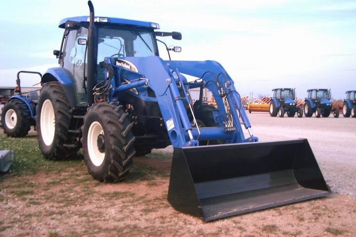

</font><font color="blue" class="small">( I cannot believe that CNH does not read this site. They should. And as they read it they should sent two posters to this sight each a new tractor for all the info that has been given to posters . They are Jinman and Soundguy.
)</font>
Woohoo! Thanks Dave! /forums/images/graemlins/grin.gif /forums/images/graemlins/grin.gif /forums/images/graemlins/grin.gif
Hey New Holland...I'll take one just like the attachment. Let me know when it's ready to pick up. /forums/images/graemlins/cool.gif
I wonder which one Soundguy will pick? /forums/images/graemlins/laugh.gif /forums/images/graemlins/laugh.gif /forums/images/graemlins/laugh.gif
